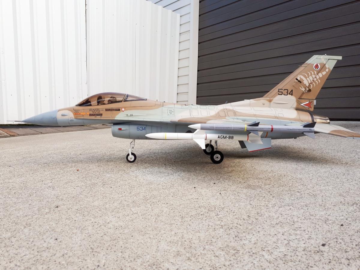

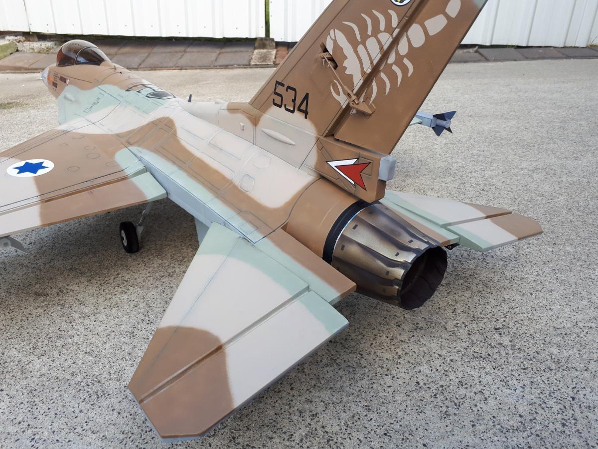

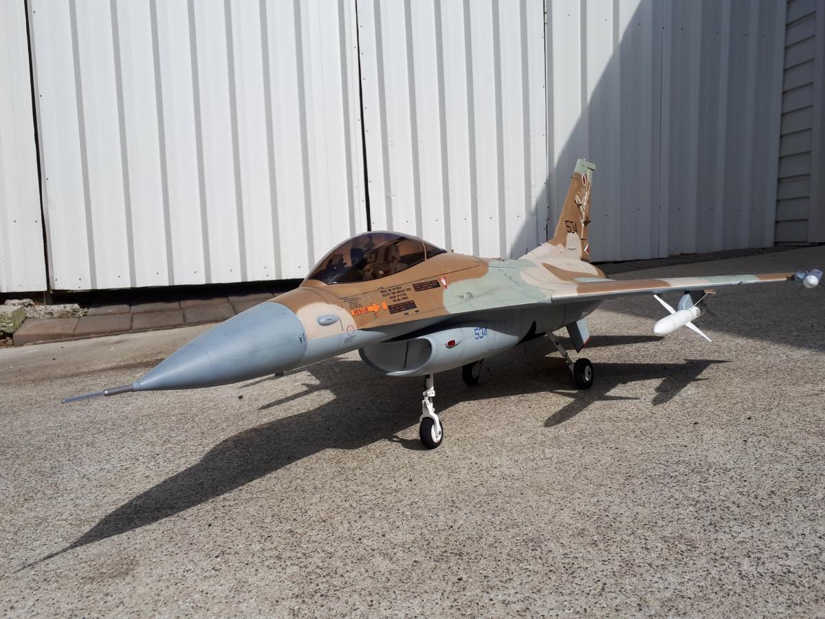

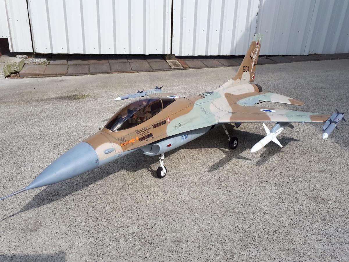

                      After a few hold ups I’m finally calling this one done! Now to save for some batteries......... Click image for larger version

                      Beetleman, What paint did you use in your airbrush for that job? I'm still new to the airbrush scene but I am learning more each day. Issue I have is when taping off the lines for patterns and stuff the paint always peels up when I pull the tape off. I've used blue painter's tape with pretty much 0 tackiness to it and still pulls up the paint. I've tried the very thin Testor's tape that I always put on pant leg several time's to get the tackiness off and same thing pulls that primer right off the foam. I've so far used testor's with a 2:1 ratio on paint to thinner and have had decent results with it. Got a few things painted up with Tamiya acrylic's as well but that stuff seems to dry up so quickly on the cup that it gets hard to keep it consistent. The testor's enamel seems to take weeks to cure which causes it's own problems.
                      • Hey Hawk4me, I’m new to airbrushing too so it’s been a bit of trial and error. Paints on this one are Vallejo Model Air paints (Israeli paint set) with a couple of drops of flow improver where needed. It was pretty good straight outta the bottle to be honest.
                        Tape was Tamiya tape put on my jeans to reduce tackiness but I had some similar problems to you, post it notes were the best as they were not very tacky at all. Camo edges were free handed as in my view, a bit of an imperfect finish is more realistic....that’s my excuse and I’m sticking to it :)
                        Have heard of people using blue tack for soft edge masking. I did have some paint pull off mainly if I just pulled the tape straight up instead of folding it 90 degrees across itself and pulling it up. Also tried some pliable 5mm tape used for auto body shop detail work but I preferred the post it notes. It’d be interesting to see how liquid mask works as the rc car community seem to use this a bit.
                        Can’t wait to get this flying! Have decided to hinge the control surfaces with CA hinges first for additional safety thanks to advice received here.
                        All the best. Kurt.
