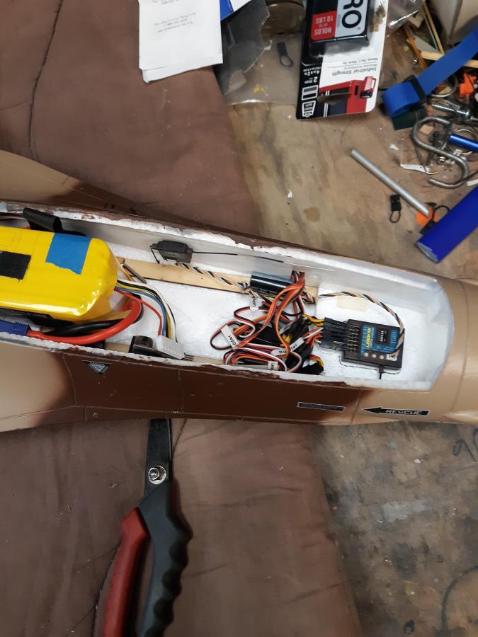

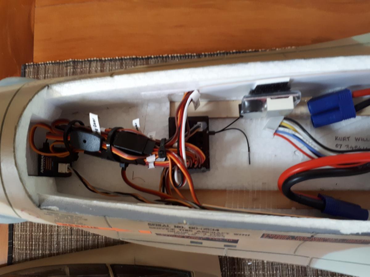

                                Hi all, need some help please. Is anyone able to please post a pic of their ‘troublefree’ receiver and satellite placement in this bird?
                                Previously when I’ve flown, the range check was ok, not 100 percent glitch free at 30m out with reduced transmitter power, but pretty darn close. I fly close by given its off a sports field anyway.
                                To try and improve things a bit, I moved my satellite before going out today and seem to have made things worse! At this point, when at at 45 degree angle or thereabouts from behind the aircraft, I can’t get a glitch free signal at any more than 25m........pretty frustrating. I made the hard but wise decision not to fly it this morning until I know it’s all sweet. I’d appreciate any pics of anyone using the same receiver and sat pictured to help shortcut the amount of shifting and retrying needed if possible. Transmitter voltage was fine and my other plane range checked fine. Receiver is Admiral 6ch with satellite. No gyro. Although it’s hard to see in the pic, the aerials are set up for correct polarity.
                                In regards to the satellite, one aerial shoots out to the right hand side and one is straight up in the air. Perhaps it’ll simply come down to a bit more testing out different receiver locations/trial and error?
                                On the plus side, we’ve had opposite problem to other parts of the globe here over the last month and a half or so with the highest temperatures seen for decades....made for some cool pics where our normally green sports field is now looking more desert like!.....and my Eflite Pitts Special 850mm got a short workout this morning instead which was fun.
                                Thanks for the help and suggestions all, much appreciated. Im sure I should be able to get better radio reception than what I’ve been getting.
                                Kurt
                                Click image for larger version  Name:	21F653D1-6B77-4292-B742-87D29E908156.jpeg Views:	2 Size:	94.2 KB ID:	179511
ID:	179528 only I use diversity sats, so it gives me 3 antennas

                                    Thanks Rcjunkey, much appreciated. I’ll swap my set up around to replicate how you’ve got it and hopefully this will resolve the issues.....itching to fly this bird again.....

                                      set-ups are basically identical except for just a few millimeters of space I would look into that receiver being weak.
                                      with power down range check I can get way past the minimum range.
