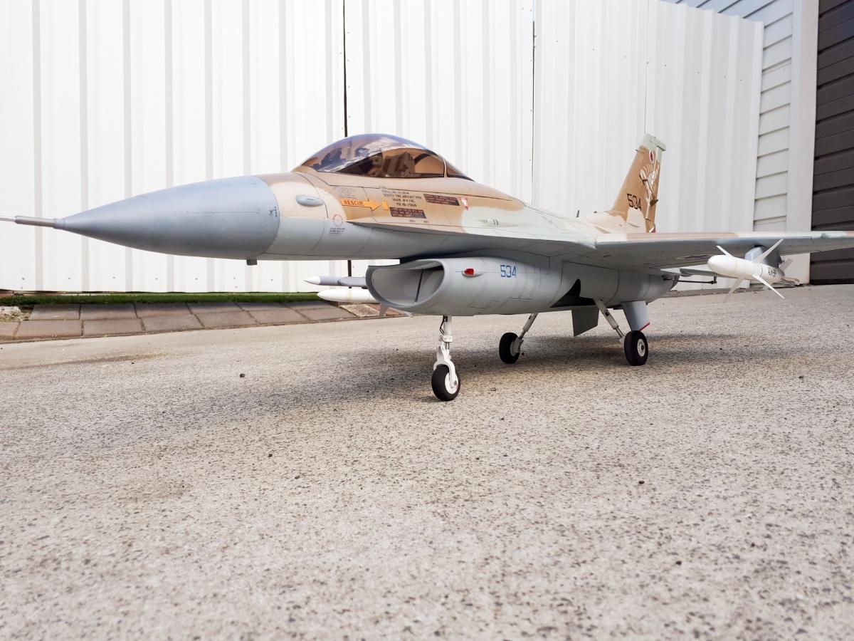

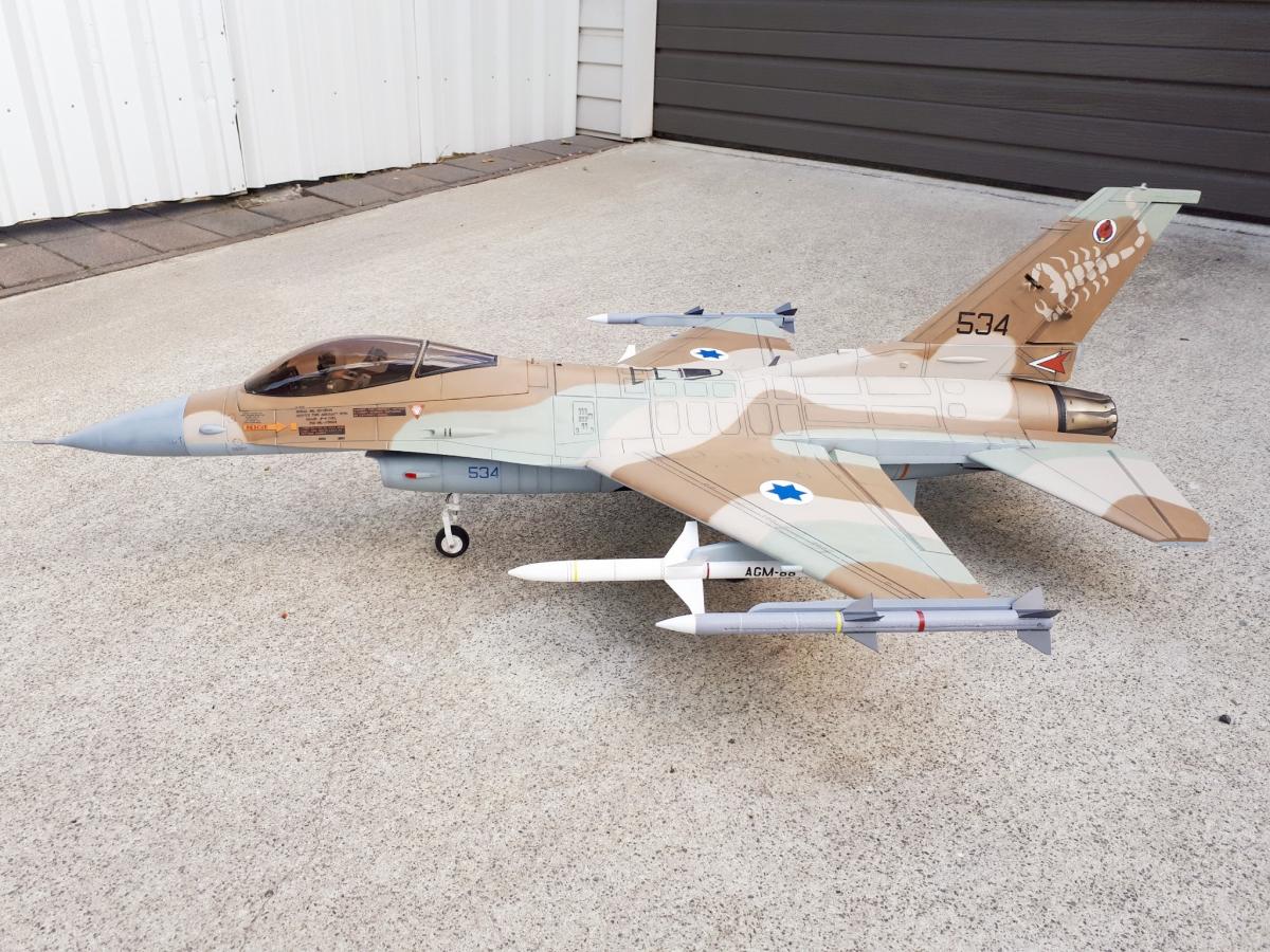

                                  After a few hold ups I’m finally calling this one done! Now to save for some batteries......... Click image for larger version

                                        What a great paint job and weathering!!! Love it!!! Jerry
