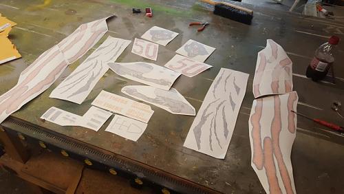

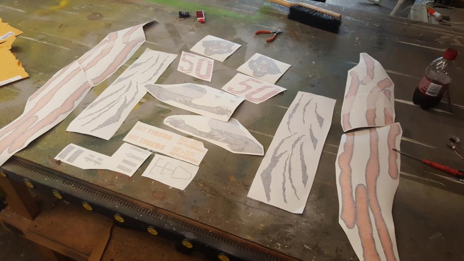

        Getting close to finishing the 6S Pro done up in Toledo Stinger livery from Callie Graphics. Really like to upgrade gear on it. Impressed with the effort put into the V2 design. Well done. I do have a question for those who are using the upgrade suspension gear of any type. Is anyone using any kind of lube to prevent metal to metal wear? Personally, I wouldn't use oil as that will collect dirt that will cause more wear. Thinking about a silicon spray. I've used that on the jackscrew in electric retracts that aren't prelubed with good success.

              Looking good, Twowingtj. I'm curious if you had any connection or affinity for the livery you chose? The struts look good, too. That should give you at least somewhat of a fighting chance on your grass when it's cut short in the Spring.

                        Alpha, no real affinity for the choice. I was just looking for options and ran across this offering at Callie. I thought the big bee on the tail would just give it a bit more attitude. I really like those upgrade struts. I don't think I'll have any problems with taking off or landing with this bird.
