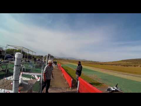

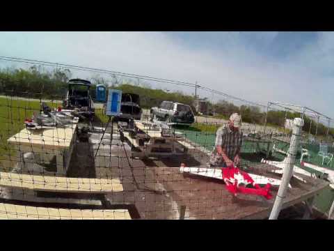

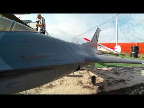

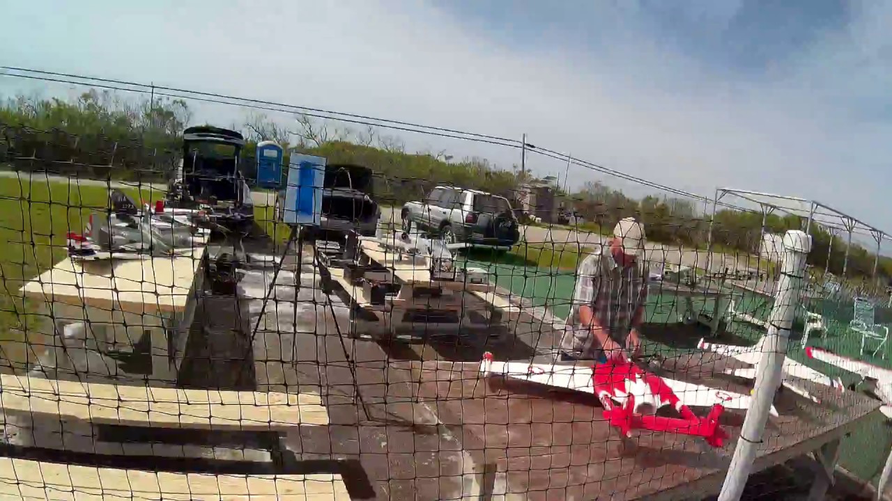

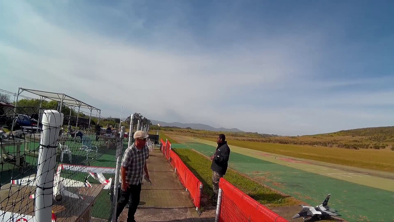

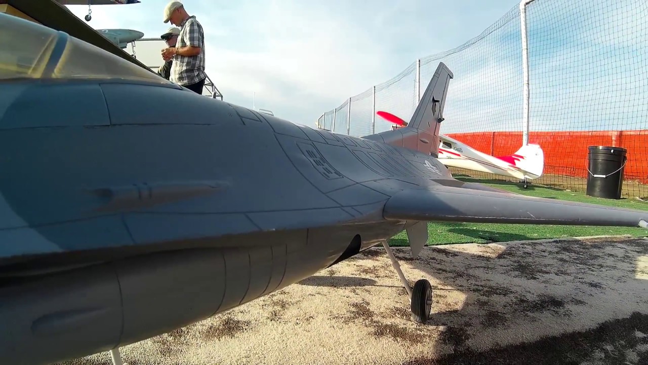

                    • I put the lemon 7ch with 3 axis gyro in the plane. Now I love it even more!! here are the flights...
                      • Nice! Yeah I plan on putting a gyro in mine. Seems like a good candidate.
