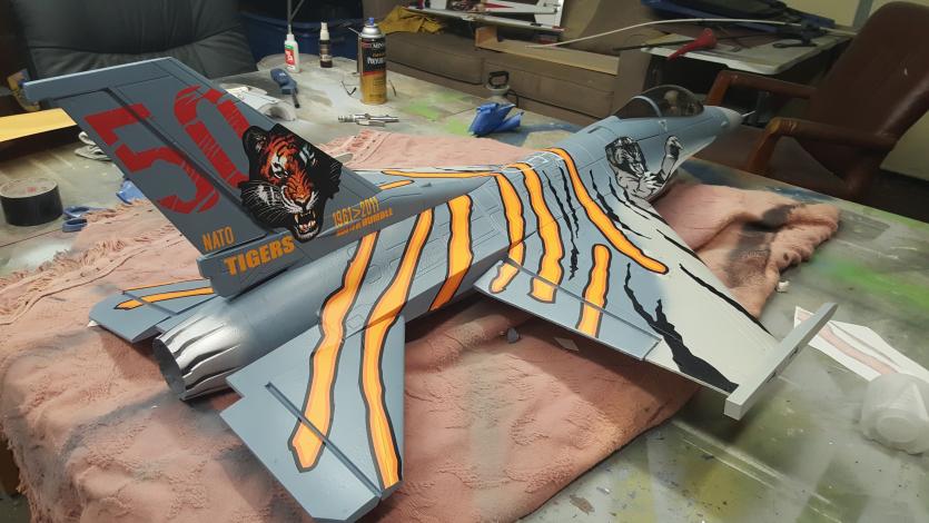

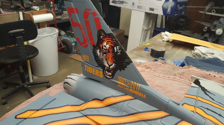

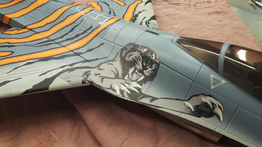

ID:	60261 I got the paint and decals done last night. I will get her re-assembled tonight, and ready for a Wednesday afternoon maiden!!

        Looks great, just saw it on FB this morning.

          Excellent paint job and decals. That is one of my ALL TIME favorite paint schemes on the F-16.

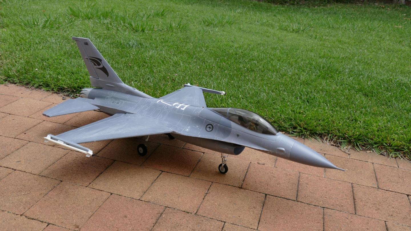

                                    Ready for the maiden. Although the RAAF never bought any F16s, I have dressed this one as a RAAF bird with a "stooping" falcon on the tail. I'll post some vid when it goes after some prey. Click image for larger version

                                      That's a really slick tail flash, tezact. Is that WBPU on the aircraft and sanded down?

                                        Yeah, I cover all my foamies in 1/2 oz fibreglass cloth and then fill with WBPU. It adds hardly any weight and helps protect against minor incidents and hangar rash. I don't bother to sand it down as I like the rough weathered effect
