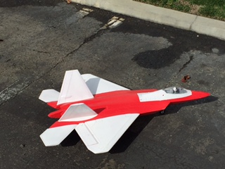

                      RE: Freewing F-22 4S
                      Do you have a picture of your "Swiss F-22", Nick? I've never seen one in red and white colors, I'm sure visibility is great for you!
                      • Nick1956
                        Nick
                        • Jan 2015
                        • 67
                        Here is a picture of my new color scheme.
                          Looks neat, easily visible in the sky, I'm sure! I wonder if these Swiss decals would fit. Probably a little on the larger side, but they might complete the Swiss look nicely:
                          http://www.motionrc.com/freewing-80mm-f-5e-decal-sheet-swiss/
                          • jordan1387
                            • 47
                            • Iowa
                            Looks good!
                            • Nick1956
                              Nick
                              • Jan 2015
                              • 67
                              Thanks Alpha
                              They will be perfect
