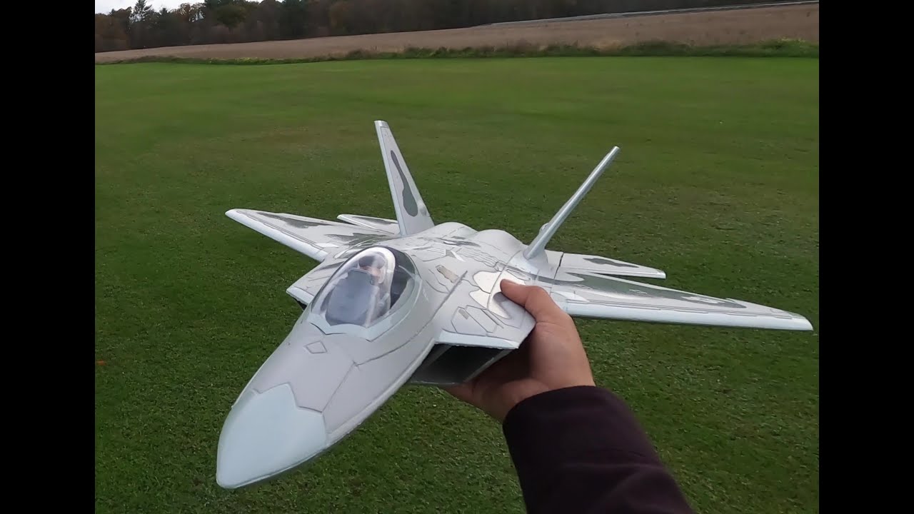

    F22 64mm is my first edf. Mine is 3s version. I removed the landing gears and added a hobbyeagle gyro. I only use 100% throttle for hand launch then use 50% throttle for cruise about 4 minutes with 3s 2200mAh batery.

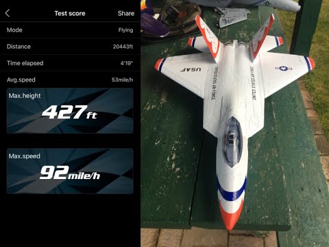

          Hello guys first post on here, pretty new to RC flying only been doing it a couple of months but def hooked on the EDFs. Here is my maiden of the "High Performance" version https://youtu.be/nPRA9d_5KQg then I had to upgrade the EDF since it was pretty lethargic. Went with the Xfly 3200kv and its def a whole different bird https://youtu.be/SKihdK8EqKI def recommend this upgrade.

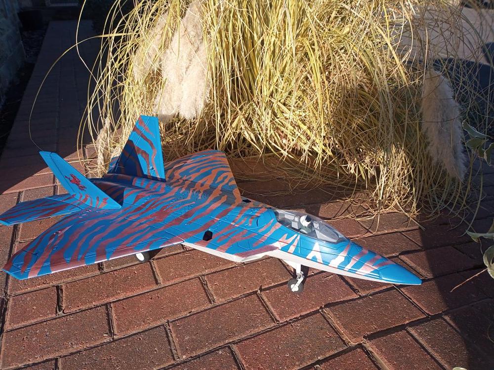

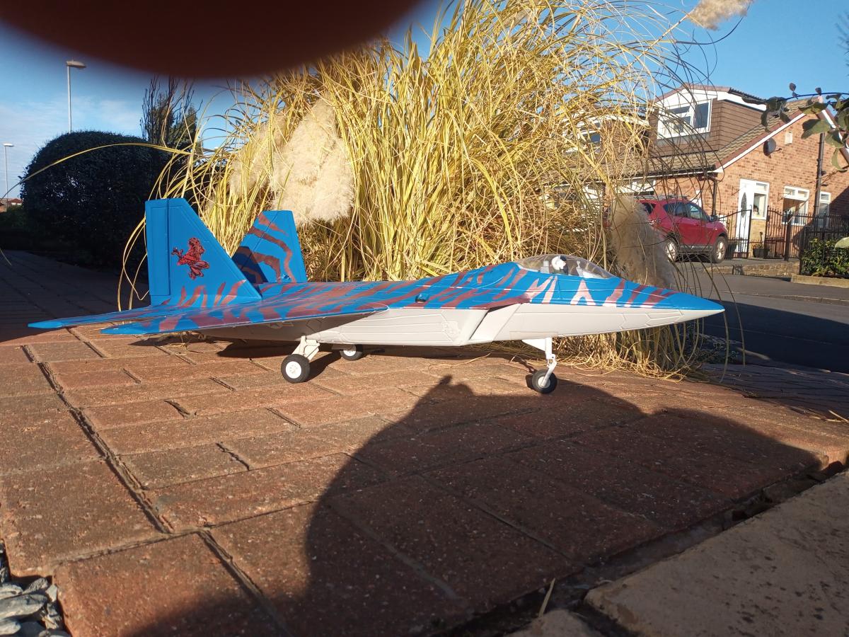

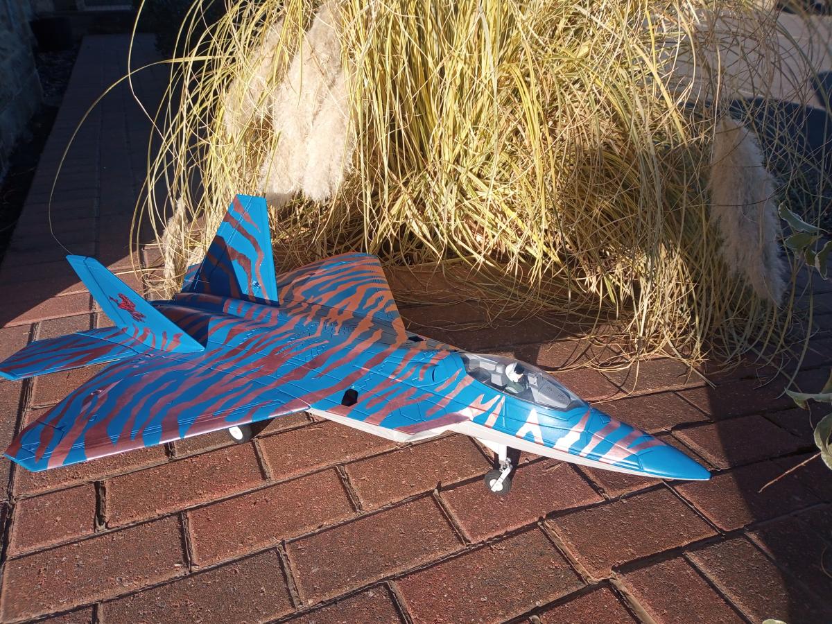

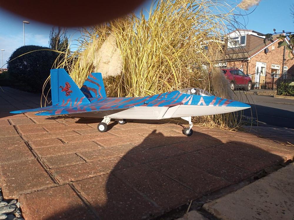

            My Freewing 64mm F22, Blue Raptor Metallica with following modifications :-
            FMS 70mm 2.25Kg static thrust 12 blade edf unit, sprung nosewheel, working rudders, lipo air intakes to rear of pilot The copper is peel and stick A4 sheets. I drew a full size scheme on tracing paper then cut through the paper and copper film in one go before applying to the mid blue paint. all up take off weight incl 6s lipo is 1.26kg, so it should get off our grass field ok

              Naveda08 Hey Angel, Welcome to Hobby Squawk. I thought that field looked familiar LOL. Nice work on the upgrade. Tony
              paulrkytek Looks sweet!

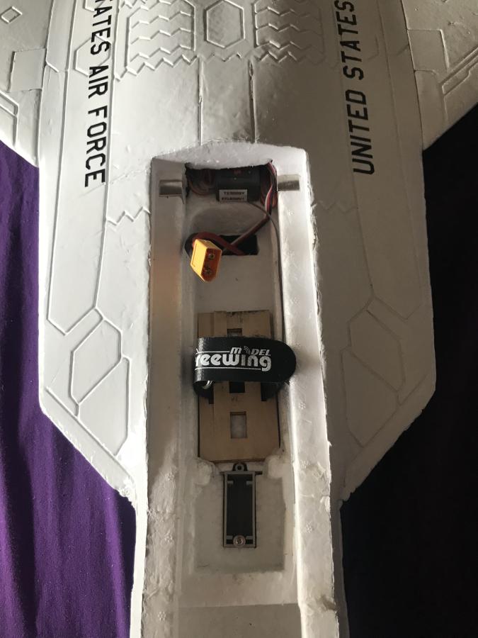

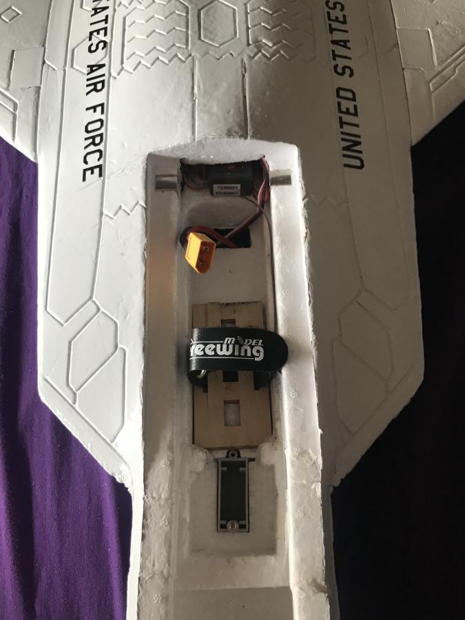

                                I did remove the nose gear servo and installed my RX in the middle to keep as much weight off the nose as possible

                                  #76
                                  Originally posted by Naveda08
Name:	image0 (22).jpeg
                                  Thanks, that all makes sense, my main field is a bit tight and about 200 metres is the limit so in this case I need the power to get off the grass but do not have the space to go really fast and stay in bounds so I tend to fly more high alpha than high speed and try to keep the cg more neutral

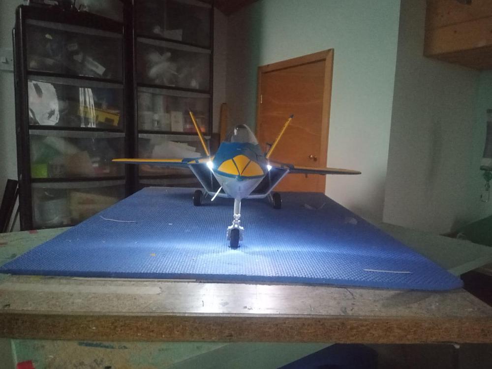

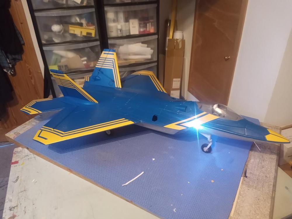

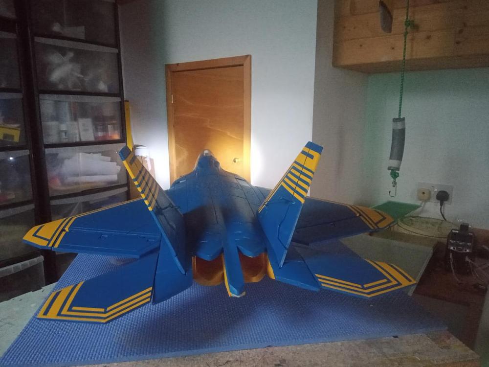

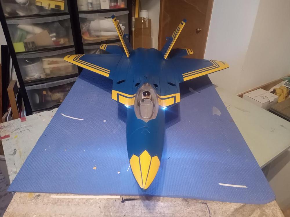

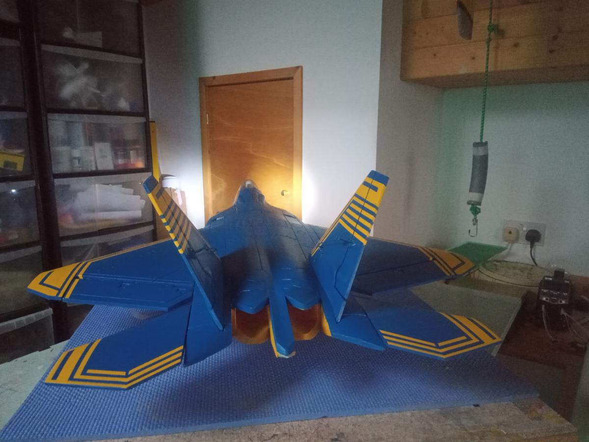

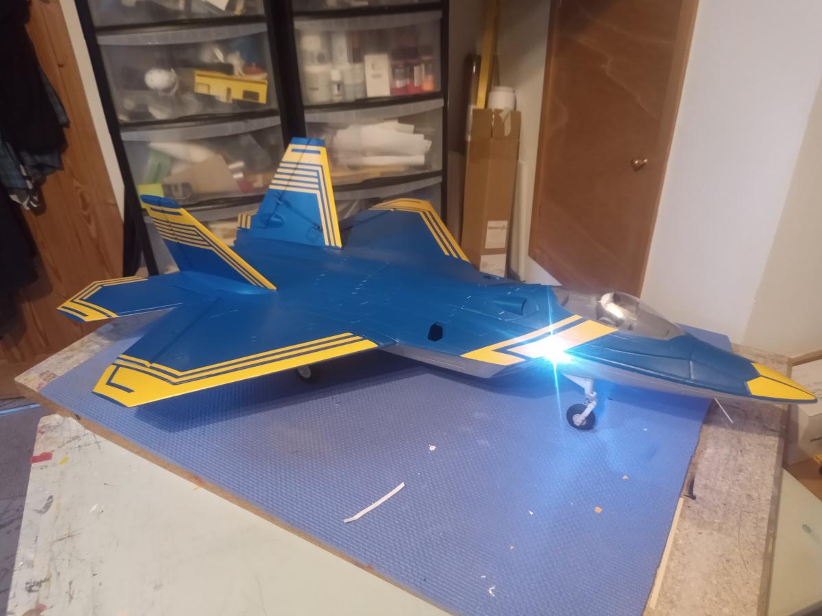

                                      Change of colour scheme and lights added to aid visibility and orientation using 6volt leds fed off spare rx channel.
Name:	Raptor lights one.jpg
Name:	Raptor lights two.jpg
Name:	Raptor lights three.jpg
Name:	Raptor lights four.jpg
