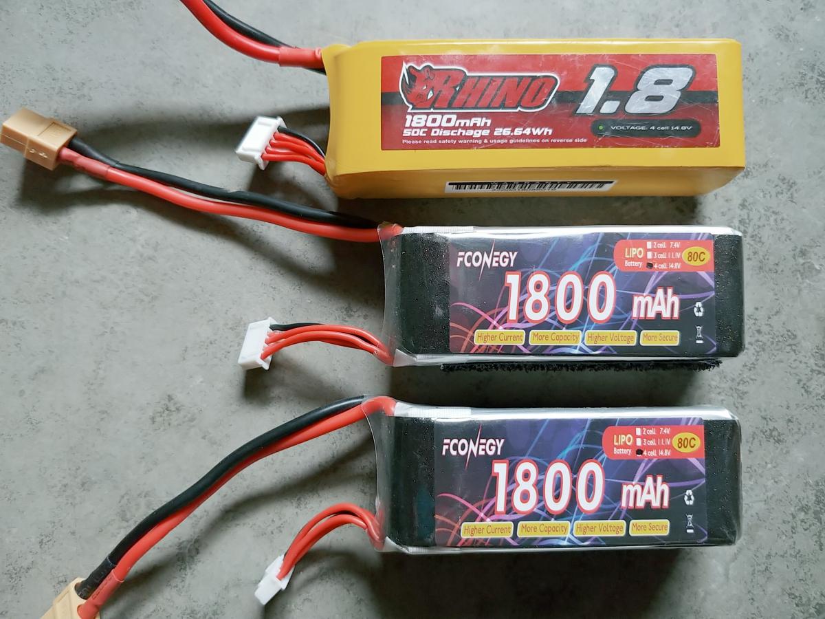

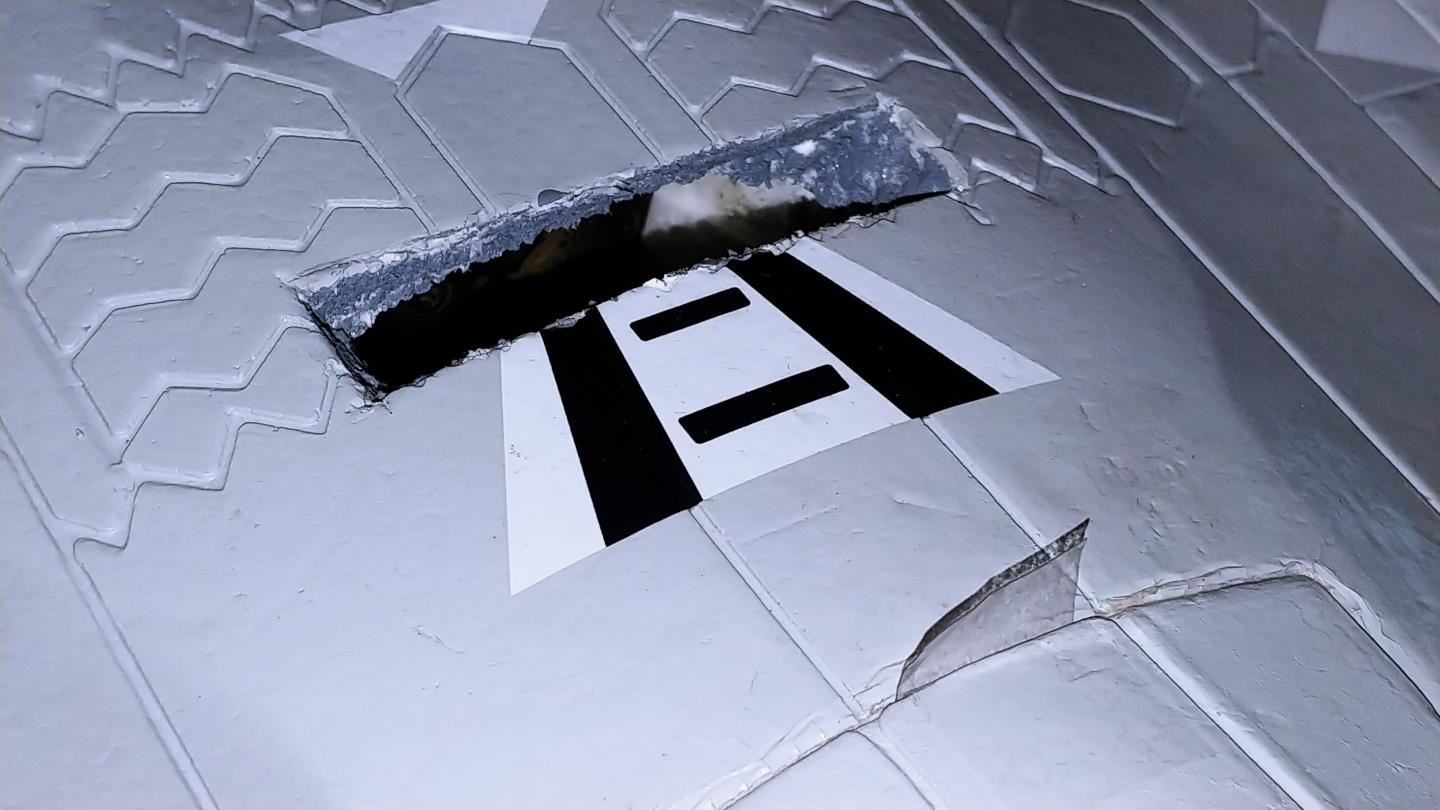

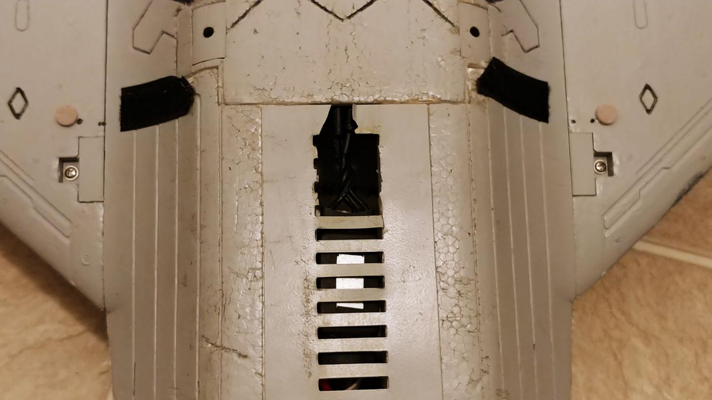

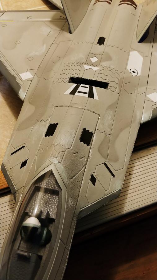

                  I fly mine hand launching it, luckily I am ambidexteous, but more dominant left hand.
                  I prefer to fly it on Rhino 1800mah 4S, no landing gear, elevator must be a few degrees offset per the manual, and make a cheater hole behind the canopy, in front of the fan, top of the fuselage. It will have the punch needed to take off. It likes to fly a little tail heavy, slightly, if anything trim on flight and readjust battery. Disregard the broke grill, that was me tinkering with the ESC and broke some of the vent sticks, barely get any grass as long as I kill the motor quick before it lands.
                  Make sure to get those kitchen cabinet mats, a roll of 8ft is about 10 dollars. Or get the one from Doar Tree and wrap around battery and secure w rubber band.
                  Choose a 5-7mph wind day, no wind is not good for this jet. When bringing it back have some juice left as it floats and WILL overshoot. Keep it 10% throttle, high rates on elevator and let go off it as soon its going to hit the deck or else it will keep the tips of the elevator. High rates to take off for aileron and elevator, and only for elevator to land.
                  Will take a few pics of the cheater hole, flies well.
