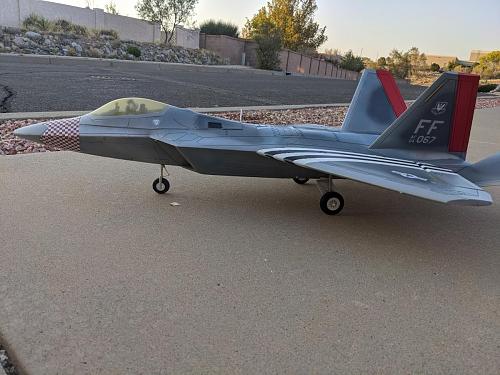

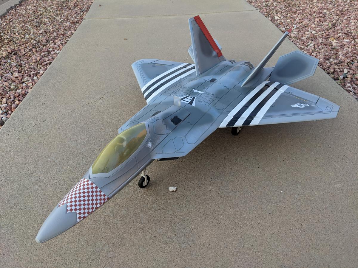

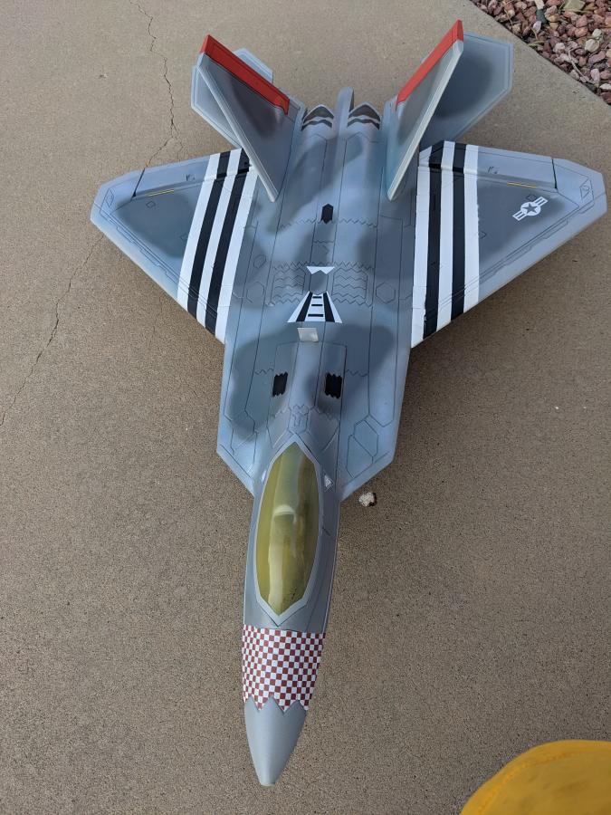

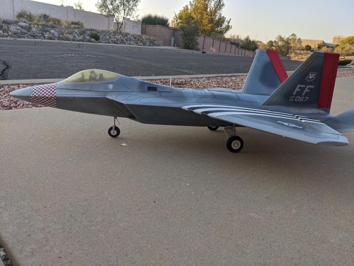

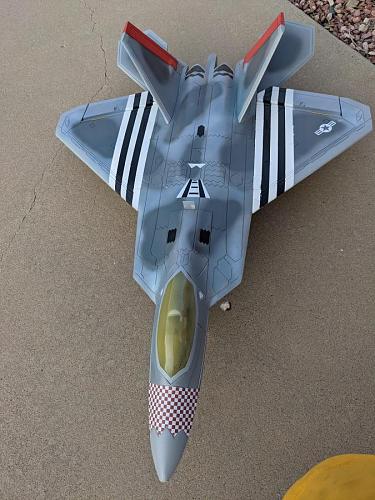

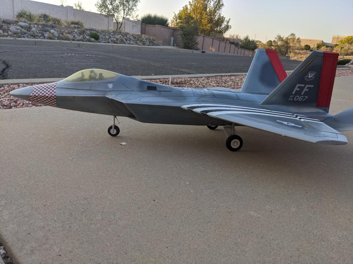

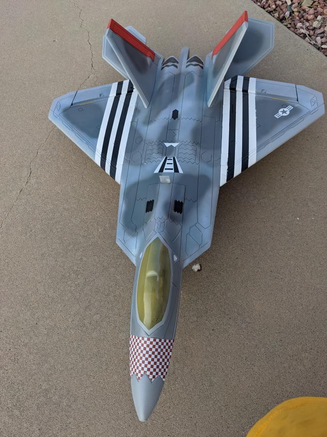

                        I just got through repainting mine to more accurate scale colors. I'm pretty sure I made it harder to see.
                        Anyway, even though there are no colorful schemes, I'm seriously considering copying design elements from the heritage strike eagles. Invasion stripes and checkerboard nose...

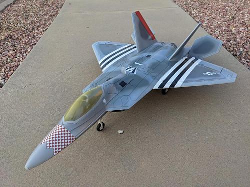

                            They can make a baby
ID:	279203Click image for larger version

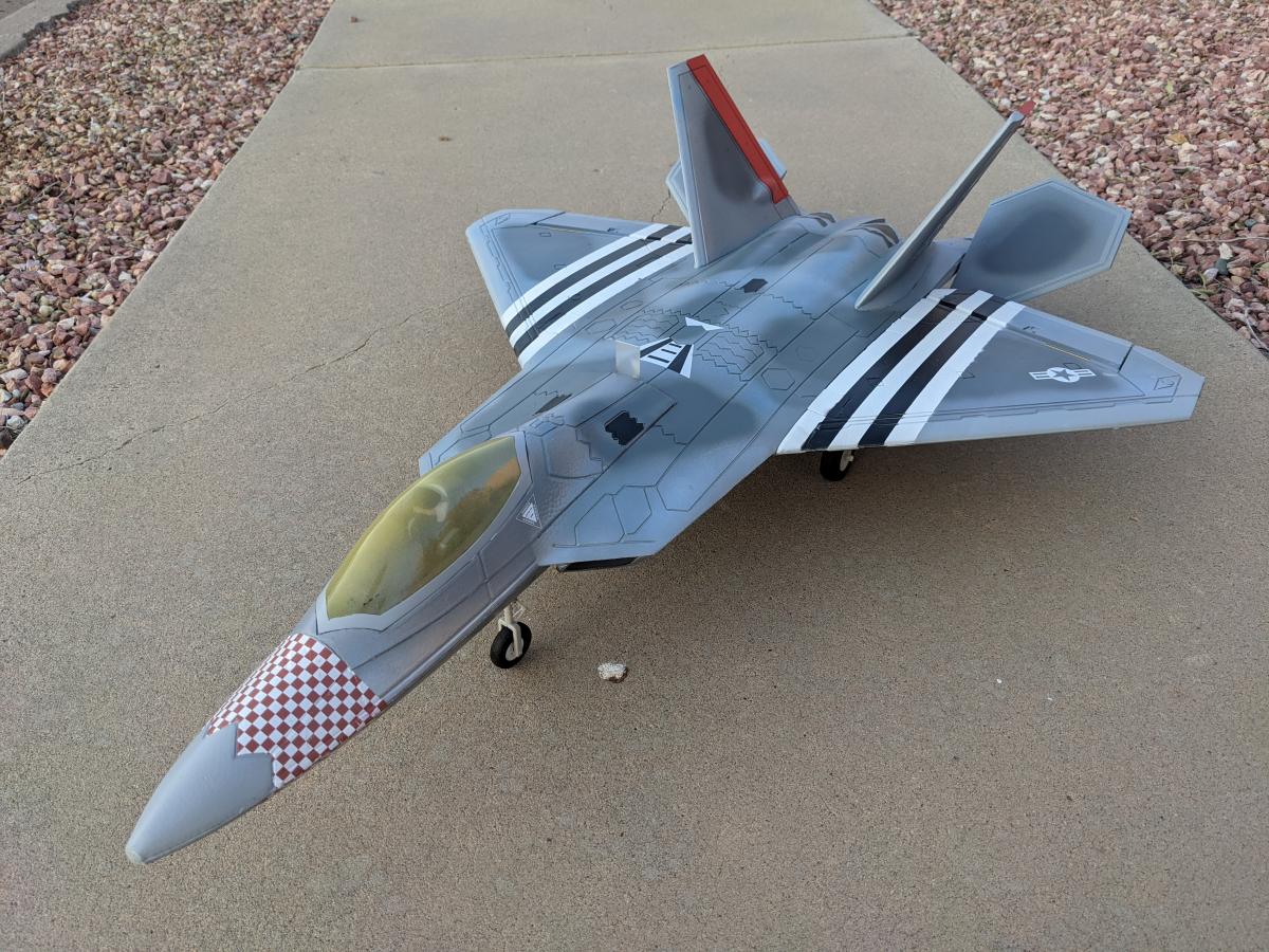

                            I didn't care for the original color, and I guess I got a little carried away.
                            Decals are a mix of custom waterslides and original freewing decals.

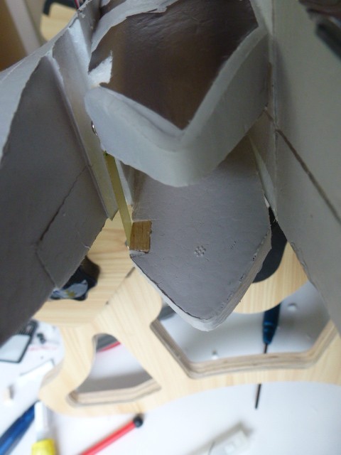

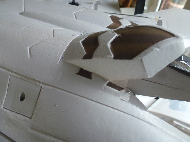

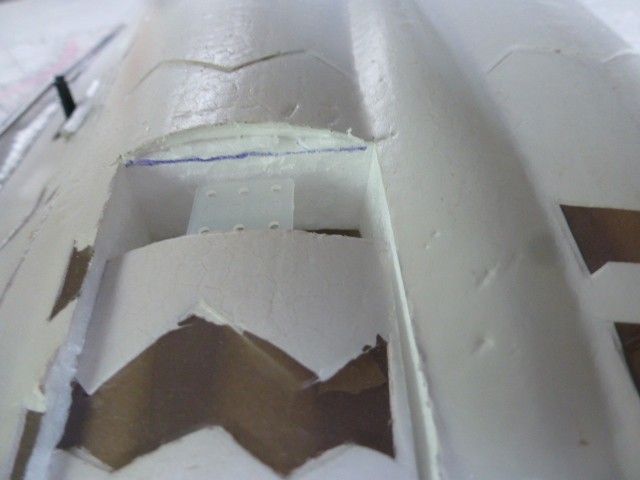

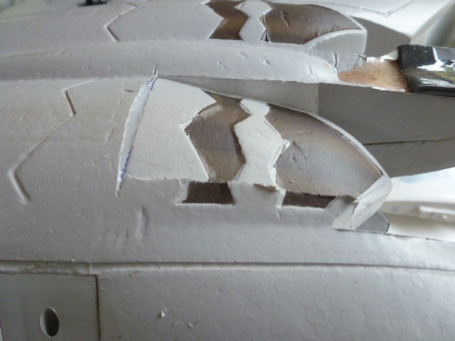

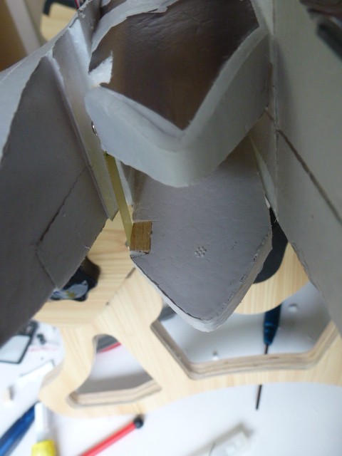

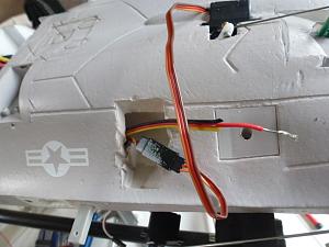

                                    A couple of months ago, I was able to obtain a second-hand F22 for a very small price. The guy that I bought it from, upgraded it to 4S with some 5-blade EDF unit. I was a bit apprehensive about it being a "screamer", but I shouldn't have.
                                    The first flight was a bit disappointing, as it barely flew at full throttle. I quickly discovered that I had used a 3S battery instead of a 4S, and when that was corrected, it flew like a dream.
                                    I installed an S8R receiver with gyro, just to be able to hand launch it without worries. It launches so easily now, I can just use both hands to throw it.
                                    But somehow I was missing thrust vectoring, I'm a real sucker for TV.
                                    I knew there was a 3D print kit for the 90mm version, and I first thought about scaling it for this model. But it just looked like overkill to me. And so I decided to just go ahead and start cutting.

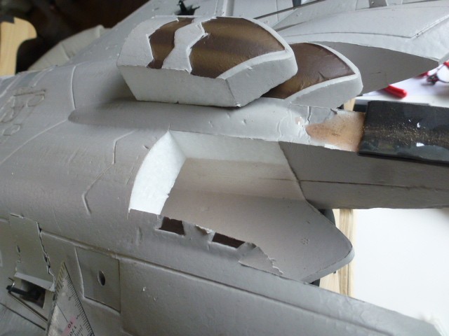

                                    I cut about 5cm into the duct, so that I have a decent deflection surface.
                                    Shaping the contact/hinging surfaces, I can reach enough deflection to mu liking:

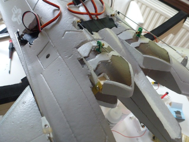

                                    I drew the hinge line, then cur away some material to allow for better movement of the aft part.

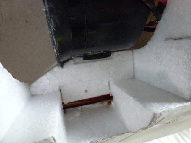

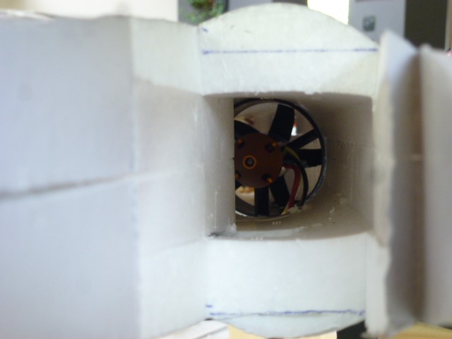

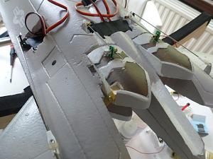

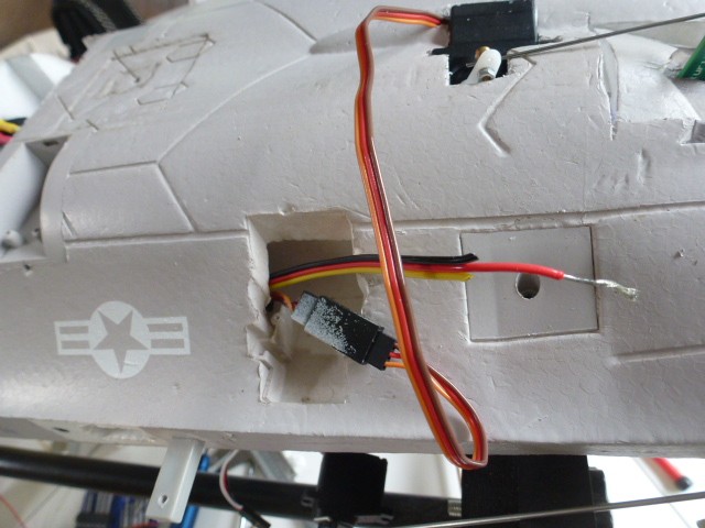

                                    The worst part of the operation was to guide the extra servo wires through the existing wire channels for elevator and aileron. There is nothing straight in these channels, it took a pull wire and tons of patience to get the wires through.

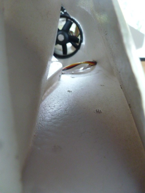

                                    To give you an idea: this is how narrow that channel is abeam the EDF unit; I had to remove the wooden supports for the EDF to get access: (seen from the top)
                                    The only problem remaining is to sink the wires into the front of the inlet duct:
                                    Another detail is that the hinge line on the top part isn't really parallel to the top skin:

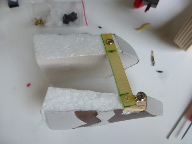

                                    I then connected top and bottom nozzle part through an expoxy strip, screwed to a small woorden support block, which is then glued to the foam of the nozzle:
                                    With the servos in place and all hinges glued in, it is really coming alive now.
                                    I will be mixing tailerons on the nozzles, some more fine tuning, and then the wait is on for better weather (strong wind and rain here now) to try it out.
                                    For the first launch, I will disable the TV first, then give it a try at a couple of mistakes high.
