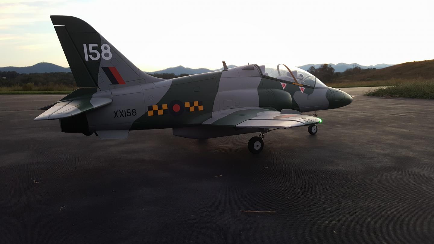

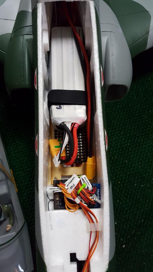

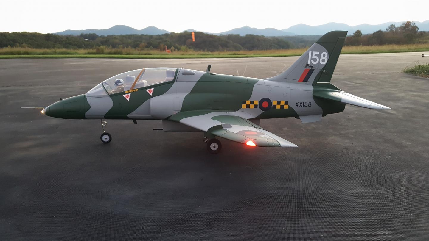

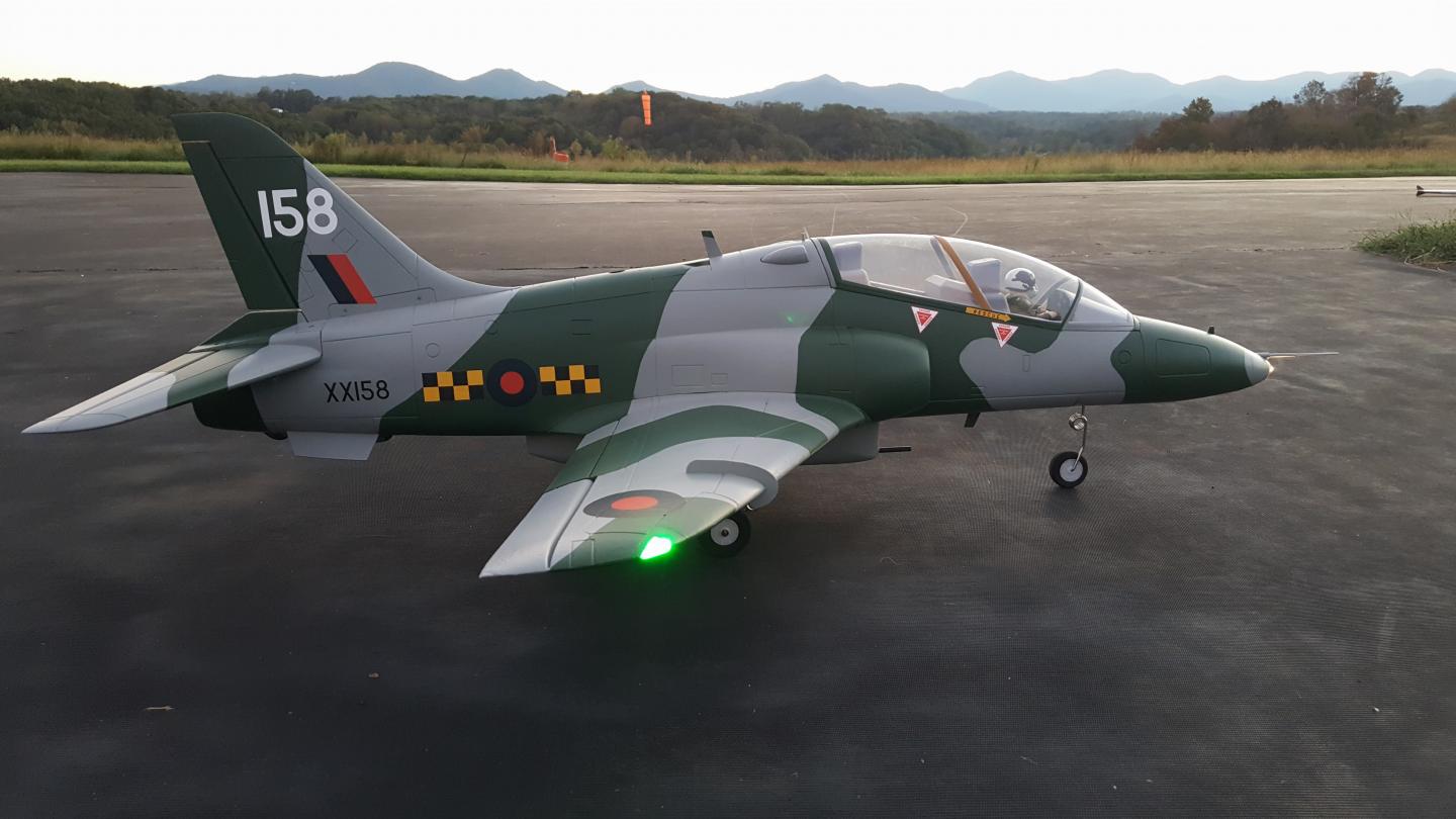

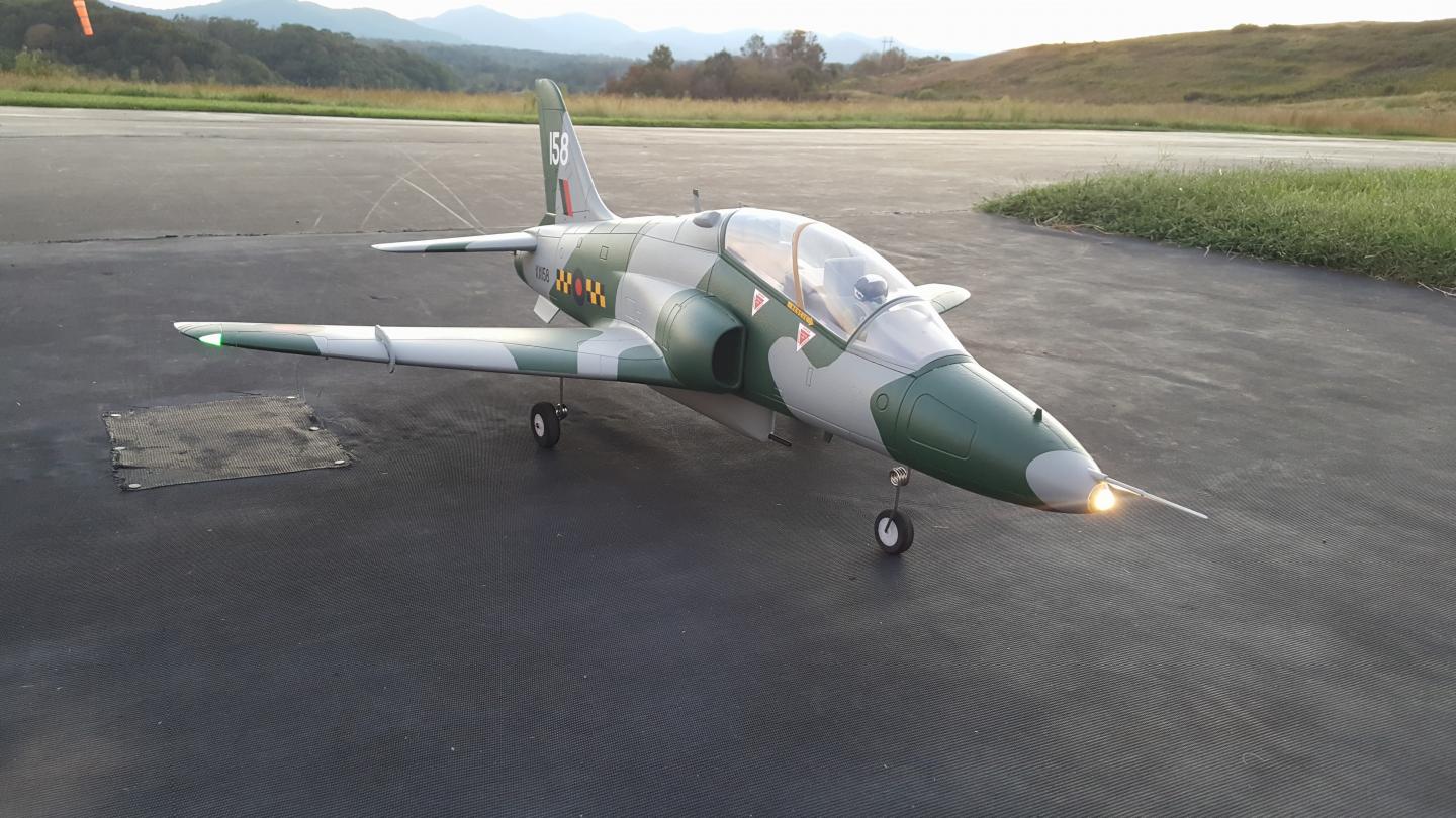

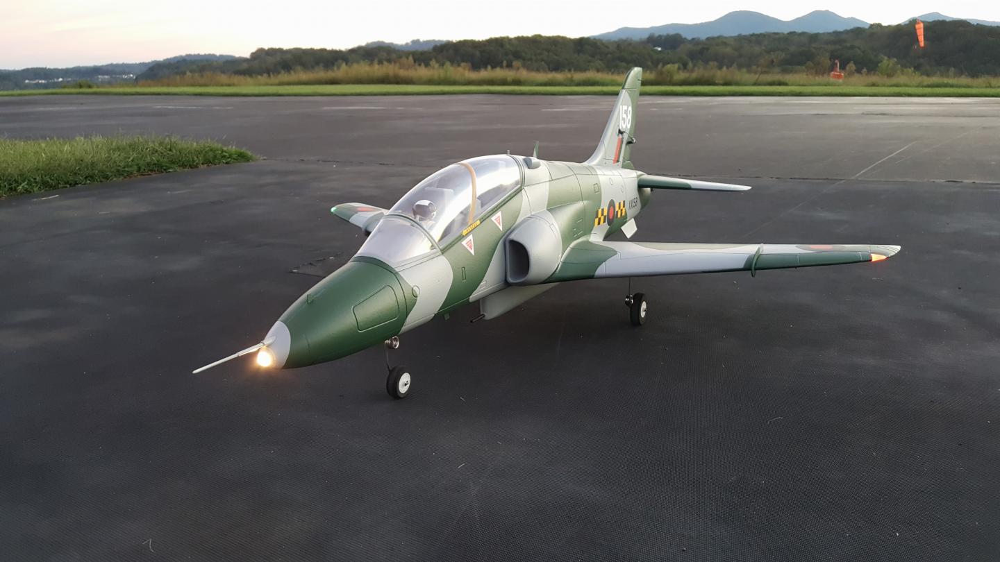

                                  Here are a few pics of the gray one painted up. It was nearly dark when I finally got it to the field for a quick maiden. I did the basic RAF green and gray scheme. Graphics are from Callie. I modified the front of the drop tank to turn it into a belly canon. Cut the foam , filled it with foam filler and embedded a piece of CG tube. Simple. This jet is I think another example of Freewing and Motion RC listening to their customers and providing what they are asking for. I realize the T-45 is already out there but it is in another class and price point. This little 70 mm jet is much like the 70 mm F-16. Simple but upgradeable gear, no gear doors which often just get torn off anyway, a sport jet livery and plain gray for those like me who love Warbirds. Add to that some very effective Daybright LED's and you have a nicely featured/optioned affordable package. I flew mine today with a Roaring Top 5800 35C pack as it balanced just fine at the factory CG of 162 mm from the leading edge of the intakes. I set my throws as follows: Elevator - 20 mm, Ailerons - 15 mm, Rudder - 22 mm. I am running 14 mm for half flaps and 22 mm for full. I noticed no need for any flap to elevator mix. In my DX9 I like 30% expo on ailerons, 25% on elevator and 45% on rudder with it. I flew it with a new Admiral 6 channel stabilizer receiver. It is very smooth and surprisingly powerful. It was airborne off our lumpy Geotex runway in about 150' and it needed only a few clicks of up elevator trim. It felt very comfortable and tracked well but at full throttle it was obvious that the gains on the stabilizer were too sensitive so I spent most of the short flight at about half throttle. It was enough for me to realize it has gobbs of power and is a fast little jet. I had to keep the flight short because I was rapidly losing daylight but those LED's sure helped see it. The landing was no big deal, just carried some power to a flared touchdown. I couldn't have been more pleased with it. Yes, I am sure Freewing and MRC will be delivering more scale/featured planes in the future but this Hawk is gonna be high on the fun factor list for sure. I have not flown a 70 mm EDF until now but it is a good all around deal for the price. Thank you Freewing and MRC for listening and delivering.

                                    That looks fantastic Steve! We are enjoying ours as well. 4000 up to 5000 for us no problem. Great bird!
                                      #38
                                      Thanks Ryan. I can tell that I am really going to have fun flying this plane. I have been spending a lot of time maintaining planes lately but this one is going to be less maintenance I think.
