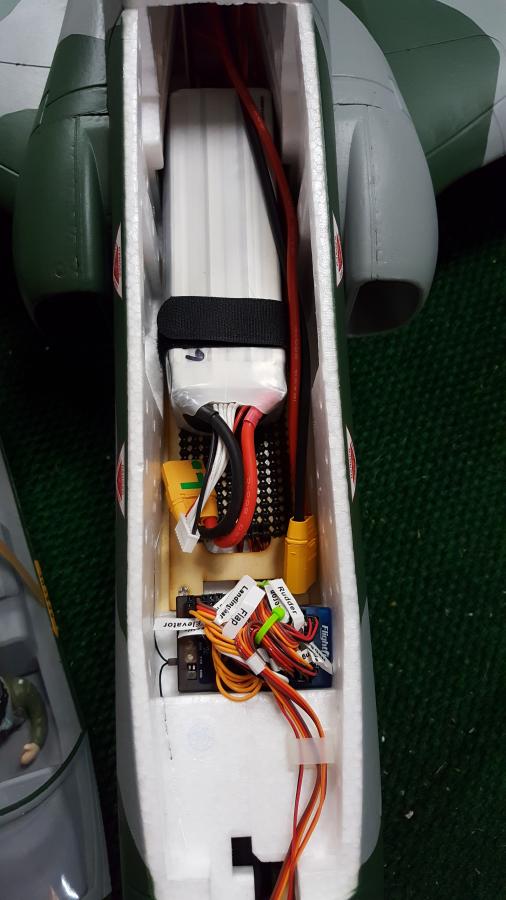

                          Are you flying it In the hawk! ? Would you mind posting g a pic of your gain settings ?
                          • at around 30 dollars I am getting much more interested in gyros ....always strayed away from them after watching the HH vids of the older 636 programing
                            • Best I have at the moment. If you zoom in you can see the first two pots are at about 11 o'clock which was my starting setting before the maiden and was too much. They are now at 10 o'clock.

                              • even your wireing looks neat and organized lol mine always looks like crap even when I hide it all under battery tray:)

                                  • I try to avoid the "rat's nest" at all costs. Some are harder to avoid than others but that is when I become a surgeon and pull out the forceps and hemostats.

                                        I'm loving the removable batt trays for hiding wire runs. On the gyro I'm with Steve on the gains around 10:00 it will get along at 11 but at speed you'll know it's there. On my Tigercat I get along fine around 11, the jets just go faster and need less gain.
