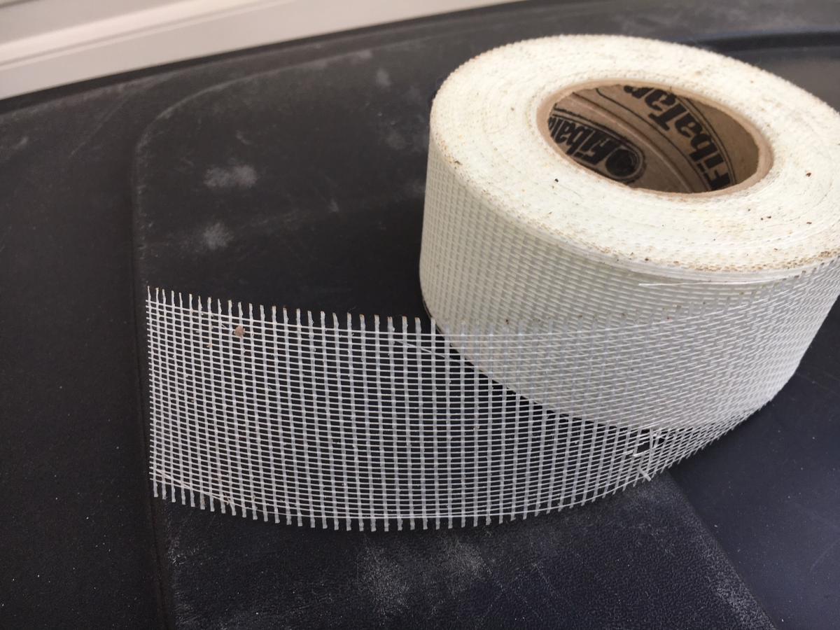

I have dozens of flights on mine but went ahead and did an inspection today after reading about the possibility of the fuse splitting. I can see the concern. Luckily I didn't see any separation or beginning signs of stress. But as a precautionary, I first ca'd the joints. Then I installed some re-enforcing mesh tape and applied Foam tac over it. Rubbed it on. Should be okay.Originally posted by moxjett View PostI finished my reinforcement of my Hawk. I went with the bamboo skewers with lite ply plate over them and the seam. Going to try and maiden her today.Currently flying: Twin 80mm A-10, 80mm F5, 80mm A6, 70mm Yak-130, 70mm F-16v2,90mm Stinger 90, 70mmRC Lander F9F, Flightline F7F TigerCat, Phoenix 46 size Tucano, Flyzone L-39

Here's a pic of the mesh tape I used. I think it's called Fibra tape. Seem to recall getting it at Ace hardware or Home Depot. It's got a mild sticky backing but not strong enough to hold anything. After first wicking in some thin CA to the joints, I cut and applied some strips of this tape to the inner and outer walls where these joints are located. I then rubbed-in some Foam tac all over the mesh with my finger. It's pretty darn secure IMO.Currently flying: Twin 80mm A-10, 80mm F5, 80mm A6, 70mm Yak-130, 70mm F-16v2,90mm Stinger 90, 70mmRC Lander F9F, Flightline F7F TigerCat, Phoenix 46 size Tucano, Flyzone L-39
