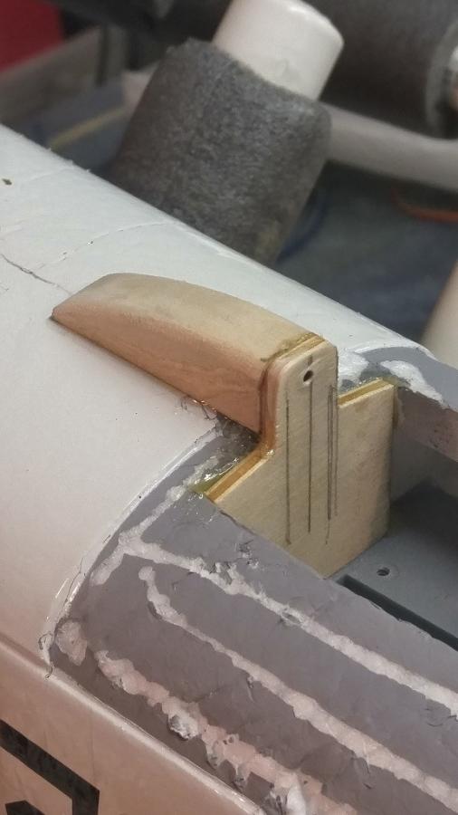

It occurred to me that since the nosewheel strut on this plane retracts forward, I could put a hard stop behind it to take the landing force and keep the front strut from bending.
The pictures below explain the procedure:

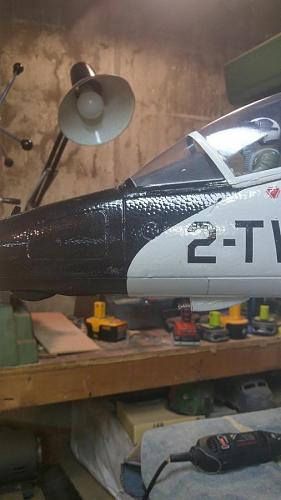

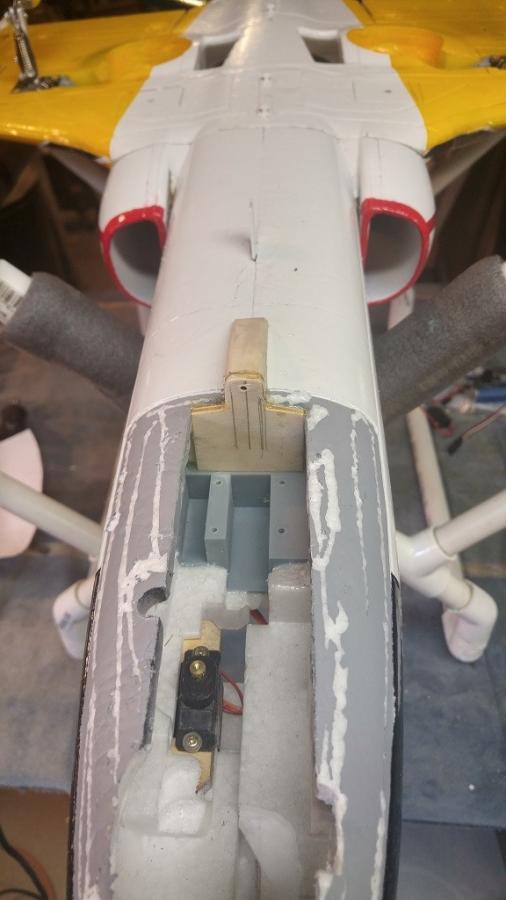

Plywood support glued to back of nosegear bay.
Side view

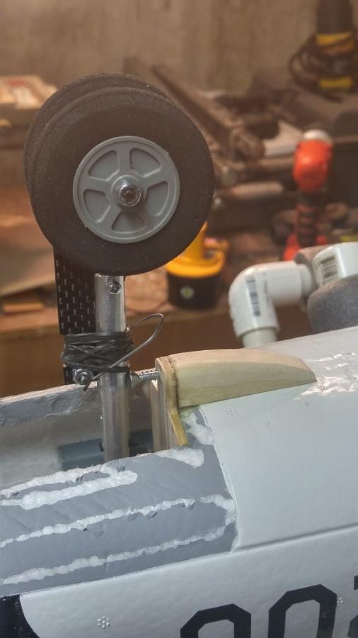

Screw used as adjustable stop for nosegear strut. Now base of strut and retract mechanism does not have to take brunt of the landing forces.

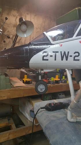

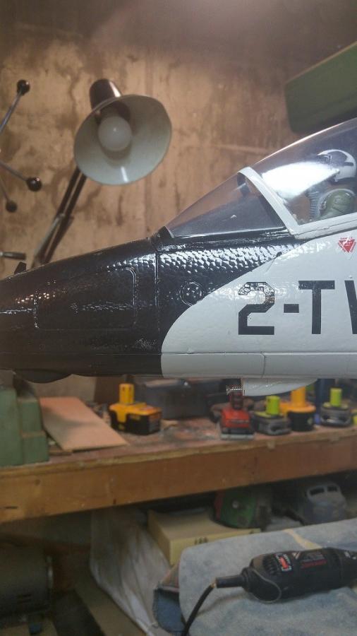

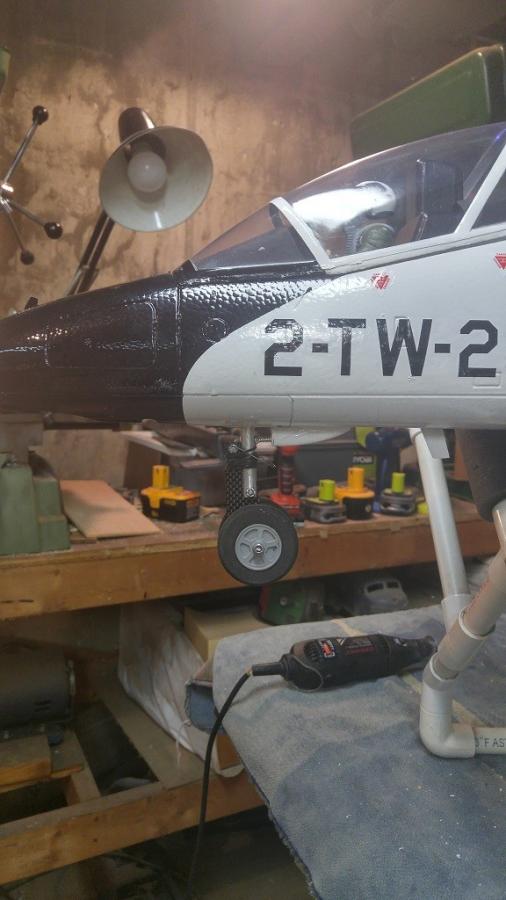

Completed upgrade. By the way, also upgraded to duel nosewheels to help with rolling thru the grass. Since this is a T45, its scale!
Nosewheel shown retracted.
Hope this gives you guys some ideas!
