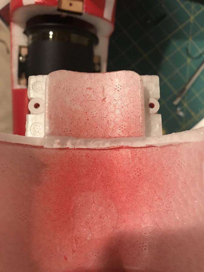

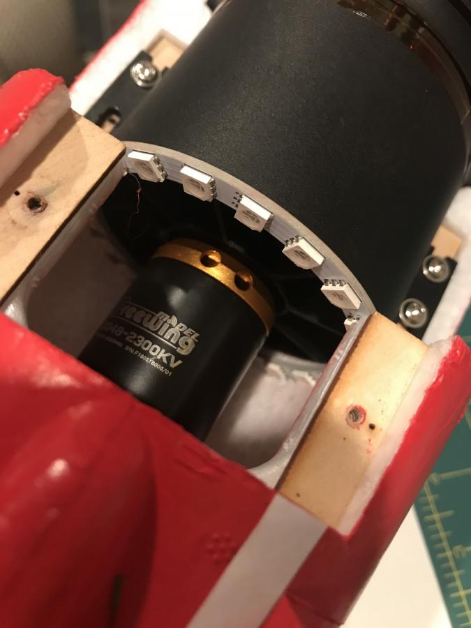

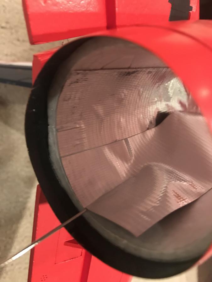

Hi Mark2,
There were two phases to this TSB ("Technical Service Bulletin").
Phase 1: "Field Fix". All customers who had received Hawks from the first shipment were offered to be sent a clear plastic reinforcement set.
Phase 2: "Factory Fix". All Hawks at the factory received a white plastic reinforcement set. All Hawks since then (well over a year now) have had that factory-installed set inside them. Your picture shows this set factory-installed, so don't worry, you're good to go.
Some potential confusion might stem from the fact that two reinforcement sets are physically different. The clear plastic set sent to customers was wider and covered more visible surface area between the conjoined areas of concern. The white plastic set that is now factory-installed is physically smaller and a different shape, because we changed the Hawk's foam molds themselves.
