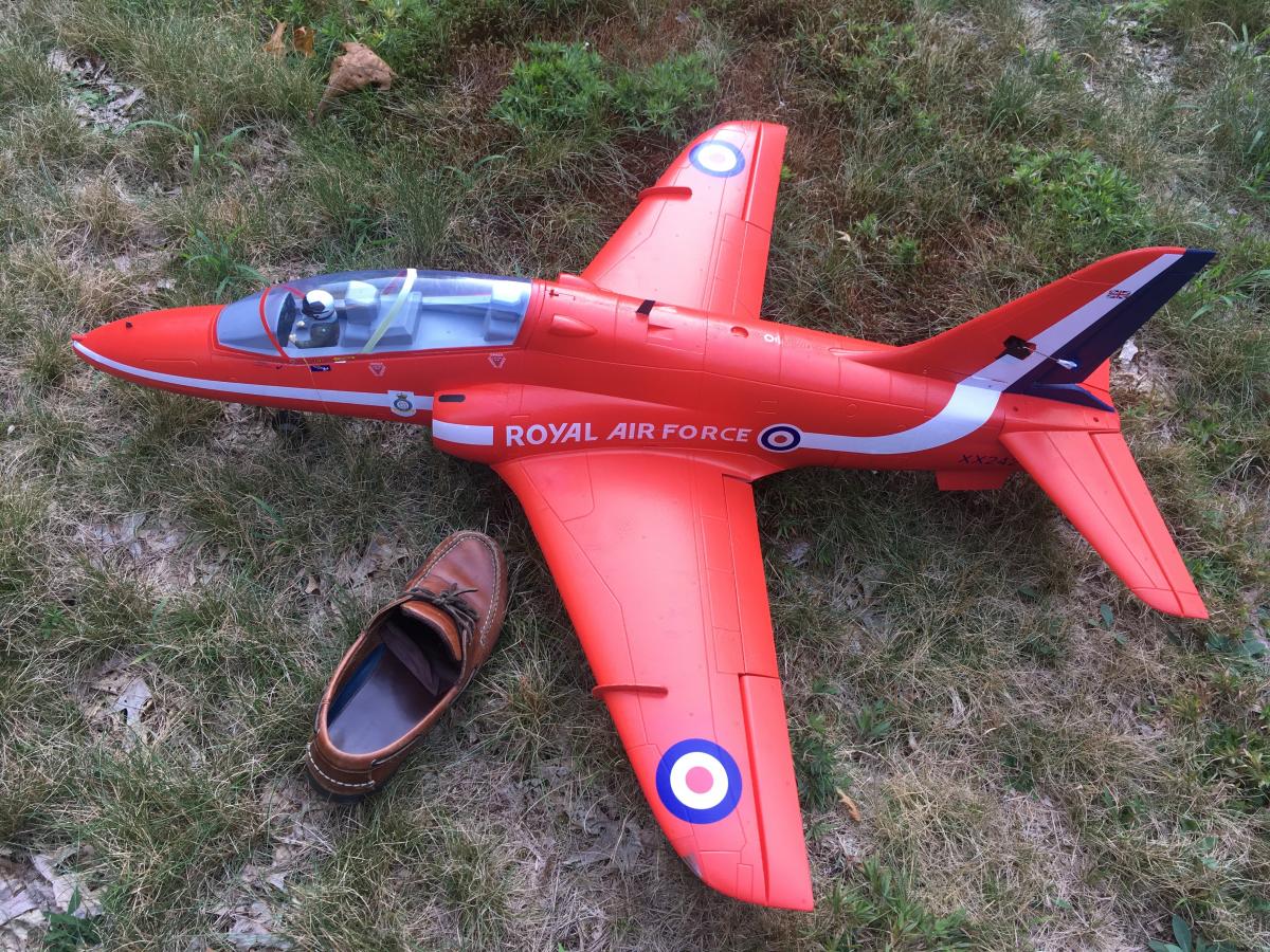

                        ...and here is what I put together (snapped off the pitot tube going through the front door...duh!):

                        I will not fly her until I've spent more time on some other birds I have. This is one of the things I'm going to do to occupy my time when I retire just around the corner. I'm glad I was pointed to this forum. Lots of info and inspiration here!!

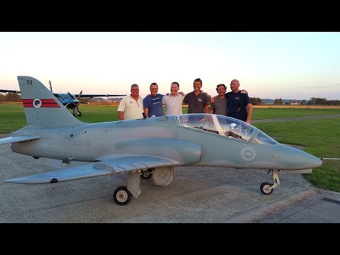

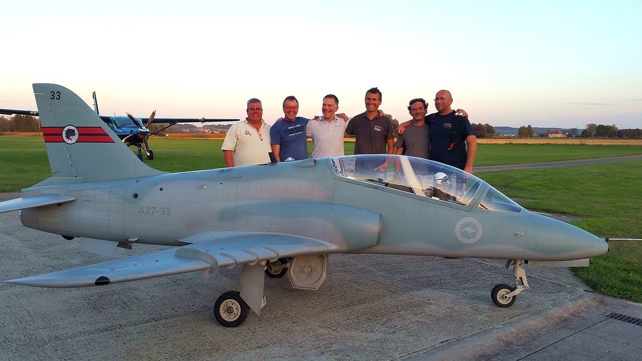

                                  • Giant version
