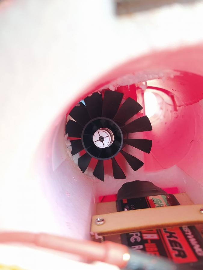

    I put it on ground, nose against a pillow, throttling up... At about 2 minutes 50 seconds, I heard the running loud sound suddenly gone! Stop to check, the fan flied off the motor! what a bummer.

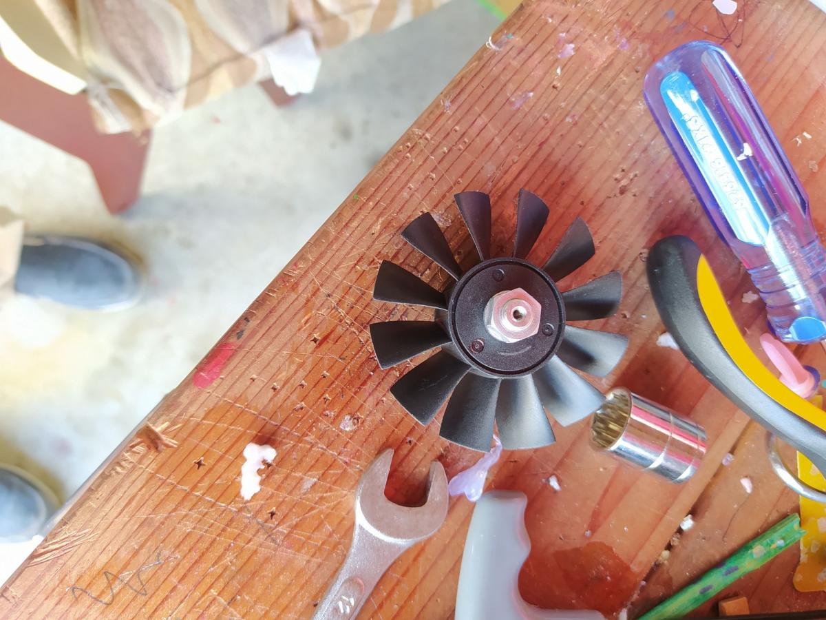

    Here are the pictures, it is exceedingly hard to loose up the fan adaptor to put it back to the motor shaft. Any good idea?
    I used a clamper to hold the adaptor, which actually damaged it, and using a wrench from another side, try to loose it up... but not working. The adaptor rotated following my wrench, despite I tried hard to use clamper to stop the rotating.
    It is already damaged, I believe. I am asking here just out of curious, how to deal with this situation? thanks a lot!
    • long-love-rc That's unfortunate! The fan and parts aren't that expensive if you look at the spare parts under the Bae Hawk. I would just replace it all. It's around $10. Better than worrying about fixing the old one and having it happen again or be imbalanced from wrenching on it.
      • Originally posted by SanExup View Post
        Certainly I just ordered a replacement, ban and adaptor. Now I am worrying how to properly tighten it up... This kind of adaptor is not really robust, from my experience so far.

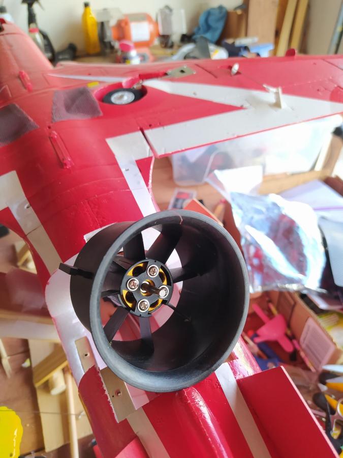

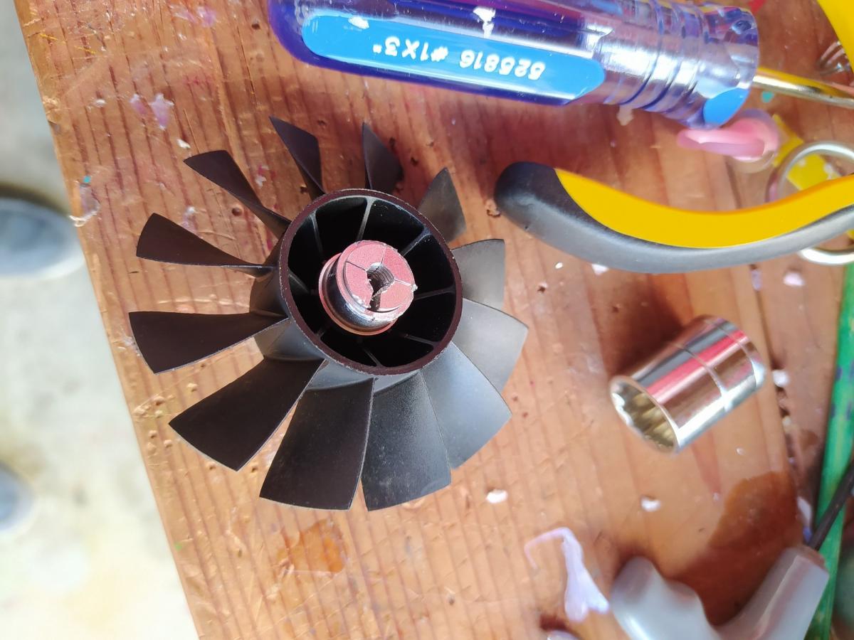

            The new fan came this week. However, as I worried, I wasn't able to properly tighten it up on the motor shaft. This is a friction gripping mechanism. When I tried to tighened the locking nut up, the fan and collect turned together, So no effective tightening.
            The painful part is there is NO way to stop the fan from turning. Using fingers, just no enough force. Then I use a wood piece on a blade root to stop it, that simply broke the blade. That fan was damaged.
            Then I removed the damaged fan, put on the last fan which flied off last time. That fan is still good. This time I only used hand to tighten it up as much as I can, plus some loctite. Without surprise, when testing, it flied off again.
            Finally, I cut a slot on the collet. Insert a flathead screw driver into the slot, with the intention to stop it from turning. This somehow worked a bit, I believe I tighten it more what I can do with hands. However, the metal(those collect are made of junk metal) are so soft, the screwdriver eventually scrapped off some metal. So I don't expect very tight gripping. Now I am waiting for the loctite to cure, then to test it again.
            Lesson: for such kind of situation, it is better to just buy a whole EDF assembly, other than replacing the fan only.
