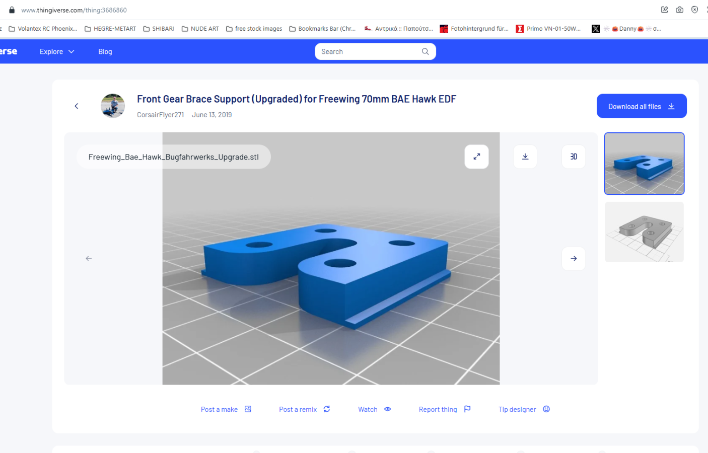

                        Originally posted by johnsctt78
                        hi guys
                        my freewing bae hawk nose gear has left and right slop in it, brand new out of the box, i tried to taxi down runway and it was wanting to go left and right, just looking if anyone else has this issue and if there is a fix for it
                        i have the same problem too , only with this plane from all my fleet. I found that there is a big free play in the front wheel system and when i fully open the throttle for take off the pressure on the front wheel make it to move wherever it wants . I replaced the pins in the landing gear with bolts& safety nuts and i printed and glue a Front Gear Brace Support . I also keep some up elevator on rotating to lessen the pressure on the front wheel. I am still not completely satisfied but it works 80% of the times. In landings it is o.k.
                        Click image for larger version  Name:	Screenshot 2025-11-18 092524.png Views:	0 Size:	305.3 KB ID:	439834
