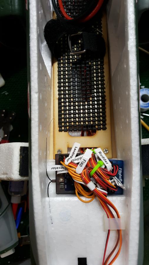

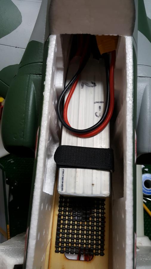

            Here you go Dave. I balance mine inverted with the wheels down where the dot is on the panel line on the wings.
            I have an Admiral 6 channel stability receiver mounted next to the connector box.
            And the end of my RT 5800 35C battery is lined up even with the foam step in the side wall.

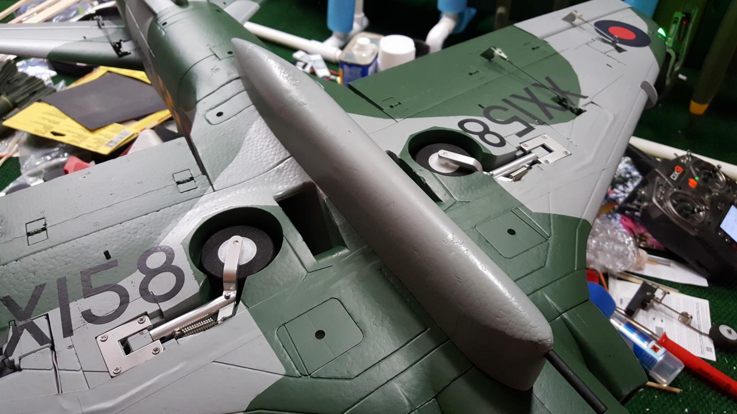

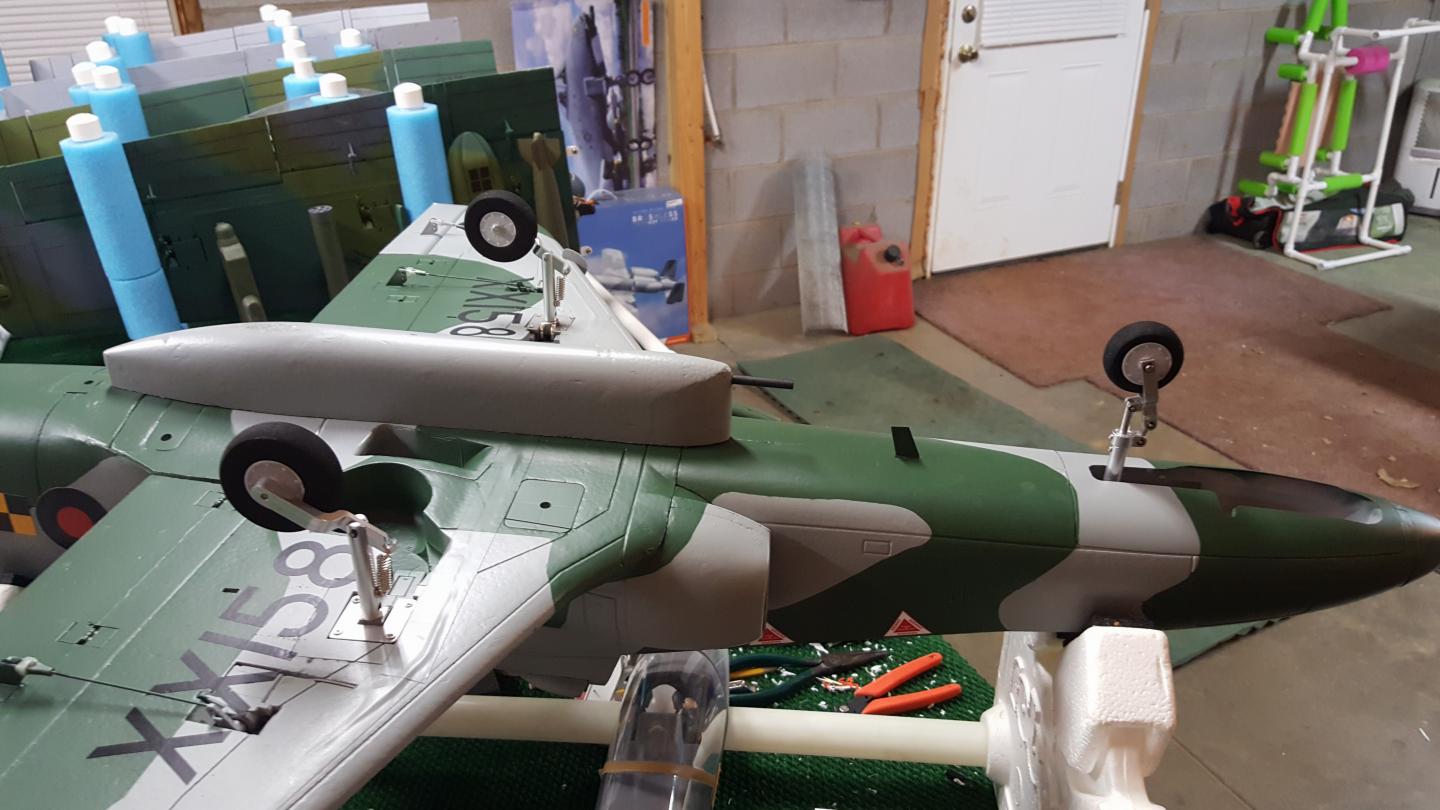

                Got my upgrade struts today. Takes about 30 minutes to install them. Nothing major to note.
                Like a glove.....
                Ready for flight.
