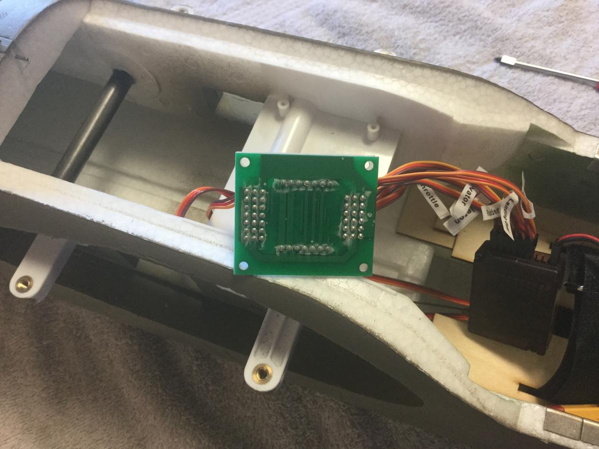

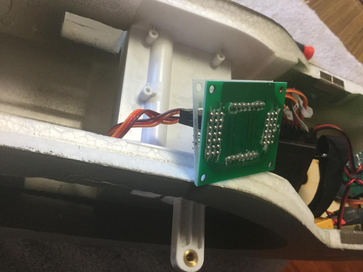

  • dkalwishky

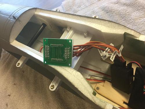

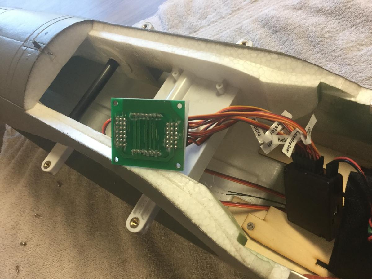

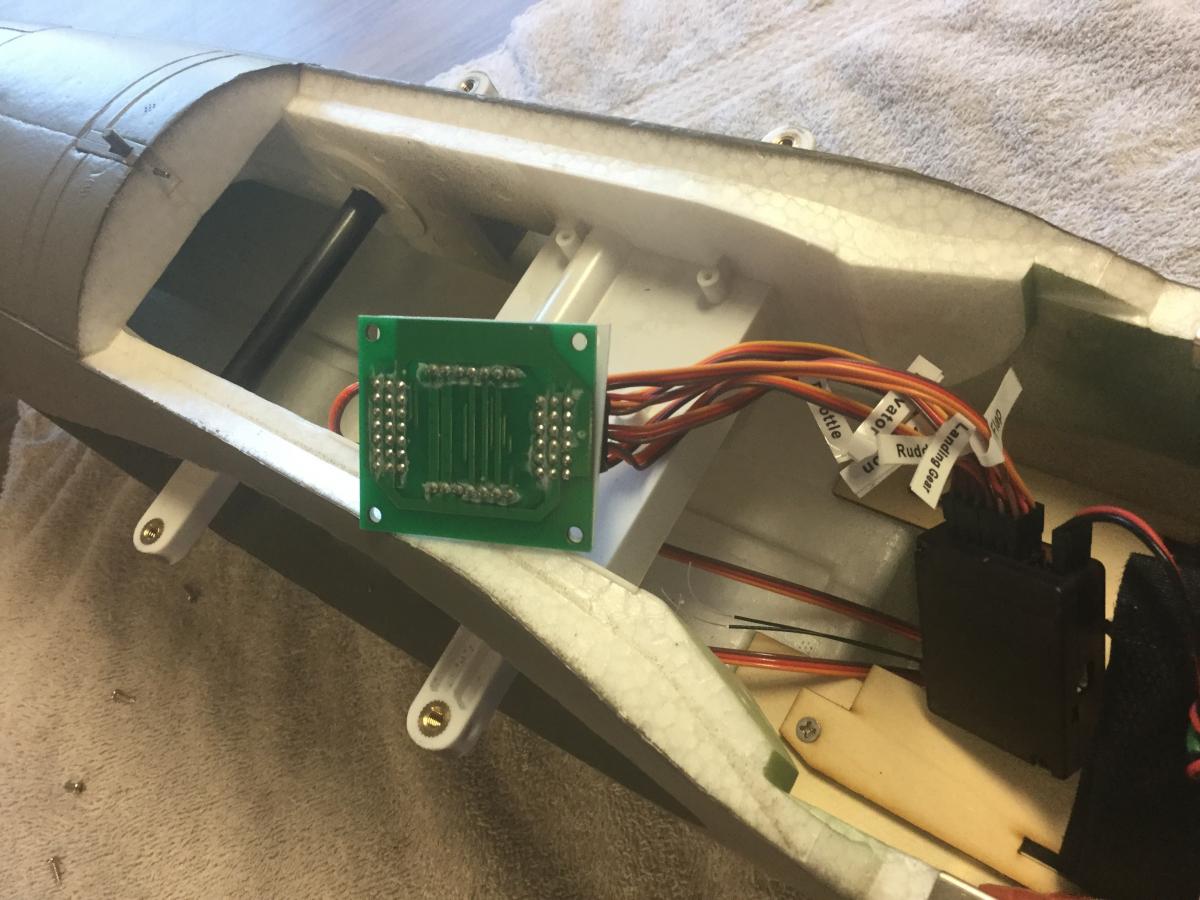

    I took these pictures of my control board tonight. Anyone think I should replace it?

    I'll be blasting mine with corrosion x
  • 4923crew
    I had some crazy stuff happening on my bird which I troubleshot and replaced the control board. Mine had a ton of corrosion on the backside that refersed my aileron servos on the maiden flight and crashed my bird. Now that I replaced the board I have zero issues.
