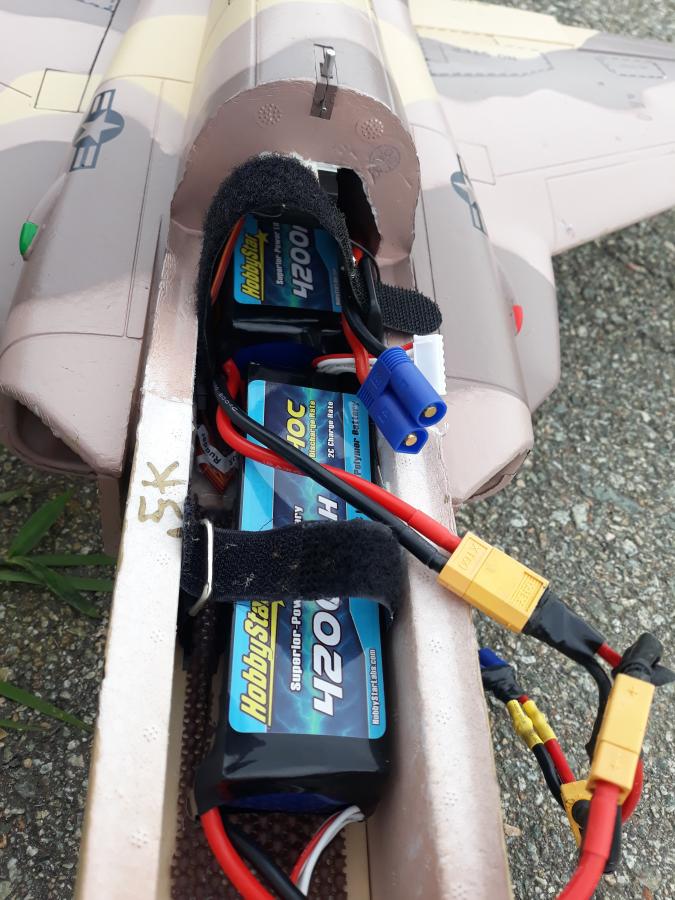

                        Robert,
                        Thank you for the for the battery suggestion, I have quite a few of those HS 6s 4200's as well, I love em! I hollowed out quite a bit of useless foam on the underside of the back canopy so that I can stack two in parallel back there and still remain on CG. So the fun alpha flights will be with one battery, and the longer demo flights or touch and go flying days will be with two. This is how I setup a number of my birds, I use this same configuration in my FW F-5 80mm. Click image for larger version
