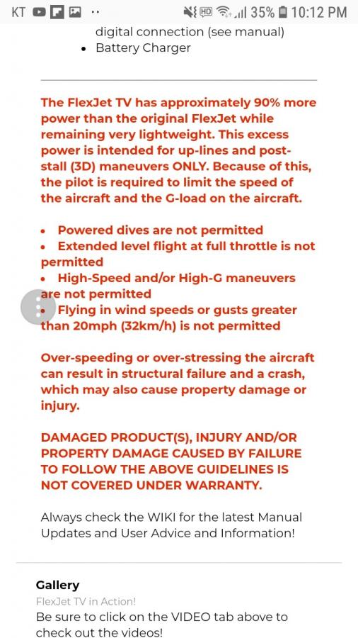

                          I see it now. I got distracted by their disclaimer. I wonder why they needed to warn people of all that. I'll look forward to your impressions when you fly it. Just be ready when you flip the switch to mode 2 and 3. It may not phase you but then, it could catch you off guard - do it up high and not going too fast when you switch. The plane was marketed as a "3D" jet, so I guess it needs the high throws and instant response. On the other hand, if you ever flew it fast and then suddenly cranked on it, I fear it would tear itself apart (like in the warnings for the new TV version). I never flew it as a "3D" plane since it doesn't have enough power to hover. I have my Mig 29 with TV to do that.

                            It's a little concerning regarding the disclaimer, an EDF jet in my opinion should be a high performance, yank and bank, high G capable aircraft. I do feel a little bit better, that I have yet to run across a thread or video about structural failure :Cool:

                              I don't recall such disclaimers in the original jet. I just checked the manual and it says nothing like that. That makes me wonder why they felt the need to add it to the new version. Did reports come back to Flex about structural failures? When you get the plane, you will see just how much movement there is in all directions and all surfaces. To me, it was downright scary.
                              Looking at the manual now, I must correct one of my previous statements. In mode 2 and 3, gyro gain is actually increased but that makes for more stability in wind and when doing 3D maneuvers. The manual did confirm, however, that rates get higher in mode 2 and very high in mode 3. Although expo is also increased, it is still easy to over control the plane, especially at high speeds. I reduced the throws in all modes for my comfort and increased gains for the same reason.

                                Xviper, they are claiming a 90% increase in power with the TV version verses the orginal. That is the only reason I can think of for the disclaimer on the TV version. That's an incredible claim in my mind for a power increase. It's in the first paragraph of the disclaimer.

                                    That's almost double the power. I find that hard to fathom. I must compare the specs to see what they did. With double the power, it might just be able to hover.

                                      The motors are within 50kv of each other, they increased the esc by 40 amps, and went from a 6s to an 8s battery, appears to be the exact fan for both setups though...

                                        Ahhh, 8s is likely the reason. This should make it do high alpha and possibly hover, but it will also likely make it fly very fast, thus the warnings. (Not that the original 6s version is a slouch.)
