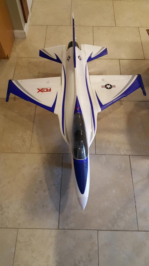

ID:	127725Click image for larger version
            Originally posted by Bajora
            Good stuff Bill ... we be looking forward to getting more flights on ours in the days and weeks ahead. Six flights total this AM, with a blue model from another local pilot also sharing the skies.
            He has a Spektrum GPS telemetry module aboard his and reported top speeds of 130+ MPH?!
            EDIT: Oh ... and you may notice that I forgot to install the side fairings between the exhaust nozzle and elevator stabs. Duh! Found them in the box when I got home. Blue leader teased me mercilessly all morning for the failure! :P

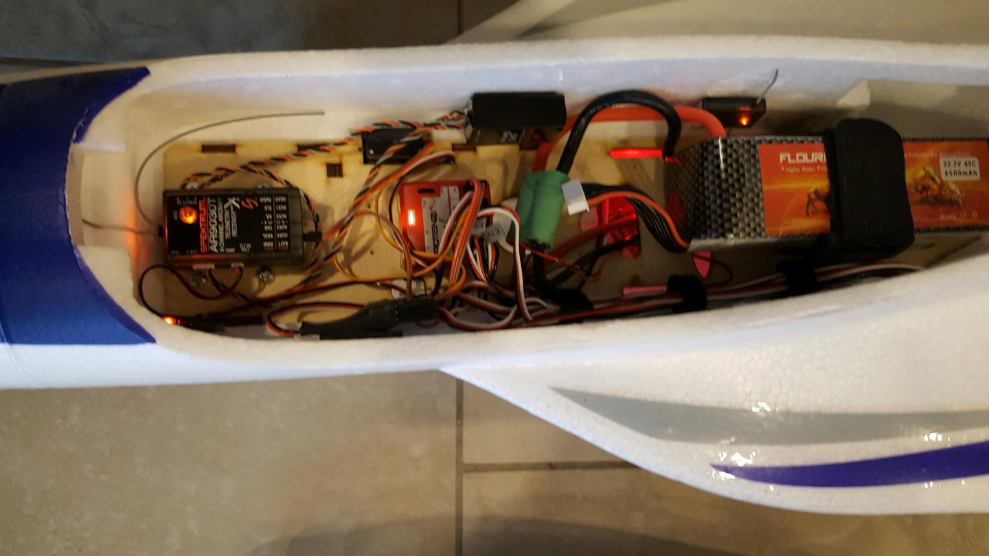

            Was privy to the build the other night on the Blue & White one WOW I've never seen so much electronics in one places! BLOWS the mind! GOOSE!!!!

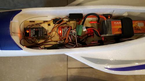

                          I was the flyer of the blue and white one, that reported top speed on the Spektrum GPS of 130 + ,and I'm proud to report that I actually put the plane in my truck with the GPS initialized. I not only have the manual speedometer in my truck but also a GPS speedometer linked to the ECM in the truck, drove around for about 20 minutes on and off the freeway and around town and the GPS matched on my truck within .2 miles an hour and would drop and lower speed almost as fast as the speedometer in the truck.

                                    This is blue leader haha. In response I was using the floureon 4500 mAh 45 C in the blue and white flexjet . it's not really my high performance pack, but just wanted to see how it would feel and the CG is perfect, and I didn't have to trim the flexjet at all from the very first flight flew beautifully!!!

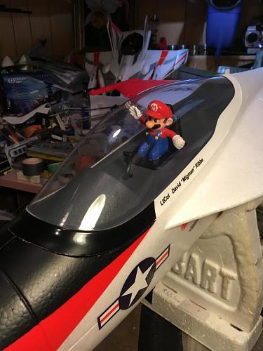

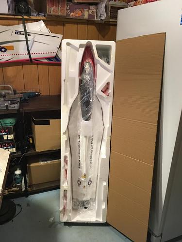

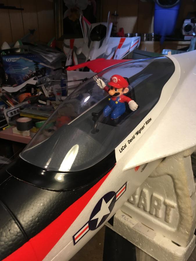

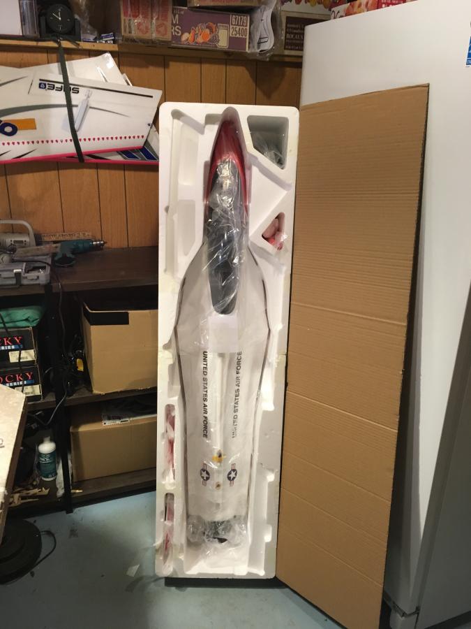

                                      Got mine yesterday and worked on it in the evening. It's finished, just need to recheck CG with wheels down as per manual.
                                      Has anyone mentioned that the box is very long? The fuse is only about 5" longer than the Avanti S but it's one piece (where the Avanti S has a detachable nose cone). The Flightline A-10 is much longer when completed but the fuse comes in sections so the box wasn't that long. It came well packaged and shipped safely.
                                      Note that's a standard refrigerator next to the box.
                                      Foam quality was good overall but I noticed one spot that was a little thin on the top of the wing where the carbon tube goes through. You can see the foam cells but this is not unusual for foamies.
                                      First thing I noticed when I took off the EDF hatch was all 3 motor wires were not fully connected, so have a close look and rectify. The thrust tube was easy to take out but getting it back over the fan shroud took a bit of fiddling.
                                      Installing and adjusting those control rods for the elevators were a bugger. Clipping onto the horns, unclipping repeatedly to adjust the length was a bit tough for me as it was such tight quarters to work in. My hand actually cramped up doing it.
                                      Cutting out those little paper elevator calibration guides took me back to grade school. I almost felt like I should have used plastic scissors. LOL They were very handy and took the guess work out of where to set the elevators.
                                      I'm using a Lemon 10-ch Rx with sat. (that's all I had, but a 6-ch would have sufficed), so this required pulling all the servo connections from the Aura8 and re-connecting as per manual. One thing of note ................ they do not provide all the wires that go from the Rx to the Aura8. They are female to female servo type wires and you need 4 of them. You'll also need 2 "Y's" to gang the elevators and rudder/steering together.
                                      The retracts are beautiful. The only ones that are even nicer are the ones that come on the Freewing 90mm F-16 and the FMS F7F Tigercat. I dabbed a little FoamTac on all the C-clips.
                                      Not being one to follow convention, I chose my own "special" pilot figure.
                                      Won't be able to maiden it for a week or so as the field is a mud bath.
