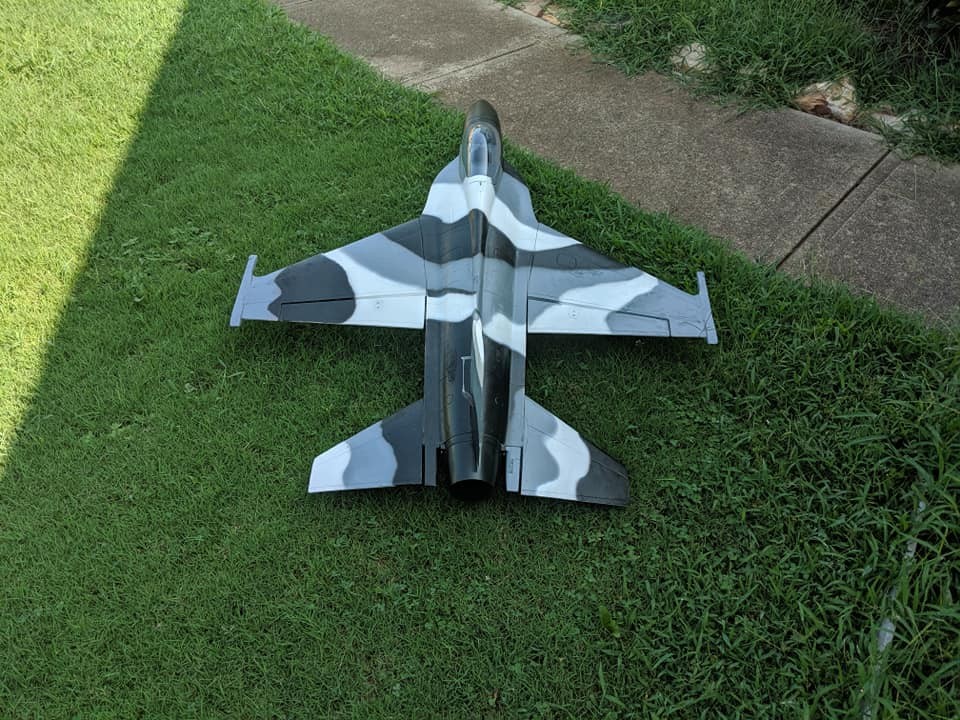

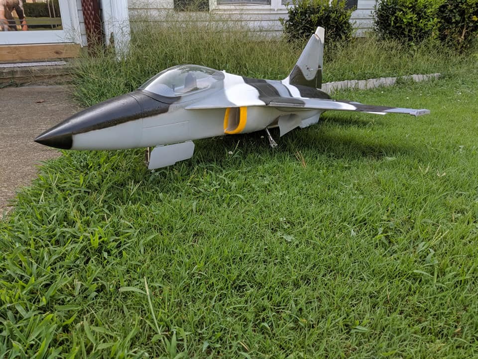

                        • Her's my newly finished Flexjet. My Avanti met an early end when it augured in on it's maiden flight. Pilot error, I believe I had the ail. going the wrong way on the gyro. Oh well. I have a bunch of Flex planes so I thought I'd add the jet. Raining here in Fl. so won't get to fly it for a couple of days.
