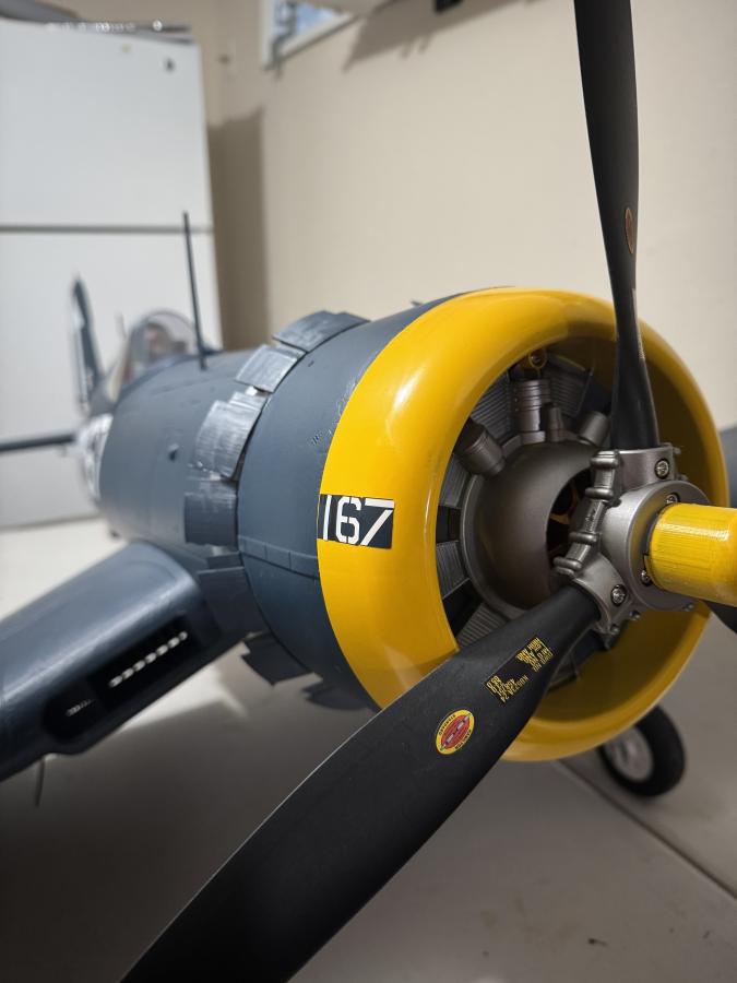

    I wonder if you couldn't rig those cowl flaps with a light spring so that the wind would flatten them while in flight and they would open as you slowed down?
    Elbee, what do you think?
    (Dangerous Dan)
    All,
    That was my original thought and design.
    Worked perfectly, though finding expansion springs that fit was tricky.:confounded:
    Ace Hardware had these and as I wrote worked quite well.:partying_face:
    I later figured why not 'go for it' and make those 'servo driven'.:smirk:
    A bit fiddly at first, but once I added a sliding arm part, these worked awesome, as well.:star_struck:
    The design on Prusa Printables is for 'spring loaded' cowl flaps.
    Best, LB
    (Dangerous Dan)
    Originally posted by Aros
    Thanks Dave! We can thank our good friend Elbee for those cowl flaps. Sadly I lack the ingenuity and skillset to make them operational so they are static only. I just love the way they look. With some luck they will help me fly better!
    They certainly look the part, that's for sure!! Nice job!

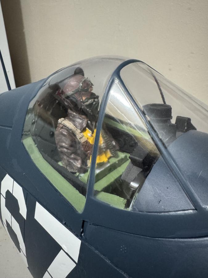

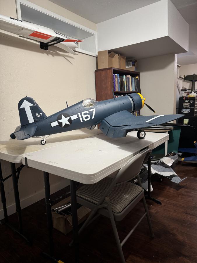

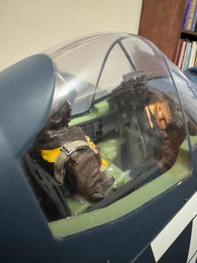

    Originally posted by davegee
    Nice looking plane, Aros! I especially like the cowl flaps and the parachute straps over the shoulders of the pilot. Very believable!
    Are your cowl flaps rigged to move in the wind or motorized in some way?
    Good luck on your next sortie.
    Cheers
    Davegee

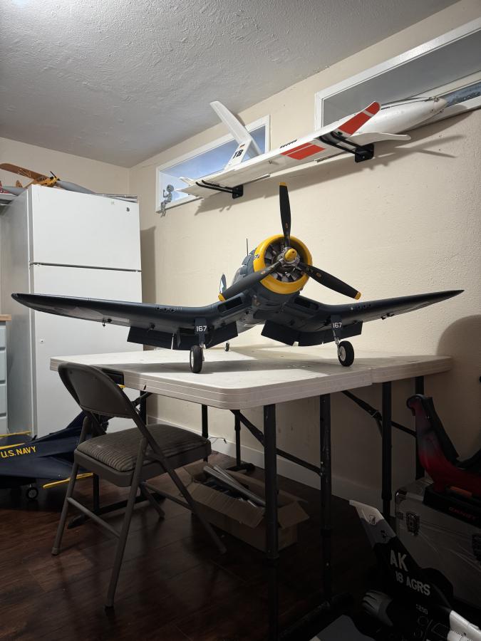

    Mine has been sitting far too long. Going to take her for a ride tomorrow.
    What a beauty!
