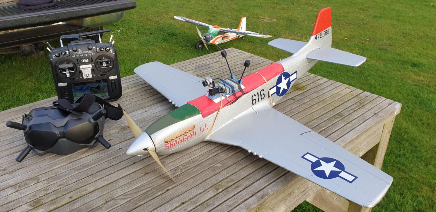

    I just bought a Flightline 850mm P-51 Mustang this last week from Motion RC. They only had 4 left at that time, so that prompted me to pull the trigger. They described it as needing a tail color as you choose, and they said that decals are included in the package. But the one I got had a yellow tail, and had the Shanghai Lil decals already on the plane. That's exactly what I wanted, although I was expecting to do the painting and decal placement myself. I consider myself lucky, but I wander about those who are expecting a plain model the way Motion RC describes. Anybody else had this happen to them?

    Lookin good
