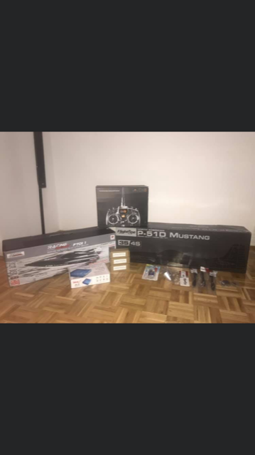

    Well, Xmass came early to my house this year :D
    Guys, I've got a DX 8 and a Admiral rx600 gyro receiver, of which I dont know squat.
    I learn to fly on my beloved Carbon Cub S+, which I got as RTF, so it was just plug and play.
    Any advice on how to setup my TX and receiver?
