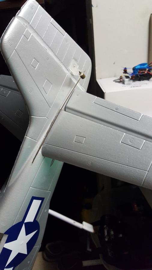

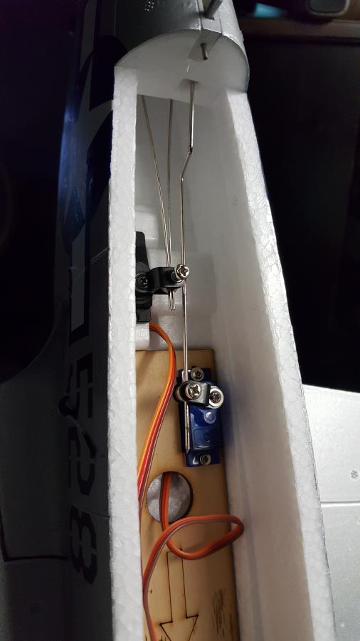

    I used a sleeved pushrod kit with clevis' that motionrc sells in the accessories as a 2 pack. I added a rudder easily to the p 51 but that kit might be too short for the dora. I added a rudder to the Dora as well with the 2nd sleeve and an old pushrod I had.

    I did a short vid of my rudder mod. The only thing was that it was difficult to find the correct pushrod length because of the small diameter of the hardware. My pushrod came out at about 15 inches.

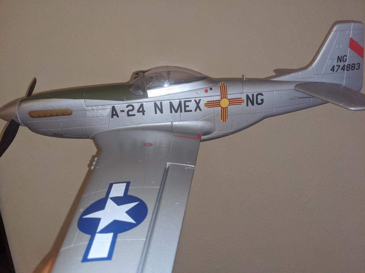

    I picked this plane up at a nice hobby store in Louisville KY during a marathon cross country drive last week.
    I wanted a fun little park flyer and this was perfect.
    I customized it to match a New Mexico National Guard plane. For a while instead of the stars and bars on the fuselage some guard units used state insignia. NM used the Zia Sun symbol from the flag and a local Pueblo.
    It was a quick convert, using laser printed water slide decals and a cricut cutter to trim the Zia decal.
    I installed the new spektrum smart receiver and have it programmed and ready to go. Now I just need to wait until I'm off self quarantine.
