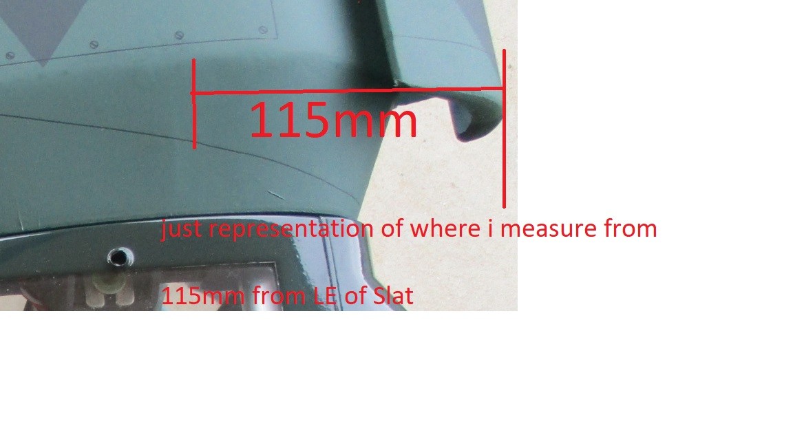

      Click image for larger version  Name:	Storch 006.JPG Views:	0 Size:	91.3 KB ID:	199456
      The CG point to use
      115mm from LE of the Slat..NOT the leading edge of the wing...
      The plane needs to have
      coordinated Rudder with Aileron I have it mixed and set to 50% on the Futaba J10
      Also I Used Closed loop for the Rudder connection instead of the pushrod as the plastic tubes where all ready in the fuse - saved a bit of nose weight..

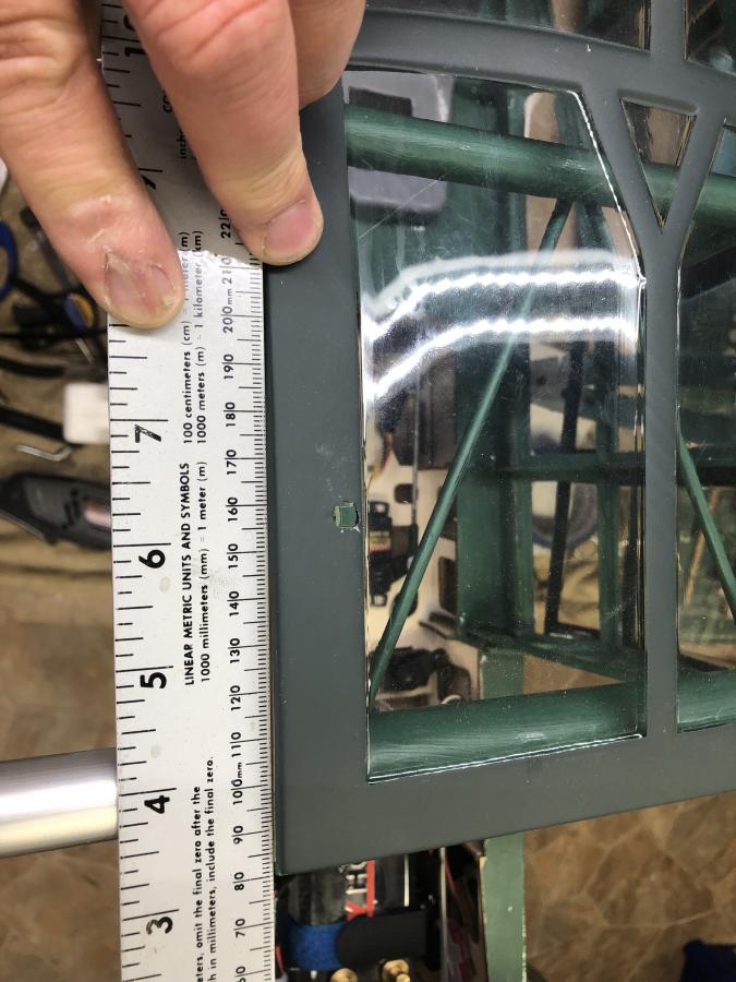

            #25
ID:	199442Click image for larger version

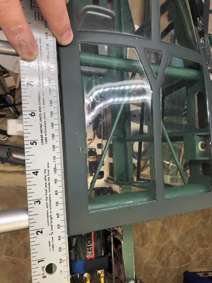

ID:	199440 Well, the plot thickens....
            I went home during my afternoon break and did some measuring. It is 80mm from the leading edge of the slat to the front of the cabin, with the front window removed. If I use the 115mm you suggest Terminator, the CG is just behind the back edge of the front wing tube. Looking at the picture you provided, you show 115mm to be just a bit in front of the wing mounting screws. That would be just about the right place if you use 115 mm from the LE of the wing, not the slats.... So, I would like to ask you to please check the CG and measure back to be sure you are at 115mm from the front of the slat, not the front of the wing... I have included some pictures....
            One shows 80mm at the front of the cabin... that would be 80mm to the front of the slats, and then back to 115mm put
            • TonyF3A
              WWII Giant Scale/Jets
              • May 2018
              • 50
              • Muncie, IN
              #26
              sorry, didn't finish... the last sentence should be puts the CG just ahead of the back of the front tube. If I use the wing LE, that is 40mm in front of the cabin area, so going back gets you just in front of the wing mounting bolts, which looks about right to me. that works out to about 32% of the wing cord, which is also about right. When I flew my first test flight, I was probably at about 20mm FURTHER BACK than this 32% point and so I added weight to get TO this 32% location and the airplane was WAY TOO NOSE HEAVY.... So, I'm back to square one... Where really is the balance point on this airplane???

                    #29
                    That picture was just a quick representation of where I measure from not the actual location on the fuse , just use the 115mm from the slat and it will be fine , mines had about 90 flights so far and still going strong..
                    Also movements on the Elevator I have about 25mm each way and the rudder 50mm each way..

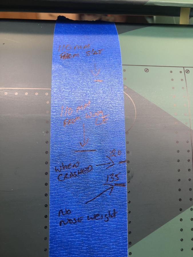

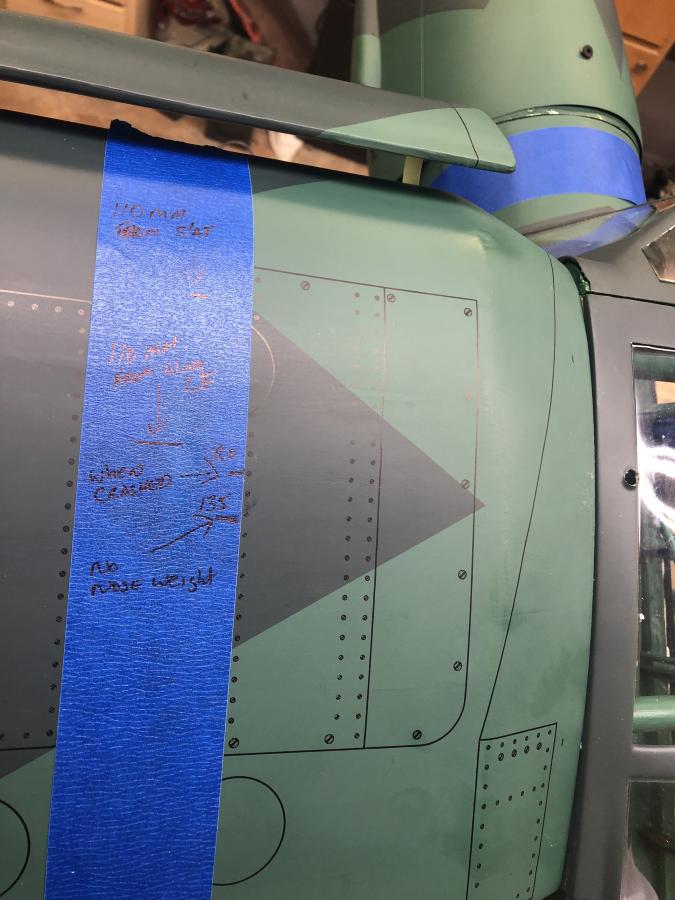

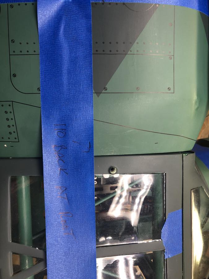

                      Well, I checked the balance. I put some blue painters tape on the wing and mark 110mm back from the LE of the Slat, 110mm back from the LE of the wing. I then checked where my CG was with the 1.5lbs of lead and it was at about 120mm back from the LE of the wing. Remember, that was the CG when I crashed from being way too NOSE HEAVY. I didn't have enough elevator to stop the decent. I now have removed about 1 lb of the lead, and that brings be to about 135mm back from the LE of the wing. THis is probably just a little forward of where it was for my first test flight when I thought it was tail heavy. Upon checking, this measurement is just about exactly 110mm from the LE of the wing, AT THE POINT WHERE IT MEETS THE FUSELAGE! The LE sweeps back when it meets the fuselage. I now wonder if this is where the CG is supposed to be? The picture with the blue tape across the fuse and wing is the 110mm from the LE of the wing at the fuse. This works out to just about the back edge of the box that surrounds the wing mounting bolt, or about 15mm behind the wing bolt.

                        #31
                        Its not LE of wing at Fuse , its 115 mm from LE of The Slat which works out something like approx. 6 - 7 mm past the front wing Joiner tube that's where I fly it and it flies well ….
                        anyways not much more I can say so good luck....

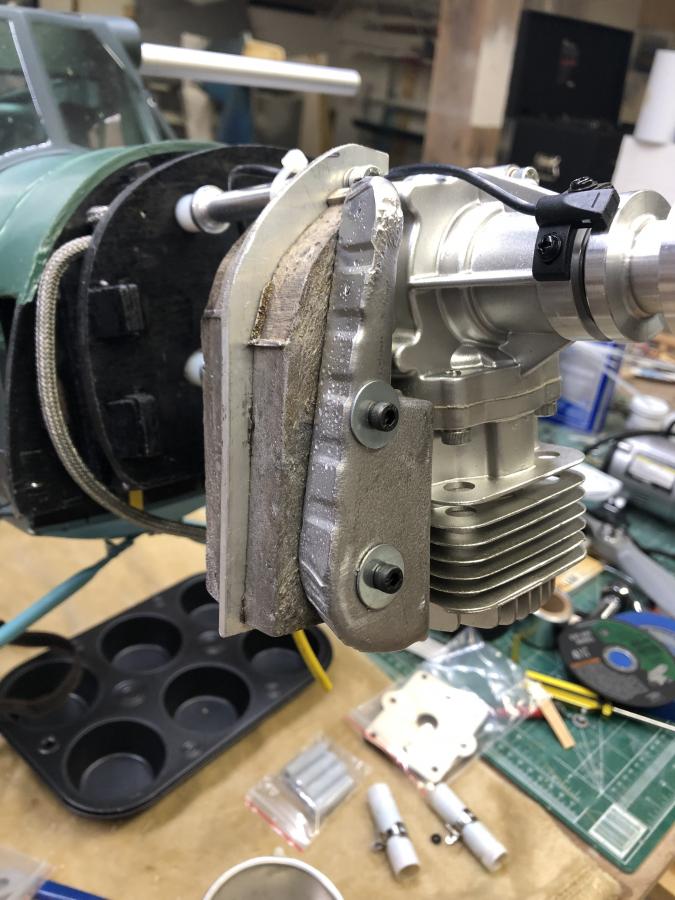

                                  OK.. so last night I put the airplane on my CG machine with the balance point at 110mm behind the LE of the Slat, as first recommended by Terminater007. It took an additional 4 pounds of lead mounted to an aluminum plate which is attached to the front mounting screws on the R/H side of the DLE 35. I made a mold for the lead, and poured up 3 pieces and bolted them to the plate. I got done about 7PM last evening and had a window of time where it was not raining much, so I took it to the field to fly. IT FLIES GREAT! It required about 1/4" of up elevator trim at the back of the elevators to fly with the flaps up, so I would like some feedback on that. When I put the flaps down about 30mm, the model flies smooth and easy, and very slow and scale-like. Landings were easy and it flairs out great.
                                  So, the big question has been answered! Balance at the 110-115 mm from the front of the Slat, or about 7mm behind the back edge of the front wing tube. I will pass this along to the good folks at Motion RC so that they can get the instructions modified. I also believe that I can make a much lighter stab-fin brace to save 3-4 ounces which would be about 3/4 -1 pound up front. By converting the rudder to pull-pull cable will also save nose weight. I also believe I will convert the elevator push rods to Carbon Fiber rods (still in the sleeve) and that will also help.
                                  Once again this forum proves to be invaluable! Thanks to Terminater007 and 3RedPapa for convincing me to add the weight! Now, hopefully Black Horse can do some mods to how they make the kit so that future owners won't have to add so much weight!
