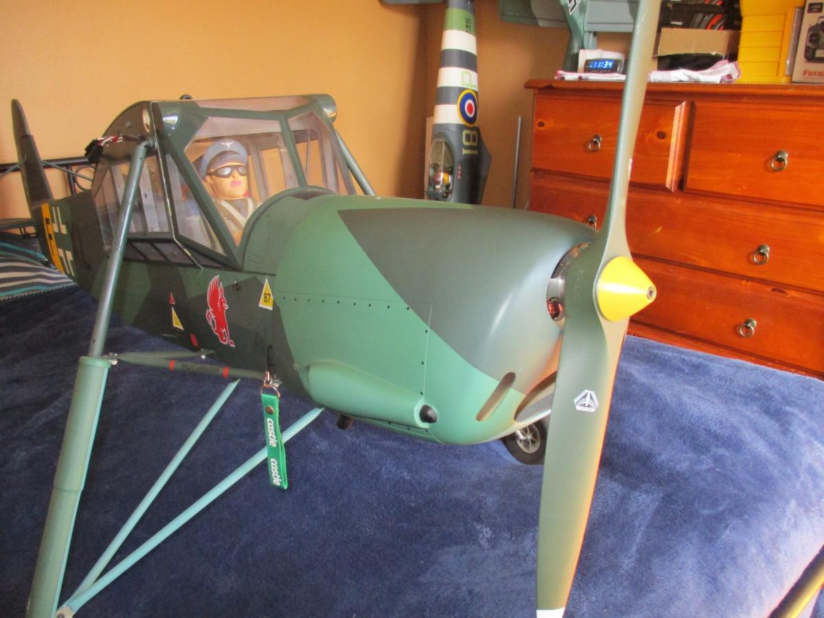

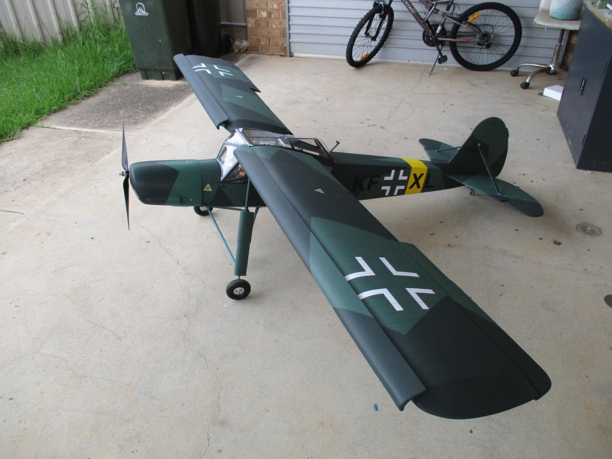

                      Click image for larger version  Name:	 Views:	0 Size:	112.0 KB ID:	195213
                      The main gear have suspension (oleo type) at the end of the legs
                      CG is 115mm from LE of Slat
                      And it flies very well this model has had a matt clear coat on it
                      This is powered by a Eflite power 160 using 10s 5000 mah and a 18x10 prop (currently using a Painted Falcon scale civil prop not the apc shown )
                      one day i'll get around to setting up Flaperons on it...

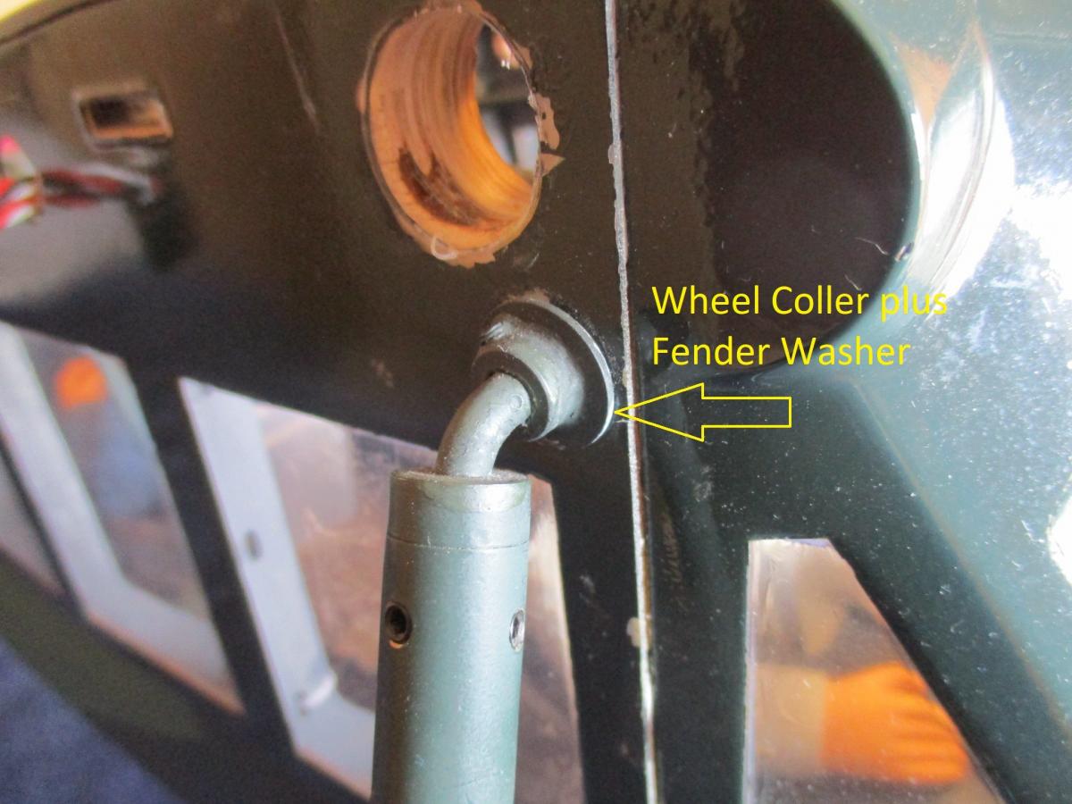

                                One suggestion is to add a Wheel collar and fender waster to the top of the U/C struts to transfer some of the Stress of landing to the ply reinforcement.
                                as its only a threaded pin screwed in a blind nut which came loose after a while.

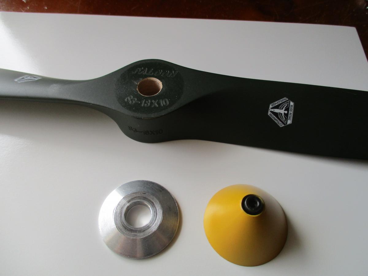

                                Spinner is a cut down alloy spinner from HK cut down to fit over the prop washer :)
                                prop is a painted falcon 18x10 scale civil prop.

                                  Thanks for the u/c tips. Also, I searched for months for a spinner but no joy. That's a great looking spinner and I plan to copy...thanks!

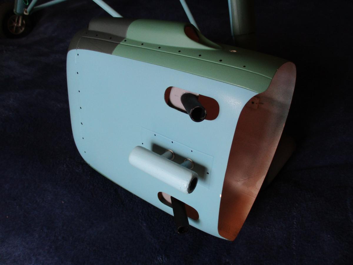

                                    Was able to test fly my new Fieseler yesterday afternoon.... Had to add 1.5 lbs to the nose. I flew it without the cowl to test the new DLE 35RA. Didn't have to adjust it at all! Ran great... Hope to get a few more on it tomorrow, this time fully dressed with the cowl in place! Click image for larger version
