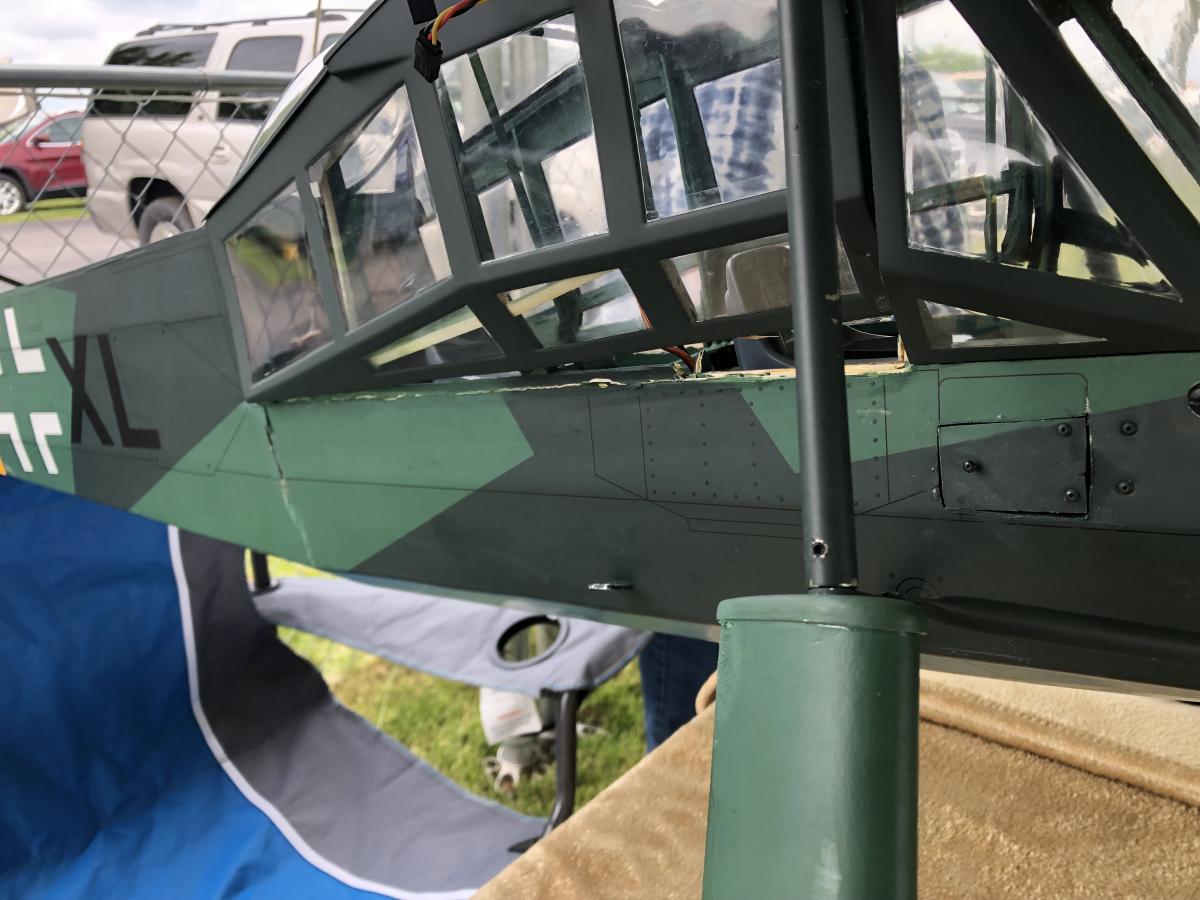

              #46

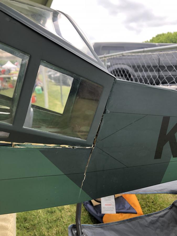

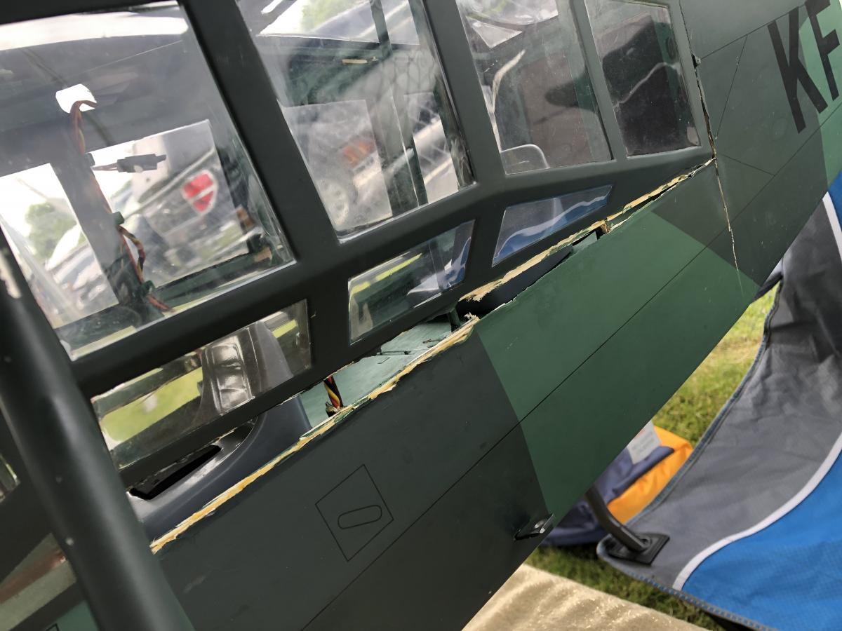

              So, I took the repaired and re-test flown airplane to the Windy City Warbirds & Classics event last weekend. I had lots of interest in the airplane and everyone was anxious to see it in the air. I got a 5 or 6 minute flight on it and landed. Upon taxiing in, I found that something looked wrong, and found that the cabin area had once again broken away from the fuselage. The joints I repaired and reinforced with carbon fiber mat held, but it broke right next to those joints. I called Motion RC and we arranged a meeting early the next morning at their warehouse which was only a 30 minute drive. After review, they agreed to replace the fuselage and associated parts (I didn't want or need wings, they were fine), so I took all my gear out and left it with them, so they could dissect it as needed. I really appreciate their FANTASTIC CUSTOMER SERVICE! They are genuinely interested in putting out a quality product and I want to assist with that as much as I can.
              So, I'm starting to re-assemble the airplane, but looking closely at what can be done to help this not happen again. I am concerned that any hard landing will lead to this problem (you shouldn't land hard, I know!). So I am looking at adding some kind of support around the threaded rod that goes into the top of the side of the fuse to support the landing gear. This is where all the stress is being sent from the landing gear. So, trying to engineer something to make that better and stronger.. I am also looking at modifying the main landing gear strut. The spring action on this part only allows for 7mm of movement by the spring-loaded gear strut. I want to increase this and to also reduce the amount of pressure required to allow the strut to move (spring tension). I am pretty much set on creating a operating landing gear much like the full-scale version. I will have to make fiberglass strut covers that will telescope into each other, but that is not hard. I'm working with Dennis Crooks at Robart to see if they can make a strut for it. Stay tuned.

                #47
                Here are the pictures of the damage...

                  #48
                  Wow that is a bad separation on the fuselage. I haven't had that issue after some 25+ flights but I'm going to keep a close eye on it. Terminater007 had posted a picture of added support at the exact point you mention, reposting his picture here. I've been trying to work up something similar to this mod. And i'll be tuning in for more scale landing gear....would be awesome if Robart can do.

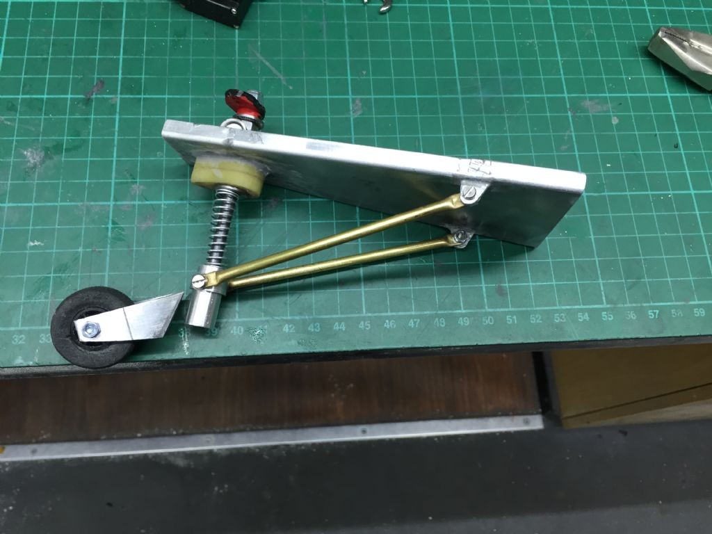

                    There's a thread on RCME forums by Shaun Watersand he made up scale struts for this same plane..
                    https://www.modelflying.co.uk/forums...?th=100505&p=2
                    pictures from website

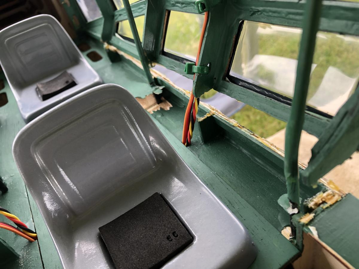

                        #51
                        3RedPapa: I also saw that. That mod would help make sure the load goes to the entire area of the attachment, but that really does not reduce the load on the formers where the cabin area is. They are only 1/8" ply, and a very cheap, lite ply as well. I found that the metal rods that go down into the bottom of the fuse from the wing tubes have large wheel collars on the end of them under the servo tray to help support the shock placed on the upper part of the front cabin on landing... In my case, the collars were not tight enough and the rods slipped out under stress... otherwise they would have caused the plywood on the servo tray area to break... I am also going to look into improving that somehow, or maybe adding two more rods that go all the way through the bottom of the fuselage. I would remove the covering and balsa there and add a Carbon Fiber plate that would be glued to the bottom of the fuse and connect to the plywood formers and framing. The rods would go through them and be held in place with a nut or something so the CF plate and fuselage structure system absorb the show and stay intact...

                          #52
                          Got it...if you do use CF to reinforce please post pictures. And looking forward to any development on the struts.

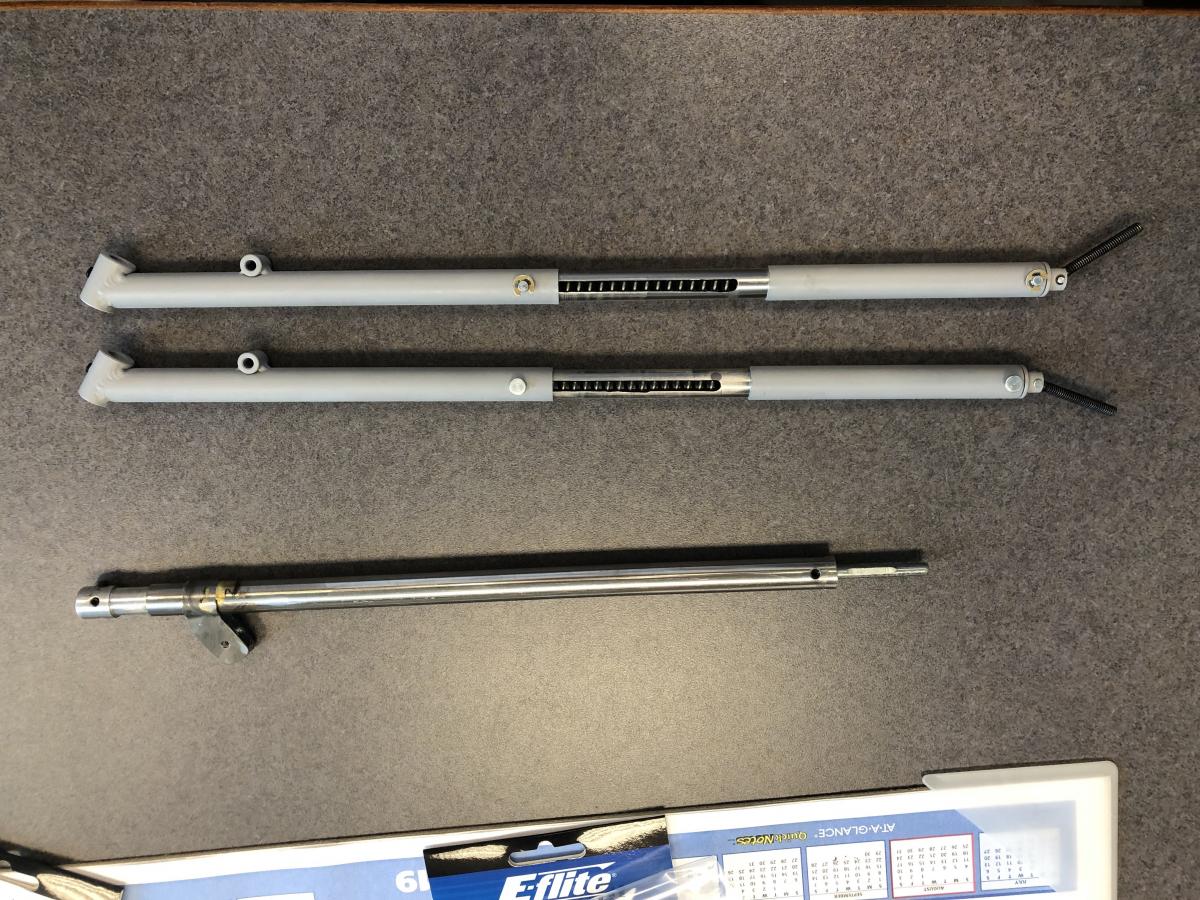

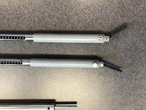

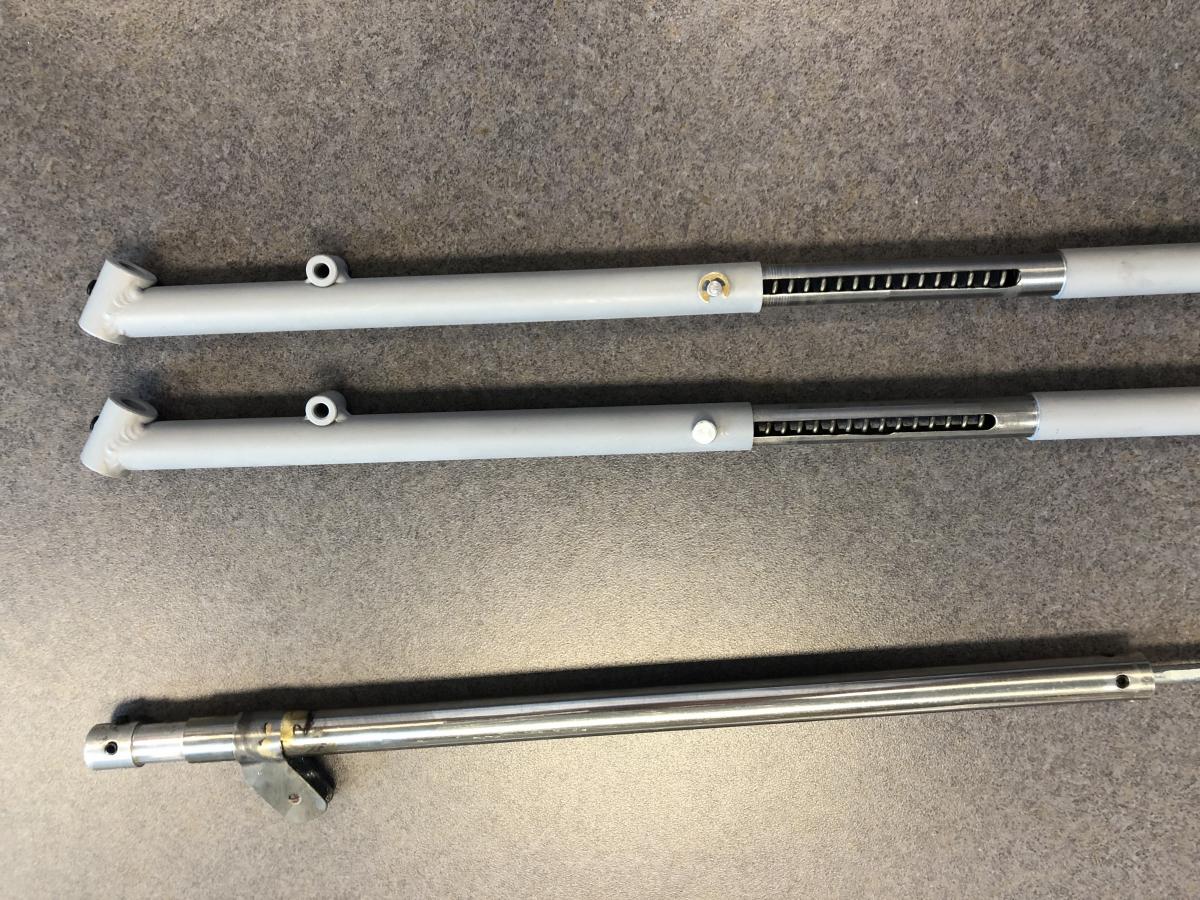

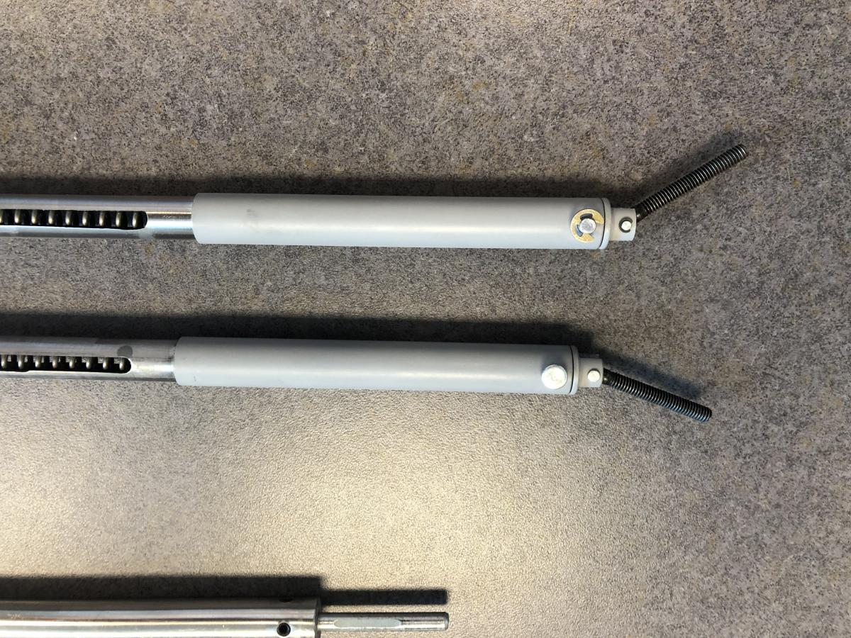

                                          #60
ID:	210240Click image for larger version
ID:	210241Click image for larger version
                                          I just received some custom made struts from Dennis Crooks at Robart. These are the gray colored struts in the picture. The main difference is that I have about 50mm of travel on compression of the strut, instead of the 7mm travel,and that the spring is replaceable, allowing me to change it out if I need more or less tension. He modified the top section so that it will still attach to the upper strut leg (the one that mounts to the fuselage near the wing), but it now can pivot. All that is needed is to modify the two bottom strut braces so that they can also pivot at the fuselage mounts. They will attach to each side of the landing gear brace mount that is just above the axle mount on the gear. The axle is now a straight piece of rod instead of being bent. Now to start work installing it... more to come!
