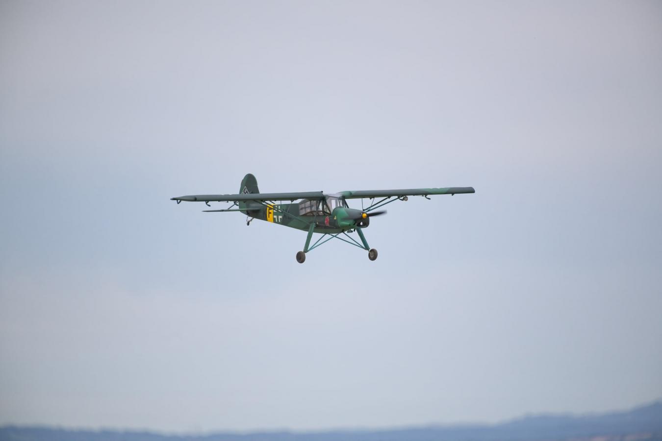

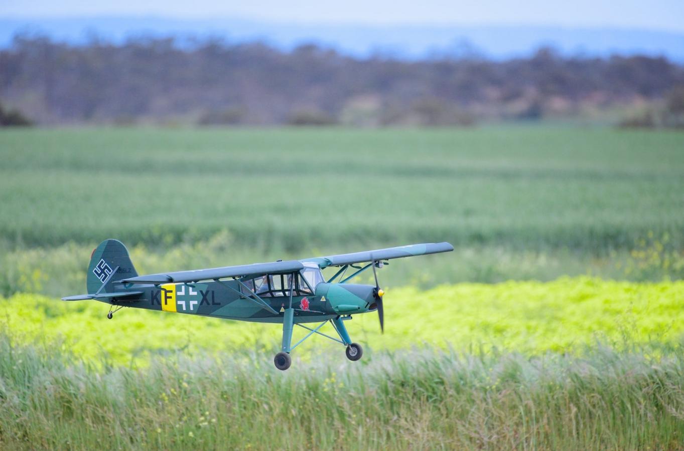

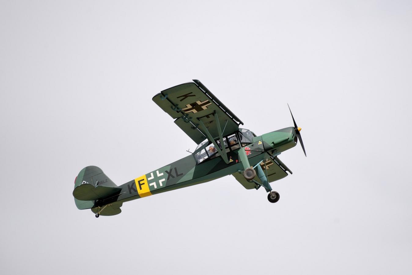

                              #74
                              Some Flying shots of my Storch from last weekend :)
