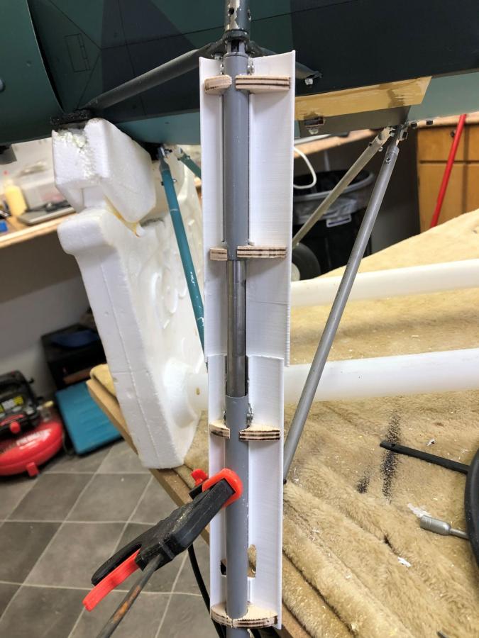

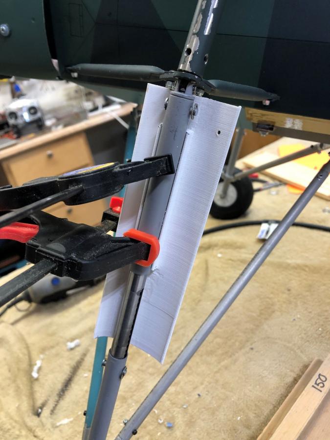

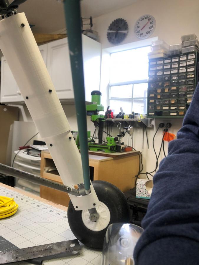

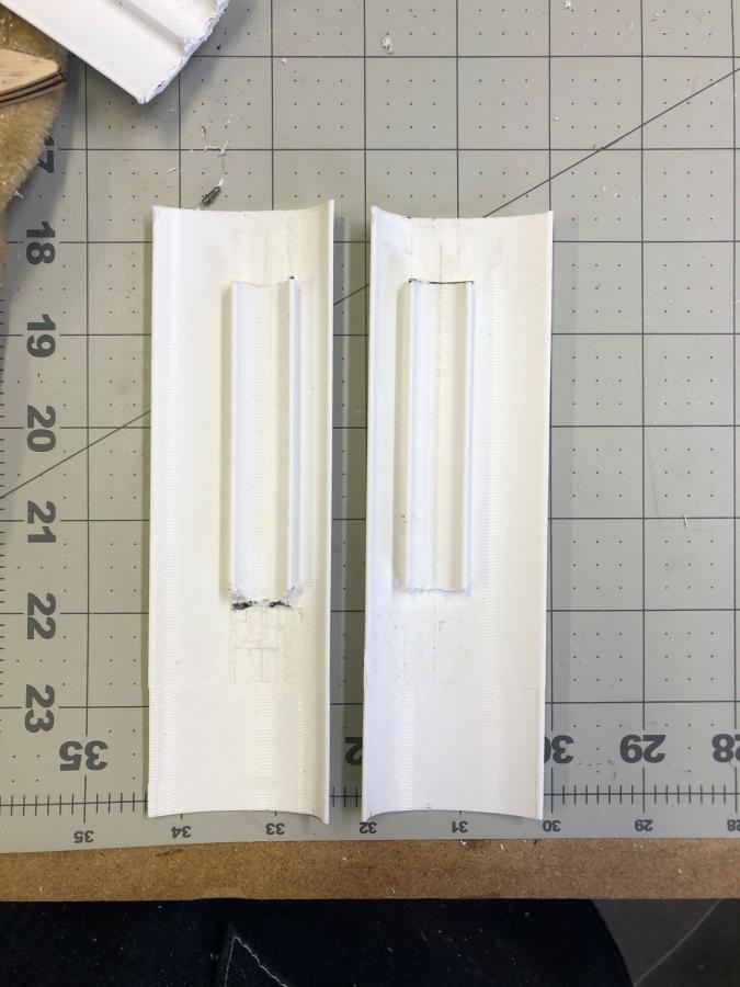

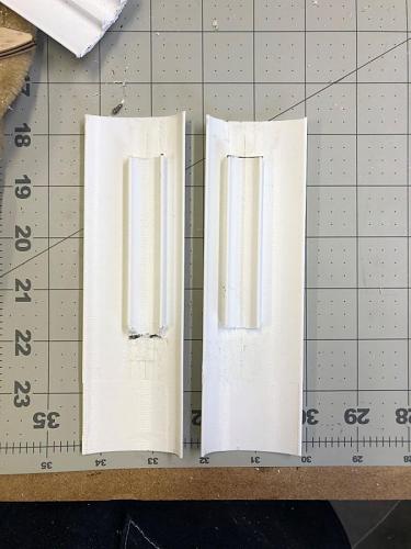

                            I finally have the 3D gear fairings thanks to Damon Atwood! Here are pictures. I plan on sharing this file with anyone who needs it along with Robart so they can include it in the Gear Upgrade kit. Click image for larger version
ID:	256662Click image for larger version
ID:	256663Click image for larger version
ID:	256664Click image for larger version
                            I have the airplane now ready to test fly. Gonna fly it without painting the fairings to see how they work and hold up first.
                            Also wanted to post that I have hear back from Robart Mfg. They just started back to work on May 18th. Dennis Crooks was going to speak with management about determining the cost for the gear and time frame for manufacturing. Once this is done, they will consider taking orders for them.

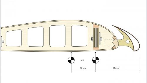

                              Finising up my newly purchased Storch. The new kit has a plywood tool for setting the cg. With all of the discussion on cg that should solve the problem. Also there is a plywood guide for the flaps and ailerons setup which should help. With a Zenosh G38 the plane balanced just a bit low in the nose, perfect. One complaint is the number of the landing gear brace struts #1 and #2 should be reversed. WHOOPED my butt trying to get the gear to fit properly.
                              • TonyF3A
                                WWII Giant Scale/Jets
                                • May 2018
                                • 50
                                • Muncie, IN
                                #115
                                Squidman: Could you post a picture of this "plywood tool for setting the CG."? The online manual does not say anthing about it. is it still showing 110mm from the LE of the SLOT?
                                • axerhand1976
                                  • Mar 2014
                                  • 89
                                  #116
                                  seems to me that if the plane needs alot of lead weight up front, might ne better to just use a bigger engine? i would rather have usefull power than dead weight. just my 2 cents.
                                  • TonyF3A
                                    • May 2018
                                    • 50
                                    • Muncie, IN

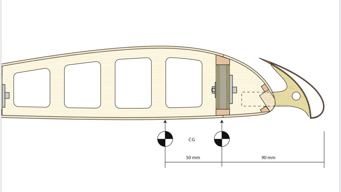

                                    #117
                                    Darrell:
                                    Thanks for writing! I have a DLE 35 on it and I think it is fine with that. I had to put 4 pounds in it for balance, but I am not completely sure about the balance point still. I have been working with a guy in Europe that sells a 1/4 scale and 1/3 scale Storch and he says the balance point is very wide. He sent some drawings showing his CG range. I attached it here.
                                    The main thing I found is that the Slots are not in the correct position, based on his drawings. I think the airfoil might be fine, so my next step is to re-locate the slots and give it another try... Click image for larger version
Name:	Pallino Fieseler Storch CG.jpg
                                    • TonyF3A
                                      • May 2018
                                      • 50
                                      • Muncie, IN
