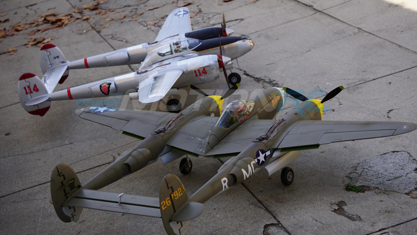

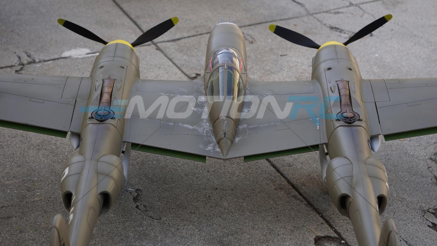

Looks awesome, very nice detail.Originally posted by Twowingtj View PostJust about finished with Devil's Angels Squadron #133, Irish Angel. Big Thanks to Callie Graphics for the unique items for this bird. Now it's just waiting for spring......
