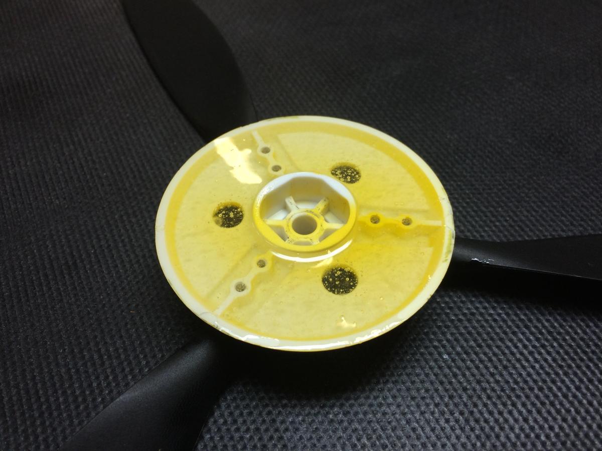

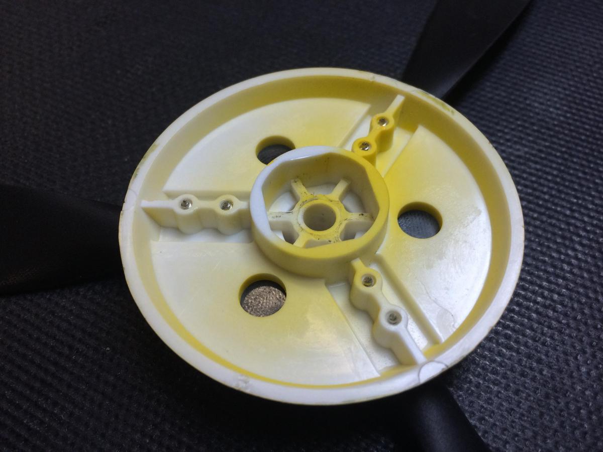

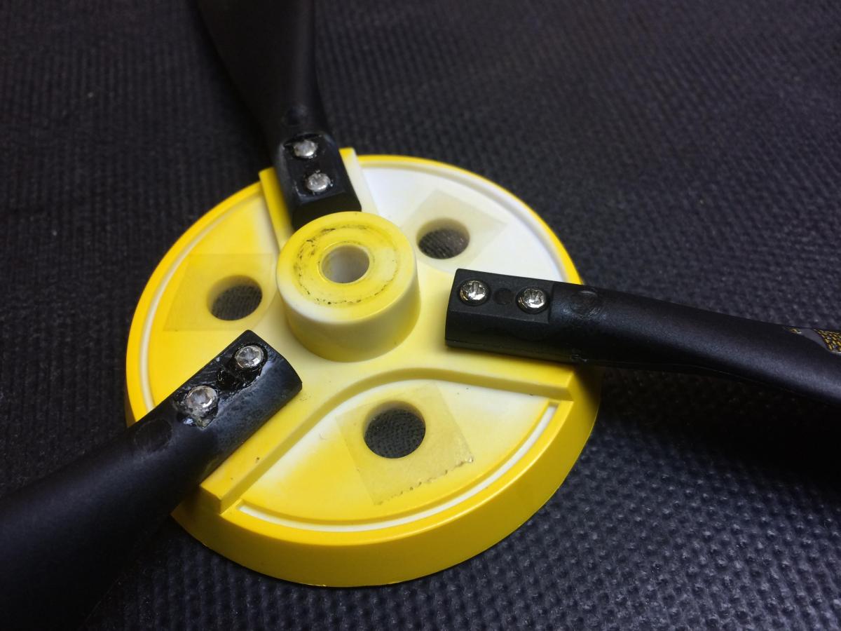

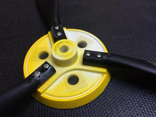

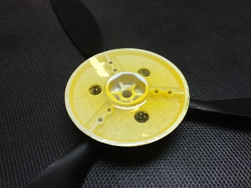

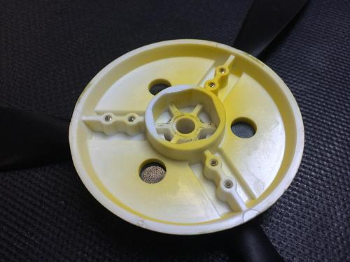

                                  • Here's the epoxied back plate, taped over holes on the front side, I realize that's more weight but I'll take the weight over loosing the plane any day.

                                      • What we need is these backplates made out of aluminum. I've had both sides break at different times. One tore up the plane a little the other was just a pancake with minimal damage.
                                        • I just don't trust multi-piece props, I've converted most my planes to one piece.
