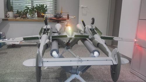

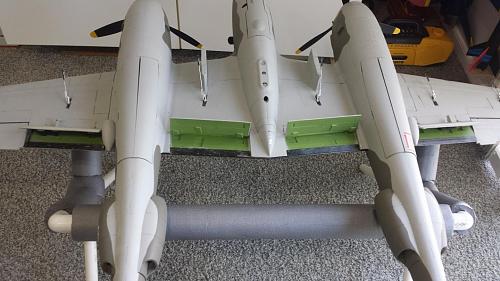

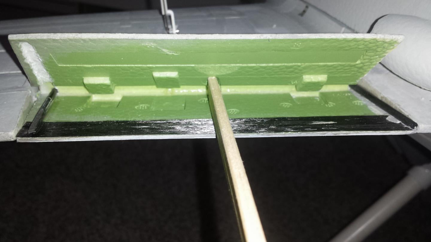

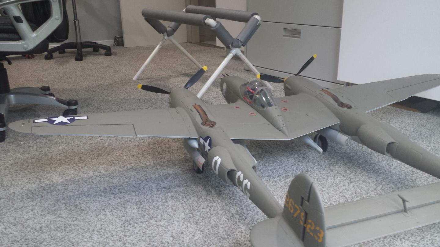

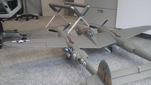

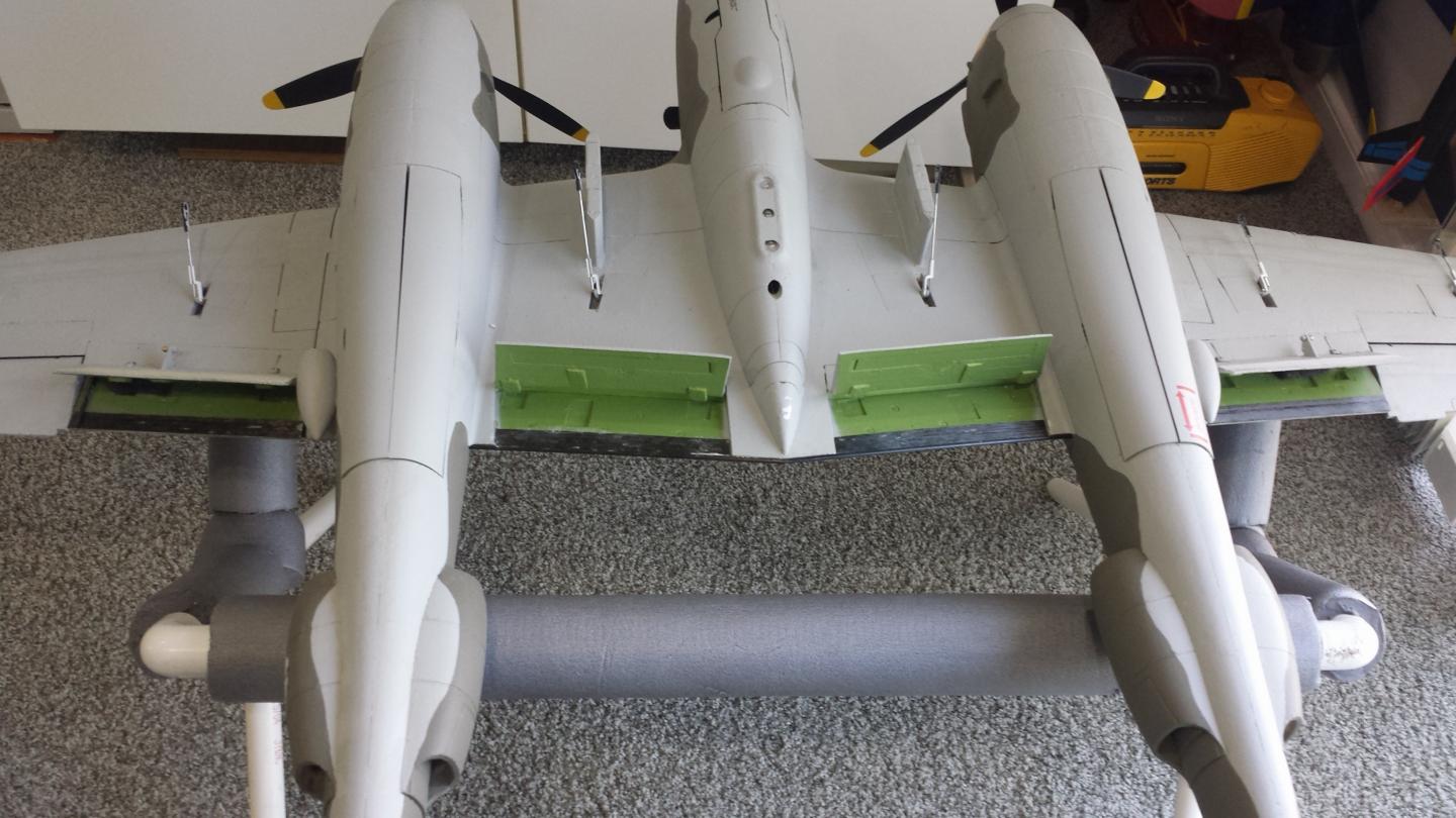

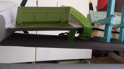

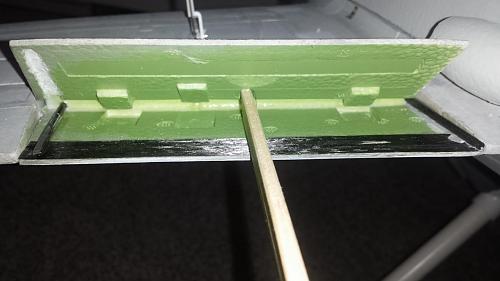

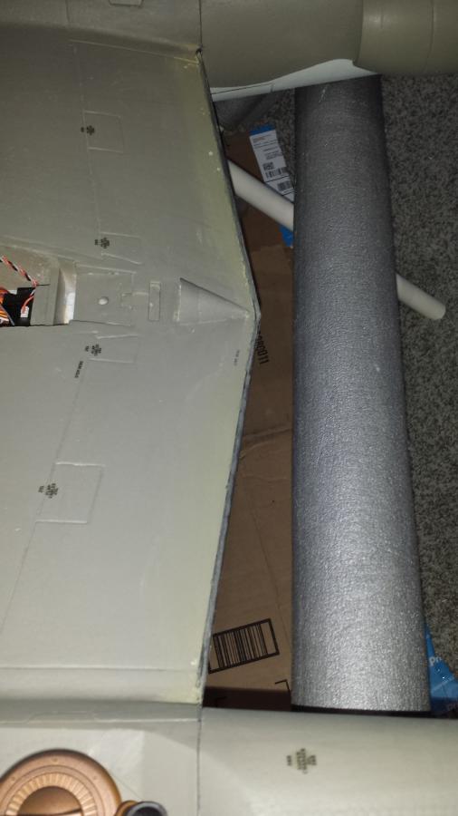

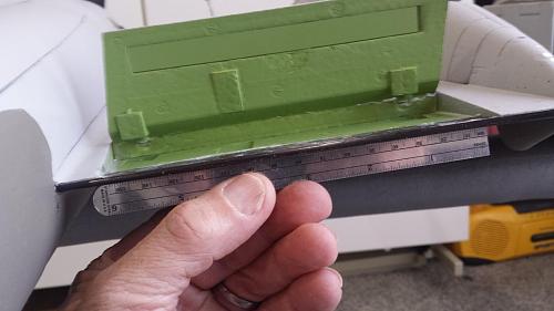

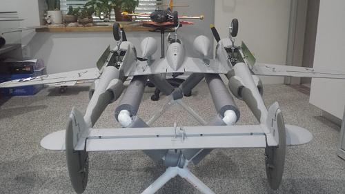

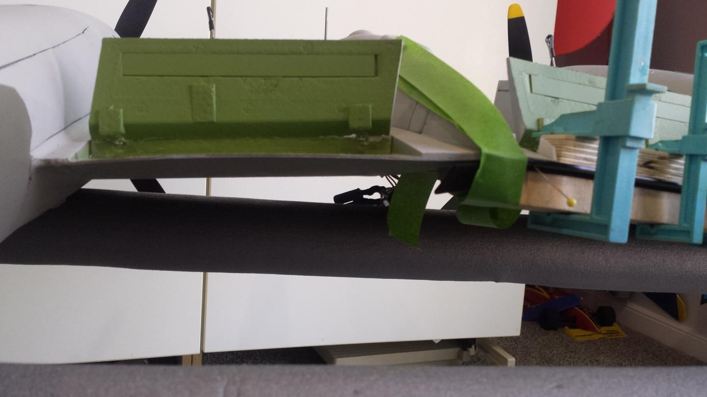

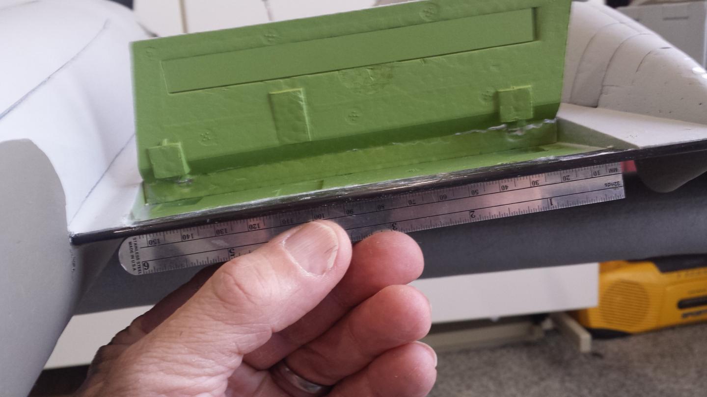

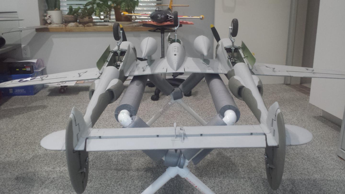

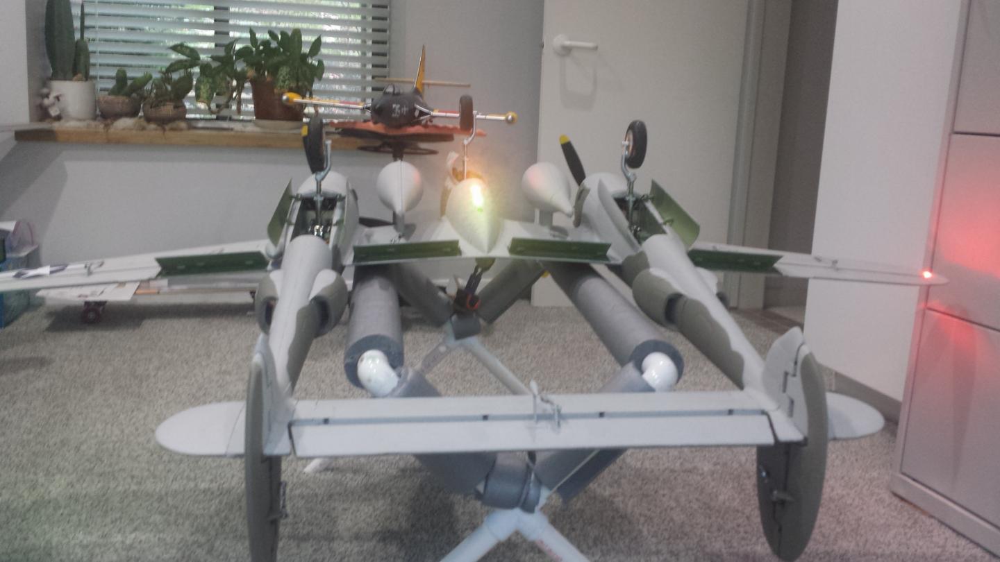

    So had the hard landing a few weeks back. Been working on the issues from the crash and the original build. Pressing beyond the crash damage was the wing warping and alignment at the root. I used CF rods and strips along with epoxy and some persuading blocks to get things straight. I'm now happy as everything is straight and I have a smooth line on the trailing edge.
    here is the list
    New retracts
    new springs with higher compression on the mains (old fms springs too soft, tail was sagging)
    refit gear, grind to get more clearance and epoxy and cloth in the gear bays to add strength (more room makes gear more reliable)
    fix gear doors (minor)
    new props and decals by callie, light coat of lacquer to seal
    wing straiten and align plus flap fix
    some body work here and there
    made some changes to the radio set up, tune flap mix with down ele , add a little up ele with gear down
    will move cg back a little to see what I can get away with.
    She is ready to re-maiden, most all of the trims are now void so it will be a real re-maiden Click image for larger version
