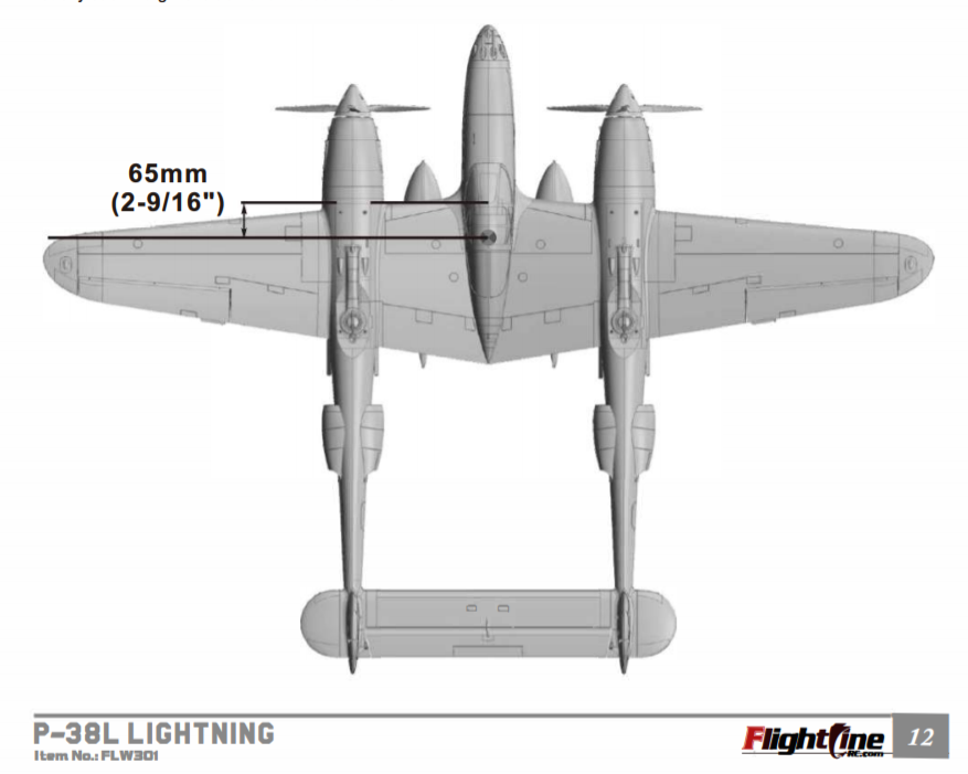

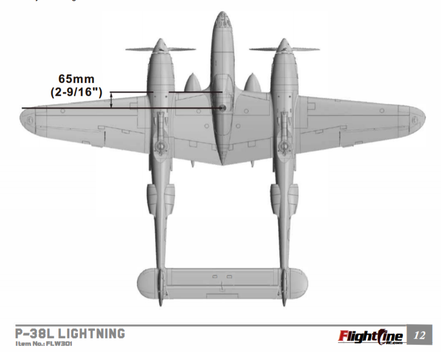

                              Just went back to the build video. There it states "65mm-75mm is the recommended balanced with the model upright and the landing gear down". Going closer to 75mm will definitely help, I'm going to recheck that value and see what I get.
                              Update: with the model upright and gear down I get 72mm for the CG. Adding the drop tanks changes to 74mm. So I'm at the aft portion of the recommended range without adding any nose weight.
                              I also had troubles to interpret the CG drawing in the manual.
                              With 2x 2600 as far forward as can get, I measured with gears up, and at the beginning of the wing after the radius at the center fuselage. I received a CG of nearly 80mm and was pretty much confused. I don't have light-weight Lipos, so I couldn't understand it. I suspected that my CG measuring was wrong and tried to get information in the forums.
                              Above mentioned information helped a lot. LG down and measuring the CG at the outer fuselages brought me to 75mm.
                              Can anybody describe the change of her behavior between 65 and 75mm? Is she getting tail-heavy at 75mm? Some planes are pretty sensitive to CG change of 10mm.
                              I could also try if my 2x 3000 packs fit in and check CG. They are a bit older and therefore not my preferred packs for maiden flight, but would help bring CG forward without adding dead weight.
                              • I am using 2 x 2500mah orange admiral 4S batteries, and they sit all the way at the back of the tray. In the middle of the tray the plane was definitely nose-heavy, because flight-testing confirmed it: when the model was inverted it dove sharply towards the ground. Now, with the batteries at the back, when I go inverted I just need a touch of down elevator to maintain level flight inverted, which means it is balanced correctly.
                                Now back in my hanger, with the gear down and the batteries in place at the back of the tray, the measured balance point is 25mm in front of the main spar line on the wing (the crease in the foam), using my fingers underneath the wing on a hard point.
                                Try balancing your plane there and test-fly it to see how you like it. That is where I like it.
                                Keep in mind that with most MRC planes the recommended CG is a little too far forward, which is a good starting point. But if your plane is too nose heavy you'll have trouble with the flare during landings (like landing a brick), and also you'll need some up-trim to fly level.

                                • Thank you for your support! Meanwhile, I checked CG with my two old 3000 packs --> 67mm.
                                  What do you mean with " the main spar line"? Where is the cease you refer to? Upside or downside of the wing?:Confused:
                                  It's hard to understand the location of your CG, as you use a different reference point. As far as I understand, putting your batteries all the way back of the tray should bring you to a CG which should be far beyond the recommended 65mm, and your CG is flight proven?
                                  • I fly with 2500-3000 Admiral packs and I have them as far back as both can go... No CG measurement. Sorry :Straight-Face: But she flies great. I will say, I have MAX deflection on all control surfaces, just like all my warbirds, BUT, I use a lot of expo.... 45 AIL, 65 ELEV, and 20 RUDDER. This gives me full control in emergencies, but tames everything down. My buddy says the elevator is mushy to him. It does require more stick input, but you really have to try to get a high speed stall or over control.... I have dialed it down on a few birds, but the elevator will kill you, especially if you are slightly tail heavy.... One last thing. The "neutral" setting for the elevator on the 38 is a few MM about level. Hope this helps a bit!!! :Cool: Jerry
                                    • I guess we all interpret things a little differently. To me, it's crystal clear. The "main spare line" is generally the thickest (from top to bottom) of the wing cross section. This is usually about 1/3 of the distance from the leading to the trailing edge. In the picture below, the main spar line is that line (or crease) just below the CG line that's drawn for our reference. The instructions use a measurement from the leading edge near the wing root (next to the fuse) and 65mm to the rear of that. The "wing root", as depicted in this picture, is at the end of the straight line of the leading edge of the wing, where it begins to curve forward into the fuselage. Themudduck is using a slightly difference reference point because that crease is easier to discern while some people have a hard time figuring out where the straight part of the leading edge stops and begins to curl. So, he's saying the CG is 25mm in front of the main spar line. If you look at the picture, the next line (crease on the wing) that the CG is just "in front" of, is quite clear. Nevertheless, whether it be XXmm from the leading edge or XXmm in front of the crease, we're talking the same thing. Besides, the CG in the book is a recommendation and a starting point. Actually flying balance point can vary from one pilot to the next dependent upon their feel and comfort zone. I used Admiral Pro 3600's all the way back and the plane flew fine. You want nose heavy over tail heavy whenever possible. Tail heavy can be dangerous.
                                      Click image for larger version  Name:	Annotation 2019-07-04 102036.png Views:	0 Size:	138.7 KB ID:	204413
                                      • Guys, by "main spar line" I was just trying to refer to something that would easy to see - when you look at the plane looking down , like in the picture XViper posted, you can see a straight line on the top of the wing going from wingtip to wingtip. That's what I was looking at. Its not the actual spar, or the thickest part of the wing, its just the molded line in the foam.
                                        Since its a line it makes a handy reference point. Well, that's what I thought, I thought it would make this easy... but sorry to confuse everyone. With the batteries back in the tray, my plane balances 25mm ahead of that line. Which... according to XViper's drawing, would match the 65mm back from the LE of the wing at the inside of the nacelles (which is really hard to pinpoint) according to the drawing. So if 25mm in front of the "spar line" = 65mm behind the LE of the wing at the inside of that motor nacelle, then my plane balances exactly where the manual says?? Hmmm, interesting. I didn't read the manual. I flew the plane and came up with that on my own! I guess I done good! LOLLOL
                                          That's how I understand the manual too, LE to the nacelle, not the fuselage.
