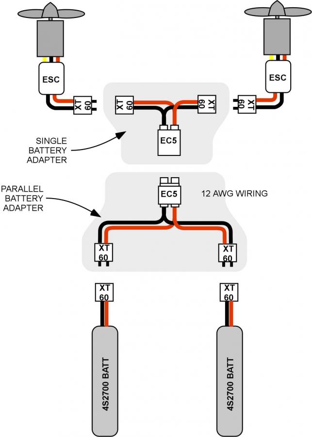

                Slight twist to an old topic: I would like to run two batteries in parallel to both motors so that I won’t have to worry about one battery going bad and causing an asymmetric thrust problem. The attached image shows how I plan to make an adapter to accomplish this. Basically, I’m planning to use a “single battery adapter” as described in other posts in this forum (i.e., an adapter that allows the use of a single six-cell battery) in combination with a parallel battery adapter. Does anyone see a problem or have any experience with this type of setup?
ID:	307997 To me you have too many connectors and each one is a failure point or a source of resistance and heat. Plus the EC5 would have to flow all the power for both motors. I would do what I’ve drawn. The bridge wires could be thin, 13 or 14 gauge since they are not directly supplying current, more for emergencies...

                    #4169
                    Hmmm... Nice, simple approach. I need to think through how I would physically splice the crossing wires in. I'm a little more confident soldering wires to connectors than I am in soldering splices into heavy-ish guage wire.

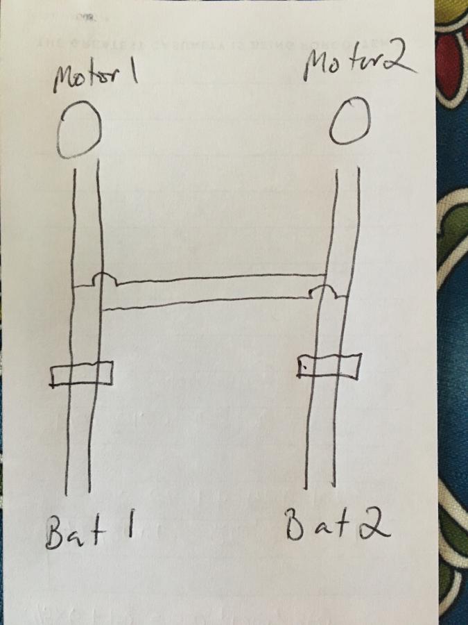

                      #4170

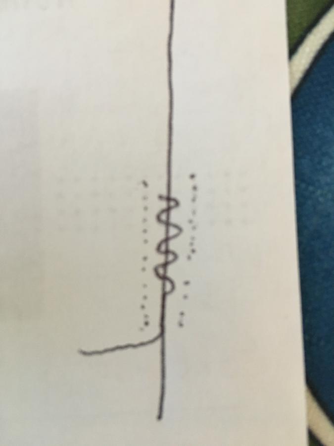

                      Testing my drawing ability today. Strip a 1/2” or so of insulation from the main wire and wrap the interconnection wire around it. Solder and then put heat shrink over it... You don't cut the main wire at all.

                        #4171
                        Thanks for that, Evan! I'll do some soldering practice with some segments of scrap wire before do the real deal. Would you suggest using flux paste on the joint before soldering? I always have a problem getting the molten solder to soak through the wire strands. I'm using a 45W soldering station with adjustable temperature, and a broad, flat tip. I probably should go to a soldering forum somewhere and ask, but since I've got your attention, I thought I would ask...
                          • 5395
                          #4172
                          While I do have paste I seldom use it. When people say they can't get good solder flow it's usually not good solder, like many things we are getting things from the east that are not the quality we're used to. Sometimes its we aren't using a good enough iron or we aren't getting good heat conduction but usually from what I see it's the solder... I use thin solder from Radio Shack, a specific P/N, been using it for years. Odd, the same stuff is a thicker size doesn't work as well for me.

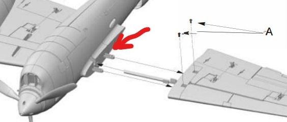

                                    Heads up....SOMETHING TO CHECK!
                                    Not on the battery connection topic, but today I discovered that the trailing plastic wing attachment point of one of my P-38's outer wing panels had broken. It snapped at its base...opposite the end from where the threaded fitting is located.
                                    The leading edge plastic attachment point was still intact...thank goodness. Grab the tip of the wing and wiggle it back and forth. The gap at the inner root of the outer wing panel should not show any play. If it does, either your outer wing panel screws are coming loose, or the plastic attachment point has broken. That's how to check for the problem.
                                    She's an old bird with lots of flights on her, but a new bird operating off grass or rough pavement might develop this problem sooner. A word to the wise...periodically check your outer panel for any fore-and-aft play or looseness.
                                    To make these fittings a bit more resistant to breaking, you might consider turning the bird upside down, remove the outer panel, and then fill the trough of the fitting near the base with a strong epoxy and smear some epoxy on the root rib area of the trough. Even better, you could put a tiny bit of fiberglass in this trough and run it 90 degrees from out of the trough to the plastic root rib. Anything to help forestall the breakage of the fittings at their base.
                                    The picture below shows the one that snapped at its base.
                                    Click image for larger version  Name:	Screenshot 2021-04-22 183449.jpg Views:	0 Size:	20.6 KB ID:	309833
                                    -GG

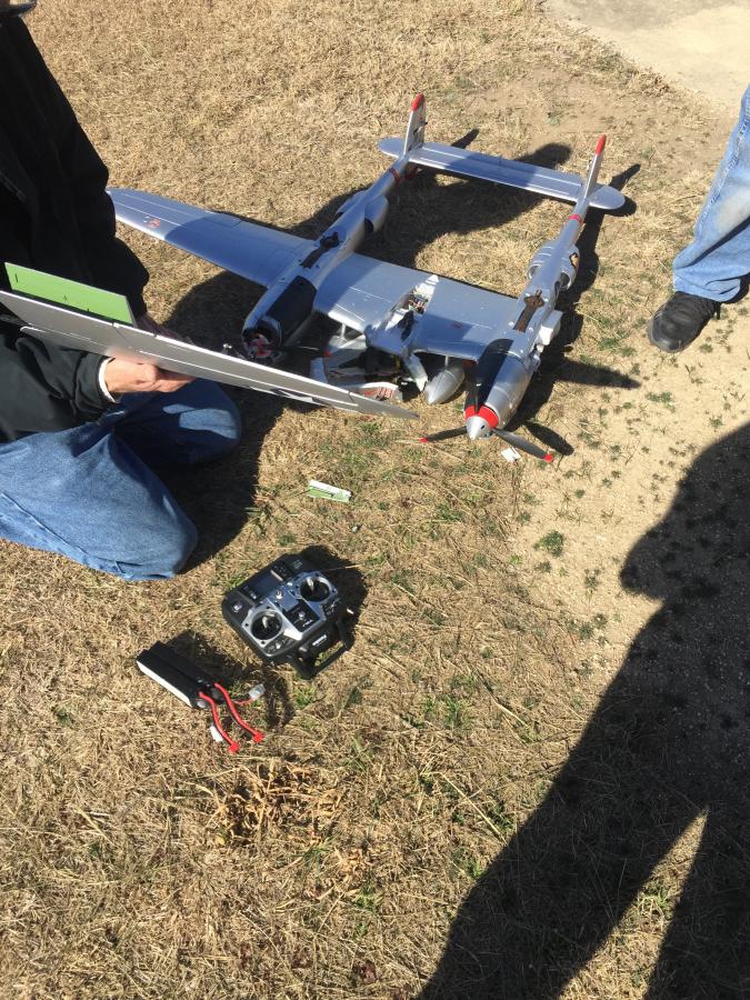

                                      -GG
                                      P.S. I also wired my batteries in parallel with connectors after one prop stopped producing power...instant death for that bird (Photo below) Can you tell which prop stopped producing power? LOL
                                      Click image for larger version  Name:	P-38.JPG Views:	0 Size:	174.9 KB ID:	309838
