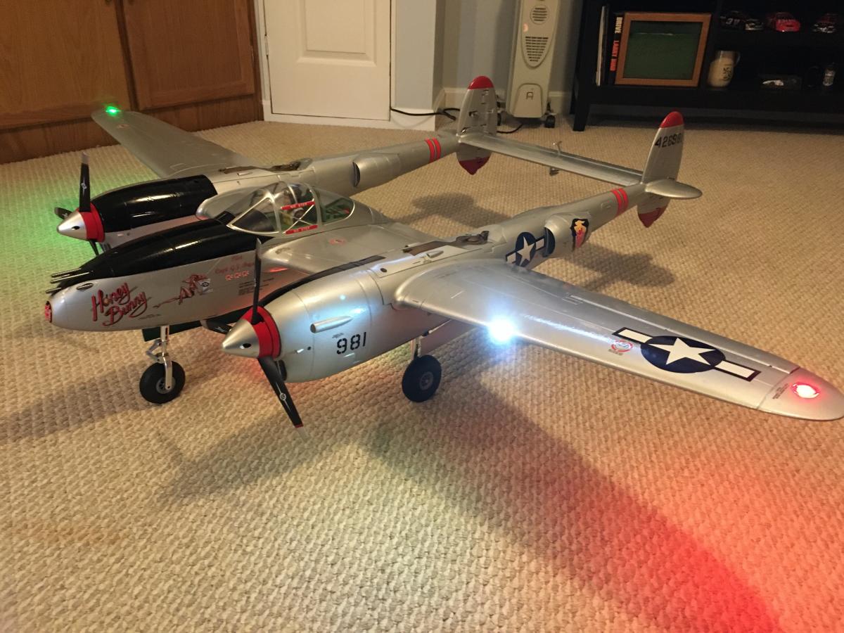

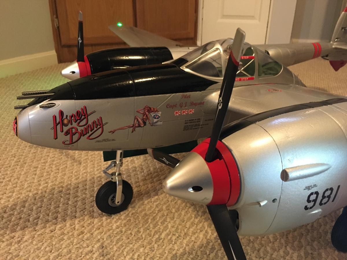

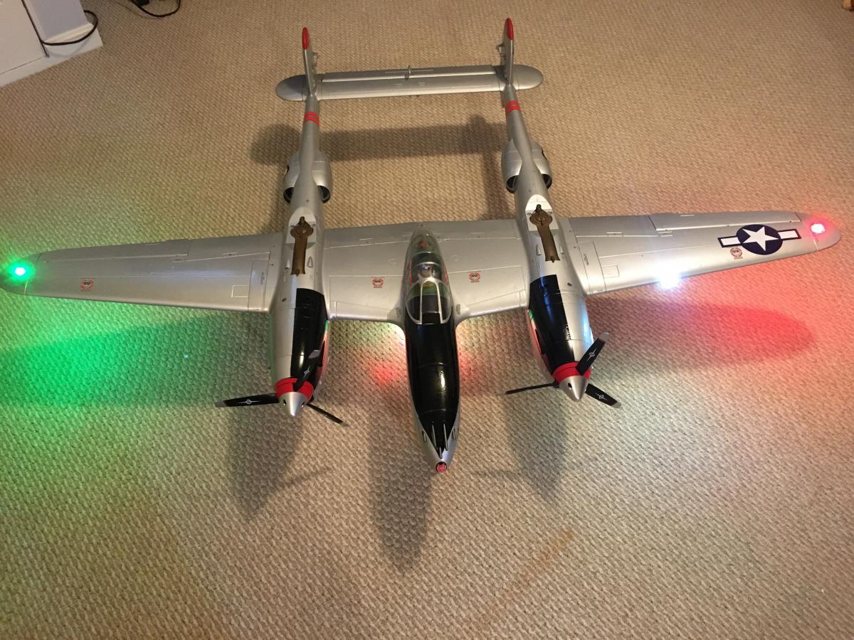

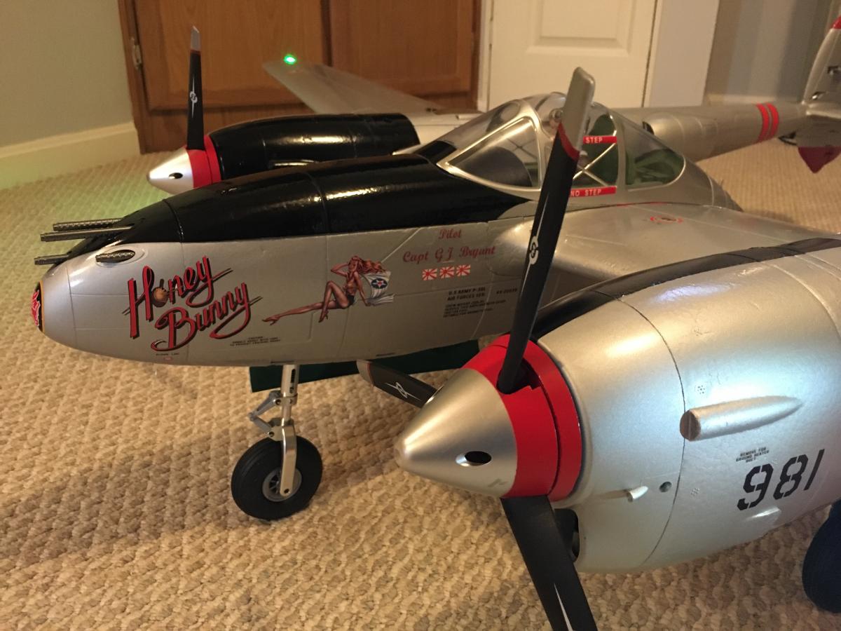

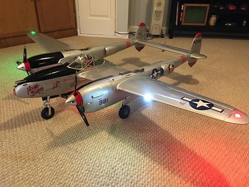

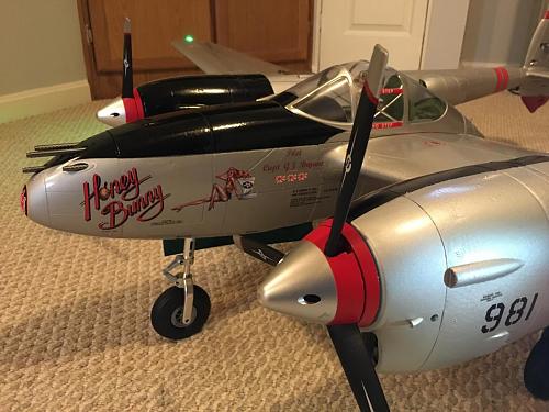

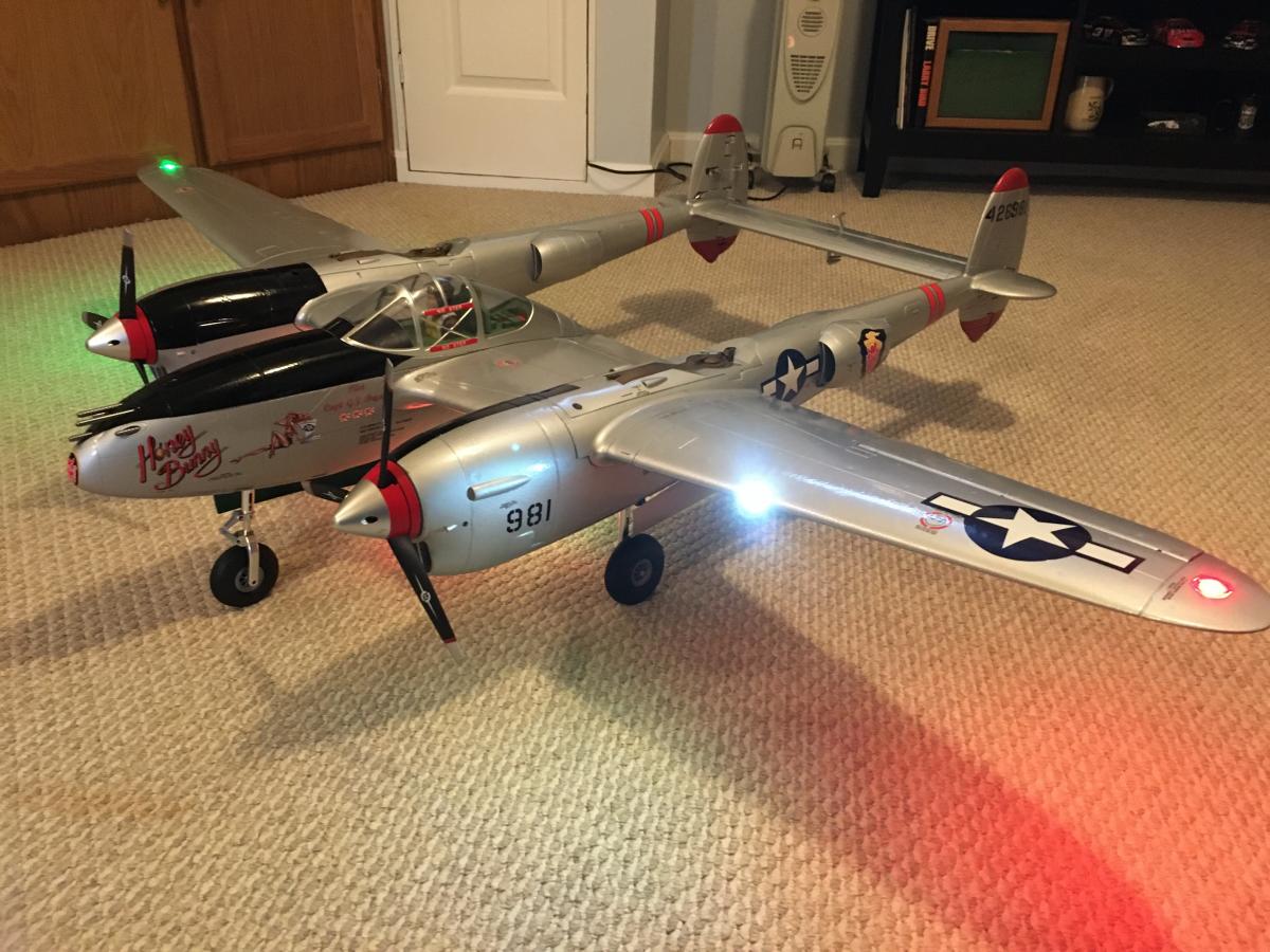

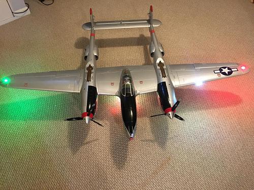

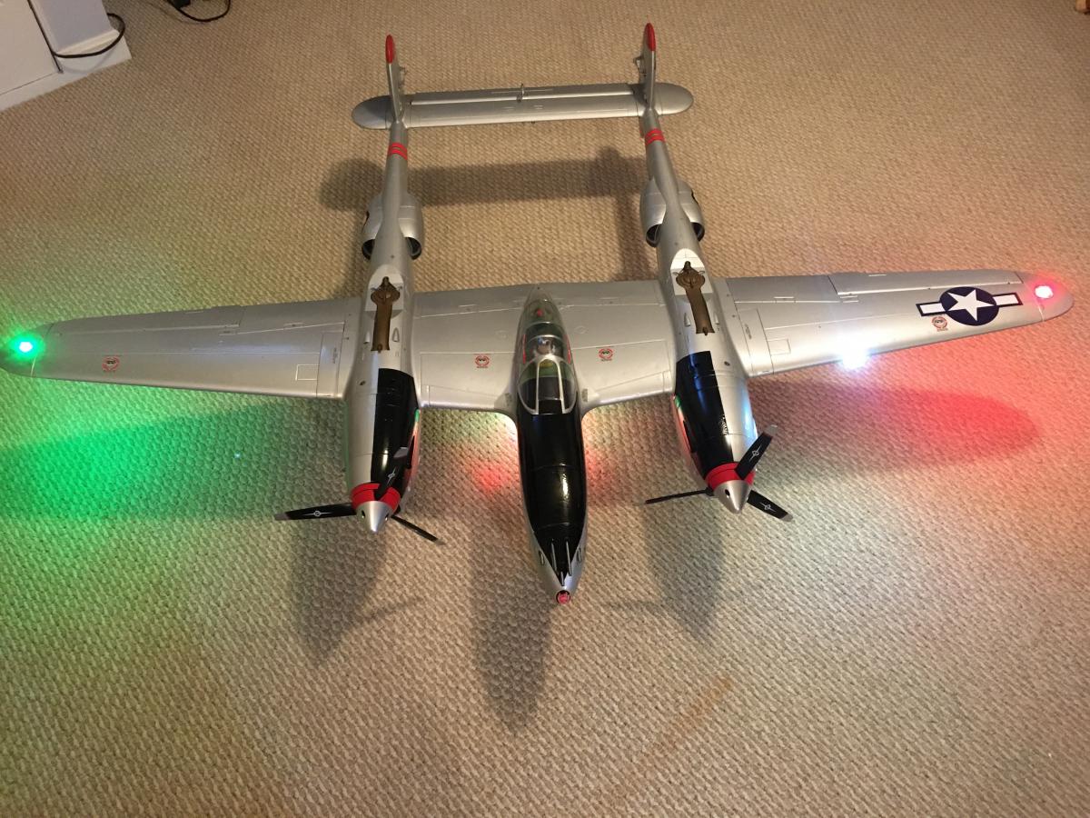

          • Another winter project completed. Up-graded the Gear Struts to include 2.75" Front / 3" Rear Low Bounce Tires. Went to 11x7x3 Prop blades to run 6S power. Installed MrRC Sound card with P-38 sounds. Also "Thanks" to Callie Graphics on the nose art. We might have some decent weather here on Cape Cod this weekend so maybe she will maiden soon. Cant wait to see this bird in the air.

                Well the last day of February gave us a gift here up on Cape Cod. Temps in the low 40's and no wind (alittle cloudy though). So the perfect day to get the Lightning in the air for the first time.
                What a great plane to fly and watch in the air. The 6's power was perfect and the manual suggested rates were pretty much dead on for trim. Needed about 2mm more up trim on the elevator to level her out. Prob cuz of the extra weight of the MrRC Sound transducers in the engine bays. Once that was trimmed out, man did she fly great. Got to admit though the sound card sounds cool, but the dual props sound amazing..... Got a good 4 flights on her and averaged 8 mins flight time on a 6S 5200mah 50C batteries. Couldn't have asked for a better maiden...
