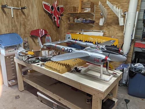

        So I'm just finishing up my P-38 and hoping to maiden it this next week. Spent most of last night setting throws, working on the flap/elev mixes, etc. I figured I'd come here and read through some of the latest postings and I'm glad I did! GG, thanks so much for posting your tips. They all make good sense to me so I plan to implement them.
        A few comments/questions that maybe the community can help me with...
        I bought my P-38 second hand (but NIB) and got a lot of extra spare parts. I have the upgraded motor kit, extra cowls, structural plastic parts, and three sets of 3-blade spinners and props, as well as the two blade spinners and props that come with the motor upgrade kit.
        My one concern is that all of my 3-blade spinners appear to be the older version (no channels). As much as I hate to throw away new parts my brain is telling me it's dumb to risk a $500 plane over a $10 part. So I'm leaning towards just tossing them out. But that said, am I safe to use them for a few flights while I wait for new spinners to be delivered? Or do they have a tendency to fail "instantly" without any warning?
        Second question...Do the stock motors/props have enough power to fly better than "scale"? Is there enough power for some mild aerobatics or sport flying? I haven't installed the upgraded motors and don't plan to unless they make a significant difference.
        Lastly, a couple of comments that may help others... I haven't read all 217 pages here so my apologies if any of this has been mentioned before.
        Check all your servos with a servo tester before doing any assembly. Save yourself the headache of major disassembly if you find out late in the build that you have a bad servo. Out of the box I had two bad servos. The first was the nose gear door servo. The plastic gears were stripped. The second bad servo, well it's kind of ironic that GG mentions the elevator servo because mine wouldn't re-center with any accuracy at all. Sometimes it would stop short or long of center and other times it would "drag" slowly back until it almost reached center and then stop. So I swapped it out for a JX digital MG that I have and seems fine. But frankly for the cost of this plane I'm pretty disappointed in the quality of the servos. I'm just praying I don't have any go bad in flight.
        I'd also recommend dressing your wire runs neatly and use some tiny zip ties to hold them tightly enough that they will fit snug in the wiring channels on the underside of the wing center section. The channels are just barely deep/wide enough for the control wires so once you add in the thicker ESC wires if you haven't kept things neat you'll have a really hard time with the channel covers. I haven't installed my covers just yet but I have a bad feeling even with everything neat and tight they are still going to be a real challenge.
        Other than these two items I've been very impressed with the model. It's my first electric twin so I was really happy to see the tips GG listed and the link to the multi motor ESC calibration video.

          There have been thousands of flights made with the original spinners. Use them but do an inspection if you have a prop strike. Stock power is great. Checking servos for operation is great to do. Plus to check that they have the servo arm on the right spline, many times I have to move an arm one (or more) splines...

                Hi Skavage,
                I fly a lot and would only get 3 months on the old / no-channel prop hubs before cracks would appear.
                If you ever notice even the slightest difference in fly-by sound, suspect the hub has a crack.
                After throwing a prop and instant roll-over, I would not use the old non-channel hubs more than a few flights.
                The stock set-up has PLENTY of power. More than you will ever need.
                The stock servos are fairly reliable. But, they do fail from time to time. So far, they have provided symptoms before they fail. Only once have I done a pre-take-off control check and found an aileron servo frozen.
                Good luck and report back.
                -GG

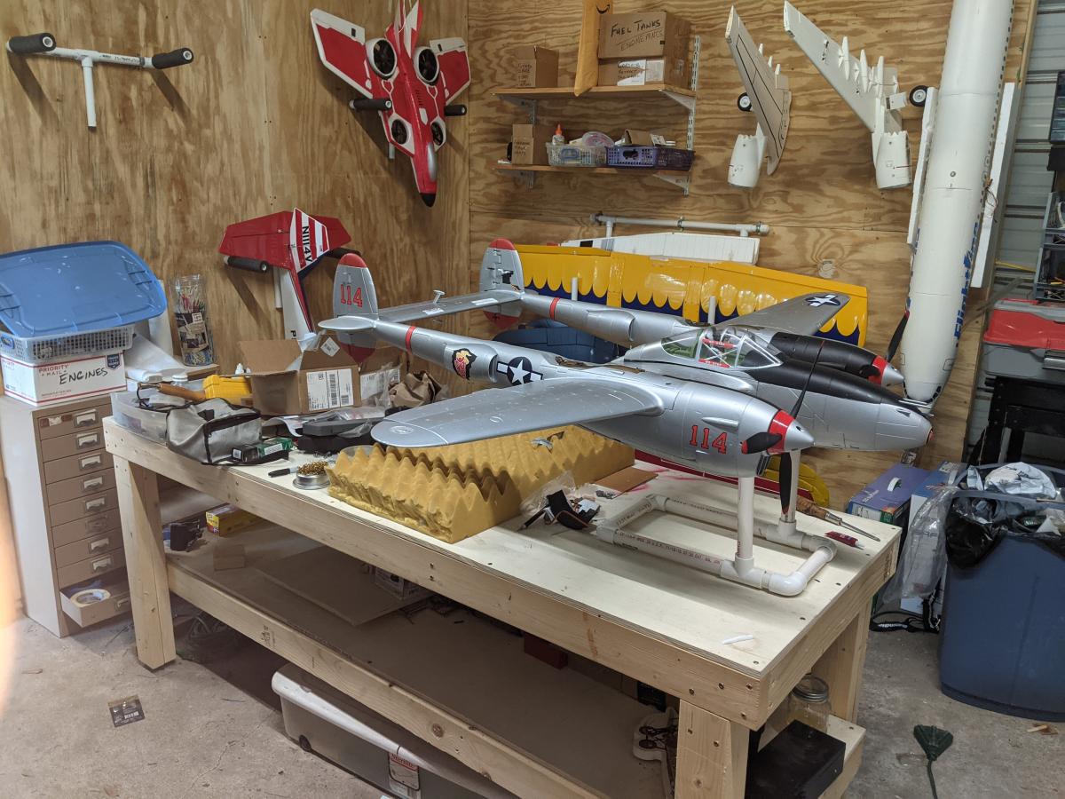

                                    #4337
                                    I removed the tail weight and my 2 Admiral 3000's are about 1 inch back from the front. Some prefer their aircraft a little more nose heavy. I balanced mine gear up with the nose ever so slightly down. With gear down it's noticably nose heavy.

                                      That will help counter the nose up pitch when the flaps are lowered. You may need less flap/elevator mix.
                                      Remember, she pitches up when the flaps go down.
