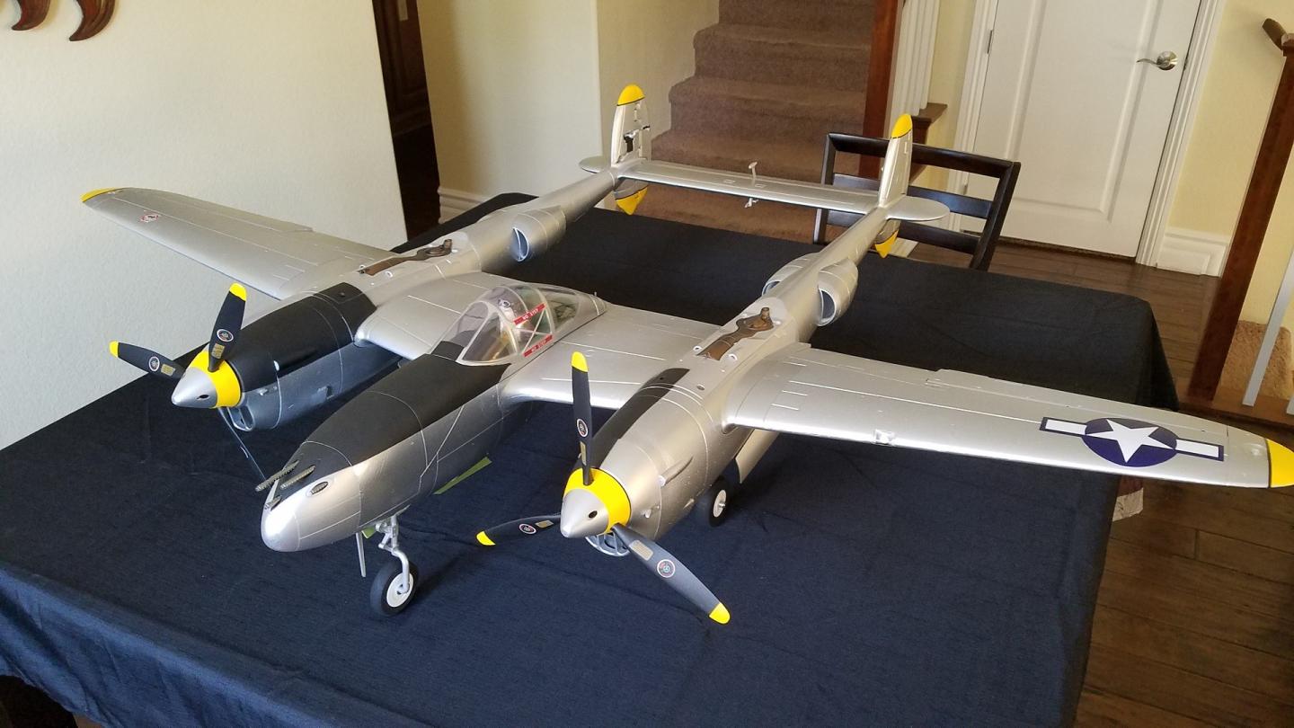

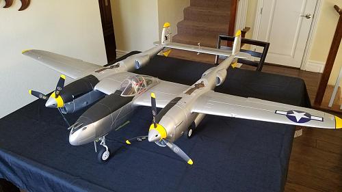

              • Alright Lightning Lovers (stealing a little literateness from Elbee), I thought I would offer up some photos of my girl all nice and dirty (as if she has seen more than her share of sorties out in the Pacific). I cannot take credit. A friend of a friend who paints for a living gave it a go and I was thrilled. Looks even better in person. Now all that's left is to actually fly the poor thing.
                • VERY nice! Good luck for the maiden.

                  • Looks great!
                    • Originally posted by Aros View Post
                      Alright Lightning Lovers, I thought I would offer up some photos of my girl all nice and dirty Now all that's left is to actually fly the poor thing.
                      Aros, she is a thing of beauty. The weathering is just right. Cannot wait for the the first check flight debrief. And if Flightline doesn't issue a new airframe soon, this is my next Warbird. Best, LB

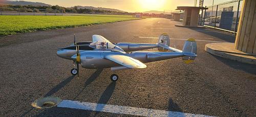

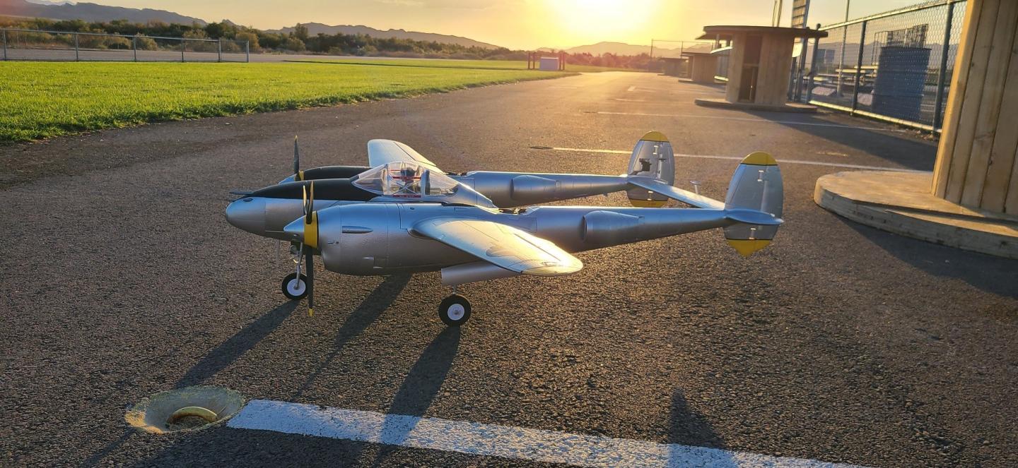

                        • I finally maidened my Pacific Silver P-38 Saturday morning.
                          Dawn flight to beat the heat.
                          Running two 3300 4s batteries.
                          This aircraft was one of the original batch pre-ordered in 2016.
                          I assembled it during the lock downs and did some trim paint.
                          The lightning is heavy for its size and so I held off flying it until I felt I had my flying skills sharpened up after a layoff from flying.
                          After reading other pilot reports on its flying characteristics, I knew how important it was to keep the speed up with this one given its weight and wing size.
                          The flight was uneventful and just need some up trim and a little bit in roll and the Lightning was flying on rails!
                          Very stable bird and easy to fly, she tracks beautifully.

                          • Excellent DA! Nice job all around.
                            A word of caution….add some extra hot glue to the elevator horn. I had one detach. That was EXCITING. Was able to control pitch with my vernier flap knob.
                            Also, consider upgrading to a high quality elevator servo. You only have “one”.
                            -GG
