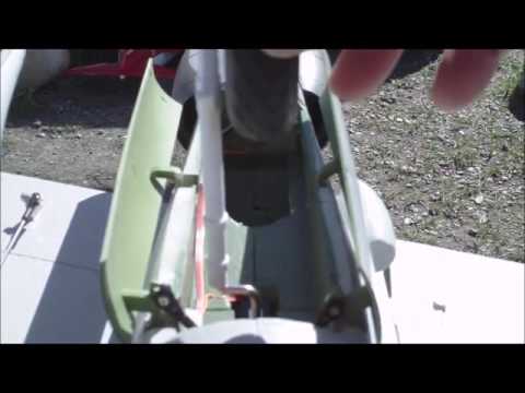

                                I finally got around to maidening her today. Beautiful fall day, no wind, but cold. First time using the paved runway at my new club. Maiden was blissfully uneventful, she flew great, just needed some trim here and there and she was flying wonderfully. Came in with full flaps and the landing was about as good as I could have hoped.
                                The second flight was also uneventful until it was eventful. On final once I breached the threshold of the runway I noticed my port-side gear was not down. I went around, cycled the gear a few times and it still wouldn't go down. I eventually had no choice but to put her in the grass gear up. Most the gear doors broke away, a broken link and one of the inboard flaps broke apart but otherwise the plane itself is intact.
                                I blame the cold weather (just above freezing) as I have had electronic retracts do that in cold weather before. I should have trusted my gut and just gone home after my maiden. Oh well. A little cosmetic work and she will be as good as new.
                                My girl tried getting video (I grabbed some stills from the footage below) but as it was her first time trying to video moving RC aircraft she is forgiven for the lack of footage, lol.
                                  This may or may not be the case. Back in the day when I had this plane, I flew it well into the cold season. It didn't seem to matter insofar as the one of the main gears got stuck, whether it be in the heat of the summer or in the cold of the fall/winter. Look at your second picture and see how the gear retracts. It goes aft to go into the wheel bay. Even rolling along on smooth runways, there is enough vibration to cause the metal strut to bend rearward. (To know what I'm talking about, take an old credit card and start to bend it back and forth repeatedly. Soon enough, when you let it go, the card is bent where you last held it and is no longer flat and straight.) The strut becomes bent slightly back, so that when it retracts into the wheel well, the top of the tire pushes against the top of the wheel well. This can prevent the retract from going full cycle and hitting the end stop and hence, it gets stuck. You can unstick it by cycling the gear switch (to deploy it) as you push the metal strut momentarily but forcefully, up against the top of the wheel well. This completes the previous cycle and allows it to deploy. I also dremelled some material away above the tire to give it more room. I did a video on how to rectify this oddity some years ago. I'll try to find it and post it. Next time you inspect a stuck retract, see if you can rotate the tire. If you can't, then it's pressing against the top of the wheel well.
                                  Anyway, once I figured out what was going on, each and every time I landed, I would brace the long part of the retract with one finger while I grabbed the strut with the other hand and pulled it forward to ensure that the strut got "unbent". From that point on, there was never a "next flight" where any retract got stuck. The nose retract was less problematic because there seemed to be more space above the tire so that a bit of bending never prevented the retract from reaching its end stop.
                                    • 5395
                                    #4438
                                    100% what XViper wrote. never an issue with temperature on FW/FL retracts but many a issue with slightly bent struts or pins not letting it complete the retraction cycle fully so it won't extend.
                                      • 8211
                                      #4439
                                      Dang xviper you just solved the riddle! Excellent sleuthing work there sir and I will absolutely make the appropriate adjustments moving forward. I stand corrected. I thought for sure it was the near freezing temps causing one of the retracts to act up. Appreciate that great info!
