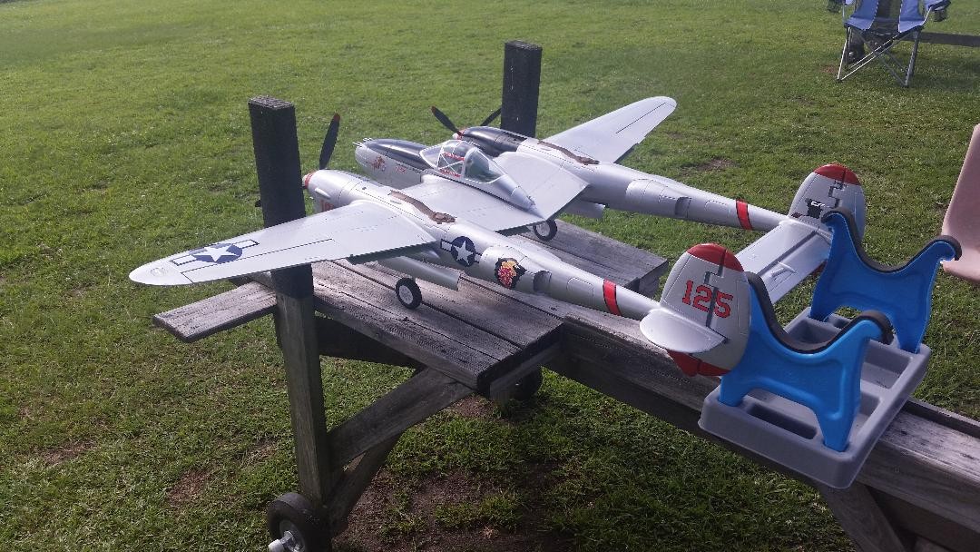

                          Great paint and write up. Using 3000 4s and CG perfect. Have flown 3 times now and at 1/2 to 2/3rds power on take off, turns, and landings, she holds true and has no stall tendencies. Probably my favorite plane. Only complaint was the wiring came too short and resulted in a birds nest of wiring. 1/2 flaps on take off and landing resulted in no lift and helped with both. Overall I'd suggest this plane even at the high point price its sitting at now. $100 more than I paid for it in March.

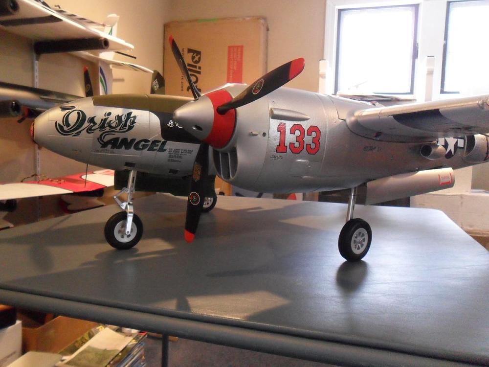

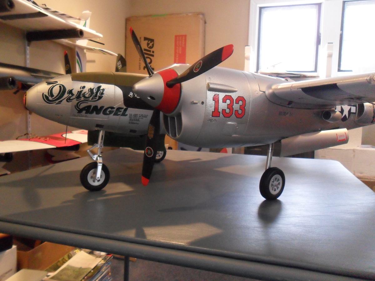

                                    • Oxotnik I'm running two Admiral 4S 4000s in mine. I removed the little bit of foam ahead of the aluminum brace and have the batteries right up against that. It CGs fine. Flys great and has no issue flaring on landings. I can fly hard for around 7.5+ minutes too.
                                      I'm running 8 channels. Not a lot of room in that aft cockpit area.
                                      Have you got the silver or green?
                                      I had Callie do this livery for me in honor of the Mrs, who got the bird for me. It's one of my favorite twins as well.

                                        Thanks for the input! You don’t have a problem putting two 4AH batts in the bay? I remember a single 6AH batt being pretty tight.
                                        I went with the OD Green P-38, like my first one.
                                        When I got my first one, I was running a DX6 and even when I upgraded to a DX9, I never changed the channelization. So, I was controlling it in a 6-channel config. I’m looking forward to having more flexibility with my up-to-16-channel OTX radio and battery-voltage telemetry. If it wasn’t needing the Blue Box to control the LEDs, I may even not use the blue box. The back bay was definite crowded on my first P-38.
