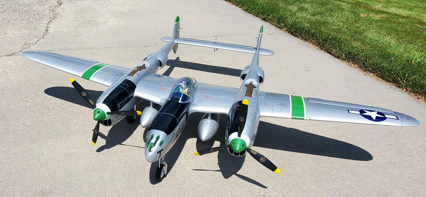

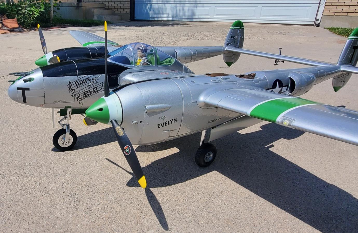

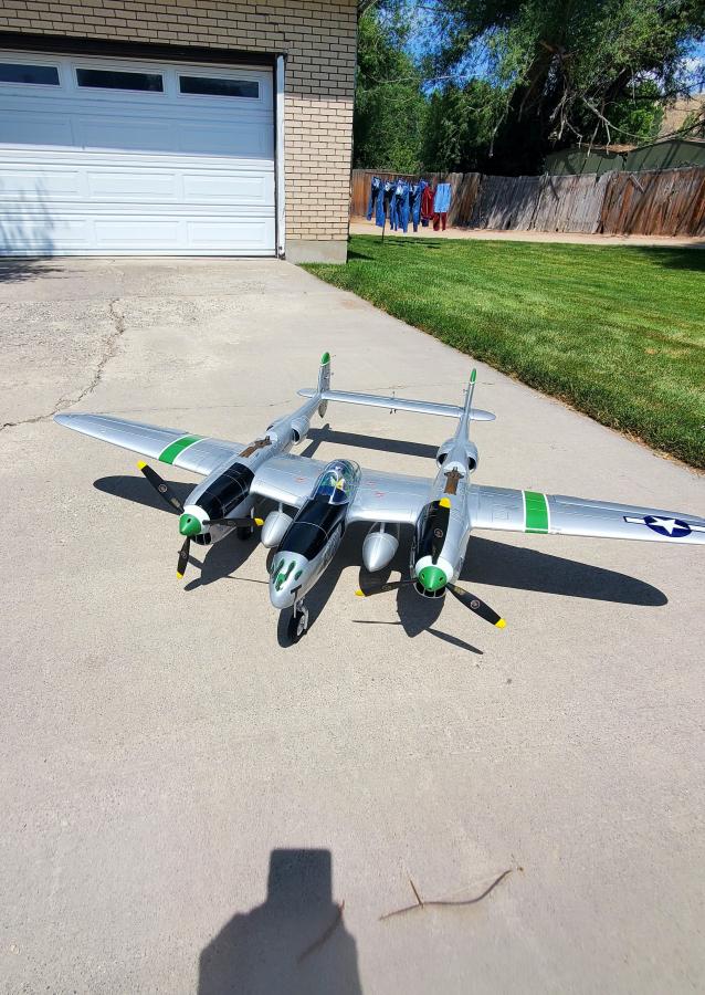

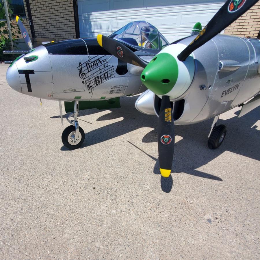

                                    Hello fellow Motion RC fans!,
                                    May I present the latest creation from the Wallsburg Warbird Works. Flightline P-38J/L as P-38J-15-LO sn#(42-104012) assigned to the 80th FS " Headhunters ", 8th FG. Stationed at Nadzab New Guinea 4/1/1944.
                                    named "Down Beat ". Had the name "Evelyn " on port nacelle. Crew chief was Sgt. Sam Scher.
                                    Captain Richard "Dick" Bong only flew this aircraft once according to Sgt. Scher. Not when Bong shot down his 25th and 26th kills to break Rickenbaucher's WWI record.
                                    The aircraft has been modified with the upgraded suspension landing gear and tires. The front gear are raked forward with 2 extra thick washers from my spares box under the back of retract. The toy looking white rim on front wheel is covered with Bare Metal Foil to make it more realistic looking.

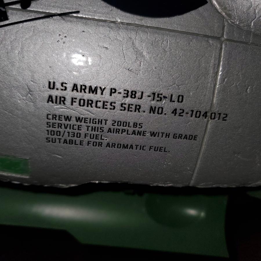

                                    The paints are all acrylic thinned with water and Flood Floetrol. Sprayed on with a Harbor Freight touchup HVLP spray gun @35 p.s.i. with a first coat of Minwax polycrylic gloss protective finish to give stock stickers and Callie grafics something to grab onto.
                                    glare shielding on nose sides and disc's for turbo-supercharger inlets are cut from excess stock sticker material. The datum markings and serial #'s were cut individually from the stock stickers. Then aligned and set with Elmer's glue.
                                    the gun barrels are painted with metal masters buffable gunmetal and burnished with a cotton swabb. The radiator openings are flat black painted not covered with window screen as some do. Personally think Alpha and his designers wanted full air flow over those esc's for a reason. The front wind screen is coated with future acrylic floor polish mixed with blue food coloring to represent the armored glass first installed on the -10 version. 3 further coats of minwax polycrylic clear gloss to seal the skin.
                                    2-3000 mAh 35c parallel connected Admiral batteries power her. She has a Spektrum AR6610T reciever with satellite. The elevator has been modified with a double-sided screwed together horn installed. The tape holding the wires in on the bottom are reinforced with gorilla tape to prevent them from pulling up again.
                                    She flies like she is on rails and is my new favorite!. Just keep the speed up in turns and use the rudder. Found that out thankfully 3 mistakes up!.
                                    question for you folks. Should I stay with the gloss finish?. Or go with a satin finish?.
                                    And bye the way if I customize my aircraft.
                                    the only grafics I will ever use are from the one and only Callie Soden @
                                    Callie-graphics.com 👍
