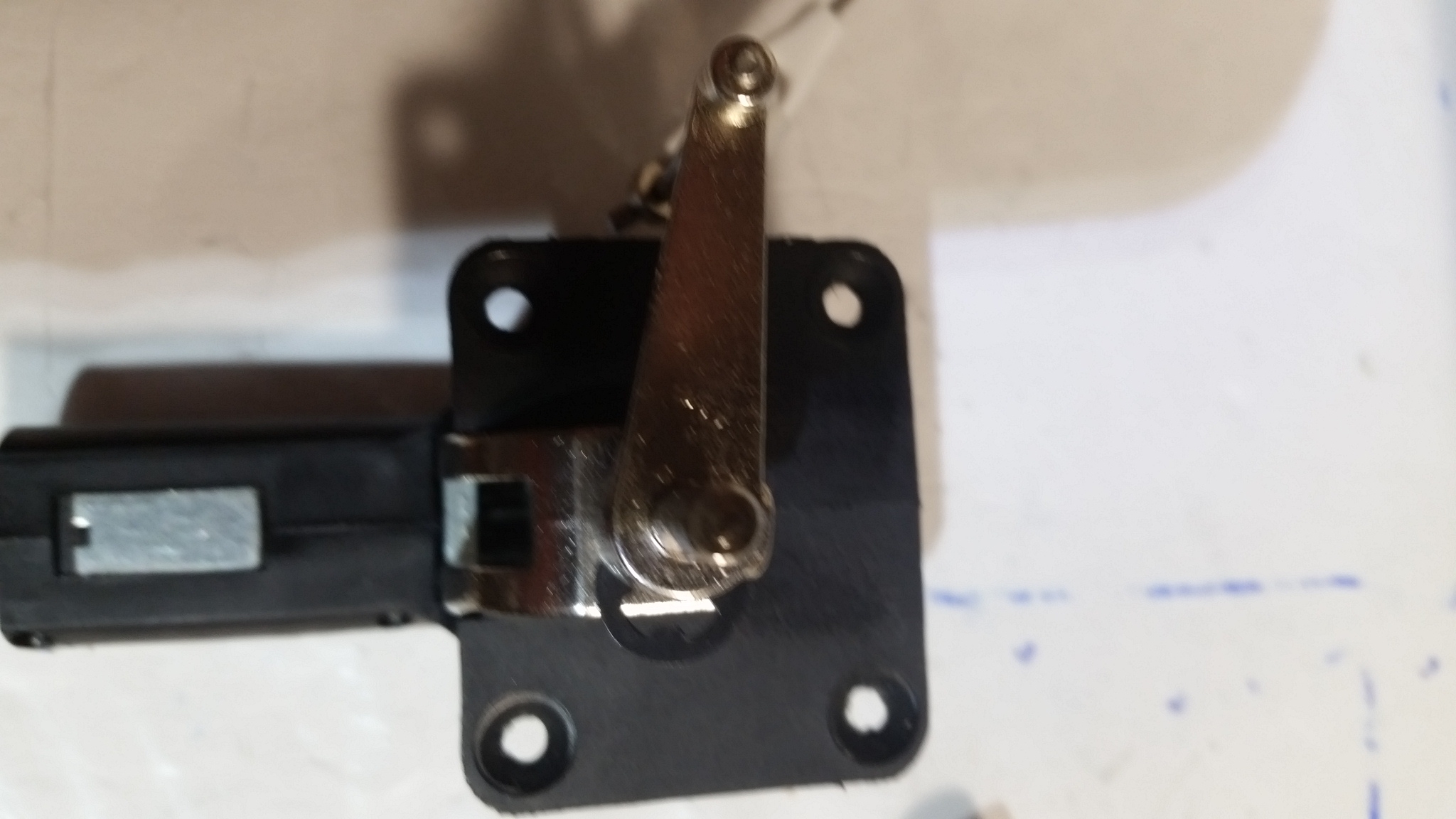

                  I just discovered something I didn't notice before with the nose gear. I was putting on the new Dubro low bounce tire and see that my nose gear assy. has more than an acceptable amount of slop. I took it out again and checked the set screws, hoping I missed the flat spot, but no, that isn't the cause as the whole assembly has this play in it as you can see in the video. I'm going to have to disassemble the whole unit again and see what's causing this. Video is here: https://www.youtube.com/watch?v=Af_M...ature=youtu.be
                  I found a solution to the slop in the strut. At least the Nose gear. I inserted a 3mm "e-clip" under the steering arm and there's no more slop. It's a bit stiff, so I put a drop of oil from my electric razor under the steering arm and into the top of the trunnion. Seems to be OK. Now I'll try this on the mains. I found an, "e-clip"package at https://www.amazon.com/gp/product/B0...?ie=UTF8&psc=1. It has 1.5mm and up.

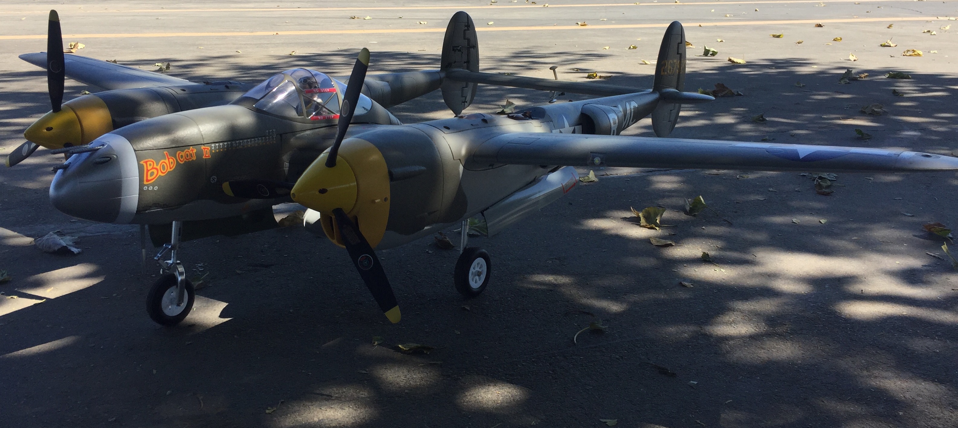

                        • T-CAT, your post in RCGroups about the struts was excellent!! :) Here's mine installed.
                          Lon
                          • Thanks Lon. Man, those struts are looking awesome! Did you just install them, or have you had a chance to try them out yet?

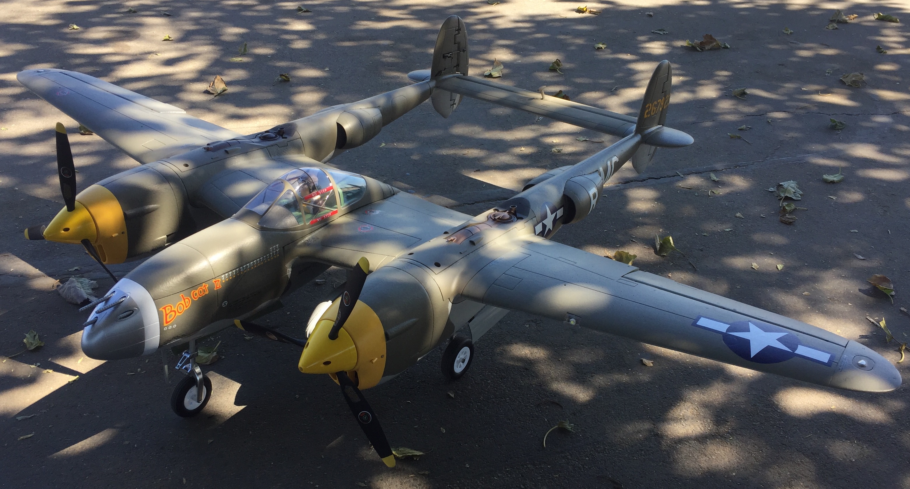

                                • I finished painting my wheels (that came with the suspension struts) silver today to get rid of the white color that stands out way too much on this plane. It is no doubt a better look, and the paint went on thick so it only took a couple coats to get full coverage. Once it dries and I get a chance to get it out into the sun, or for another flight soon, I will try to remember to take some pictures.
                                  • What an improvement, now it looks like it should and sounds like the handling is much improved, I wonder if V2 will come with those as stock?
