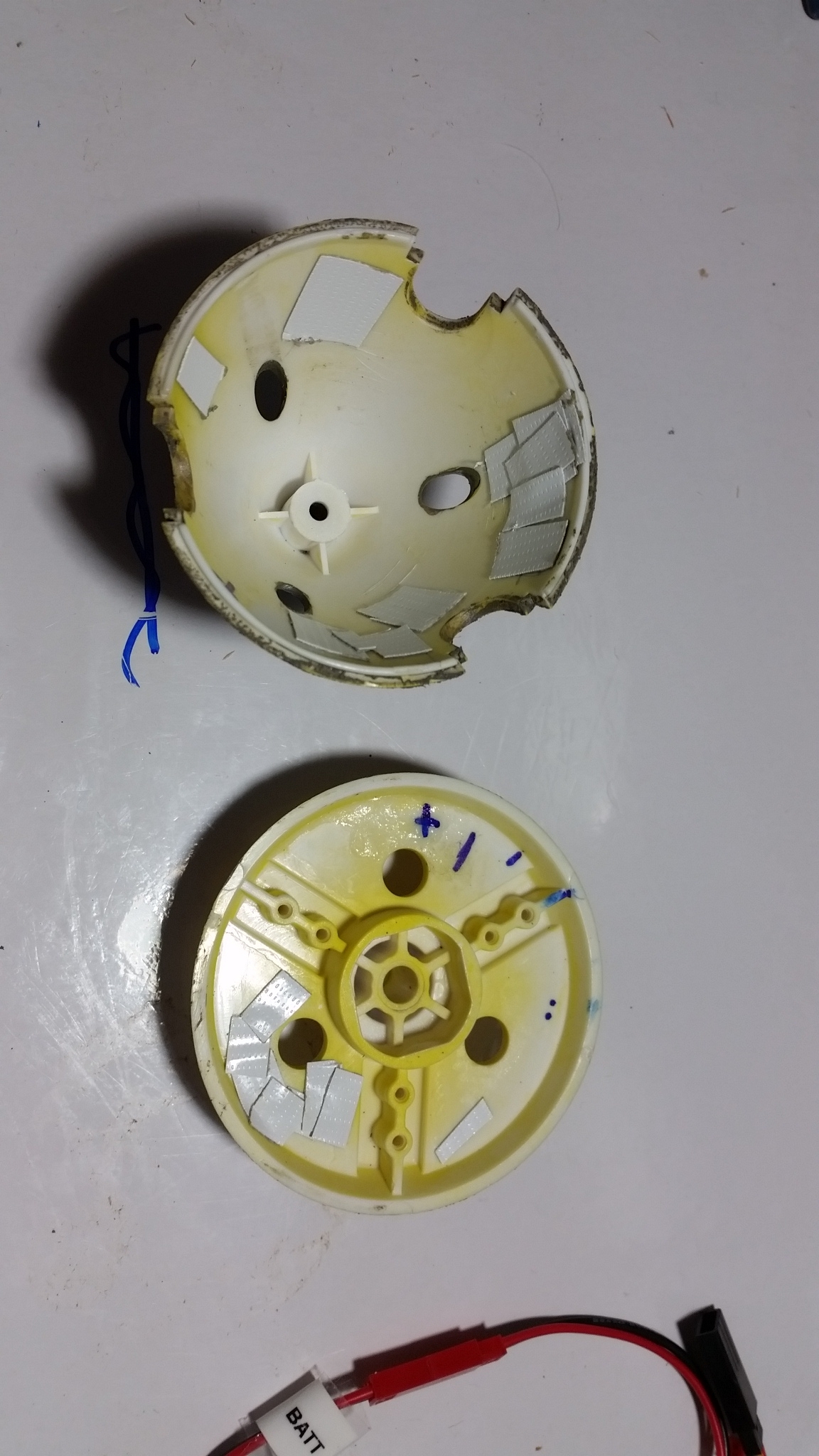

                        • Well this is frustrating!! Finally got one of the spinners and back plates to balance after about an hour but shouldn't have taken so much tape. I must be going about this bass akwards....Hmmmmm! What a mess!! Must be missing something in the "spinner/backplate balancing 101" translation! Click image for larger version

                          • Hmm. Now it's time to put the prop in it and see where the balance is. How did it come out.
                            Dewey l
                            • Originally posted by BadBob View Post
                              Well this is frustrating!! Finally got one of the spinners and back plates to balance after about an hour but shouldn't have taken so much tape. I must be going about this bass akwards....Hmmmmm! What a mess!! Must be missing something in the "spinner/backplate balancing 101" translation! [ATTACH=CONFIG]n47714[/ATTACH]
                              Yikes! Lots of tape there....If it makes you feel any better, I had one that way too. Thank goodness most all others not much. I also try to put the pieces of tape as close as possible to the outside.

                              • Time for agonizing reappraisal. I think I'll start over, but see how the props do 1st. Just to much tape. NO sir! Don't like it!

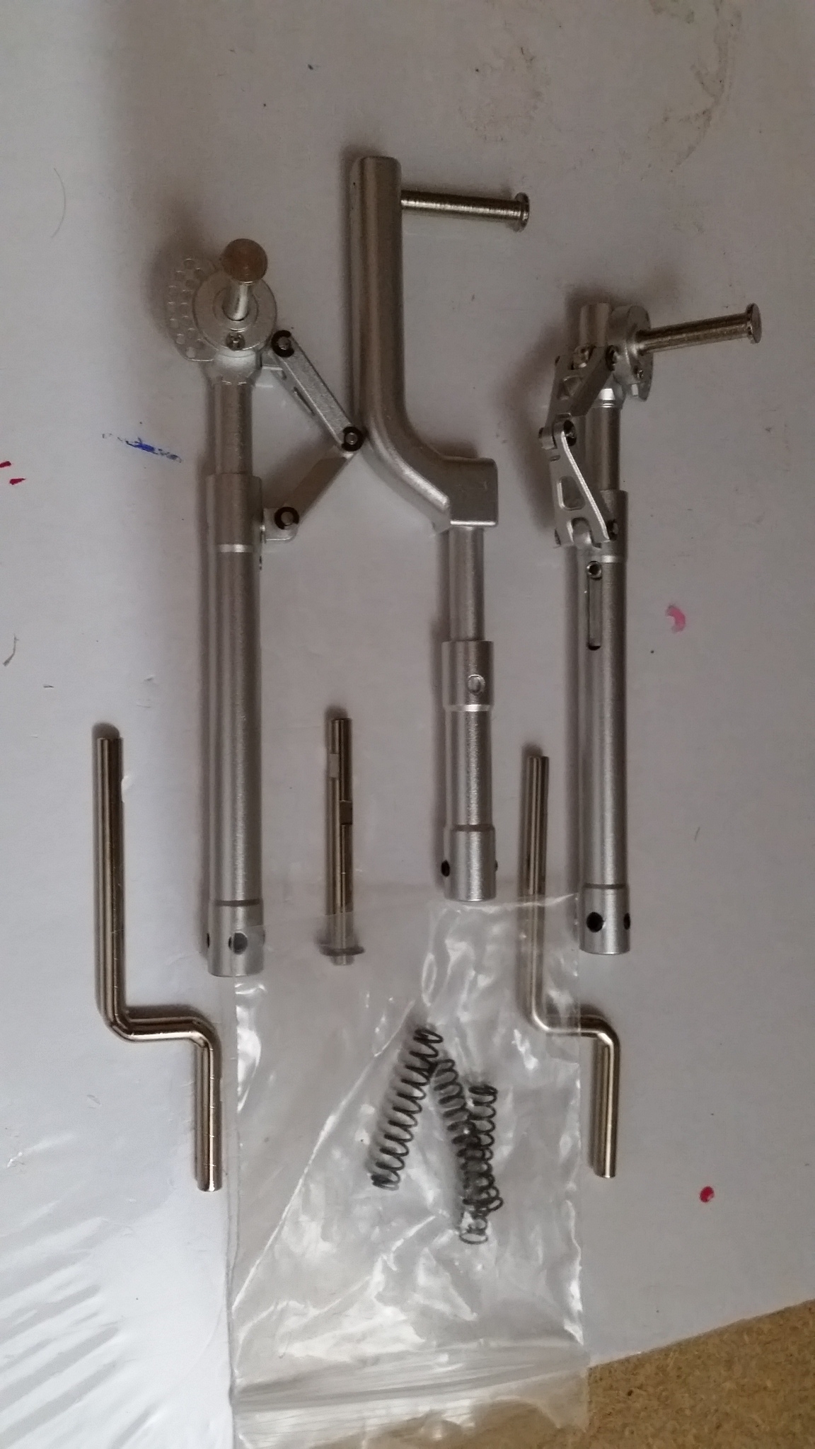

                                BTB, Got my new scissor shock struts from Castle today. No assembly instructions, so g Click image for larger version
ID:	47773 ot to assemble them myself, but OK. Hope that goes better than my spinner balance fiasco.

                                • Hmmmmm......Looks like I'm going to have to have a close look see at the stock L/G and see where all this comes into play with the springs and such. I do love a challenge!
                                      All i could figure out, was that it was a extra set of springs!?? I'm going to, but have not yet, taken out the factory installed springs , and see if they're the same. Or maybe a stronger/weaker set.

                                      • OK, I removed the tape from both the spinners and reapplied small pieces to the inside of each spinner just to get in the neighborhood. Then applied small pieces to the backplate and it seems that I now have a happy Karma on both spinners and backplates! ;) Now I attach the props and hope that by balancing them, they don't throw off the spinner/backplate balance. Shouldn't though as it it should put an overall balance "all around." Wish me luck.
                                          Bob,
                                          I balanced mine on a Dubro balancer with the prop blades attached to the back-plate. One small mod that I did do was coat the rear of the back-plate with epoxy after the blades were attached (strength). I then used small coils of solder ca'd to the inside edge of the back plate to get the assembly balanced. I didn't bother with the spinner btw. Props sound great with no vibration.
