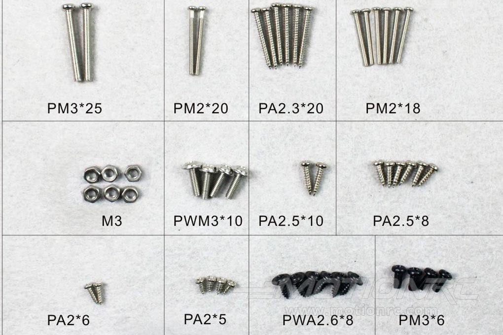

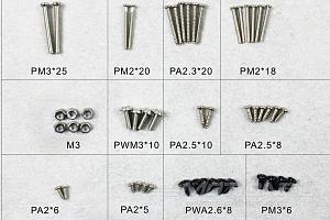

ID:	50056 For those confused about the screw designations, this from Motion:
                            The PA screws have the wood thread, the PM's use a machine thread and the PT's are are for plastic. The number is the length of the screw for all of them. Look at the chart I found as it may help but the PT does not appear on there. You have to count them out first and kinda of deduce from there what is what.
