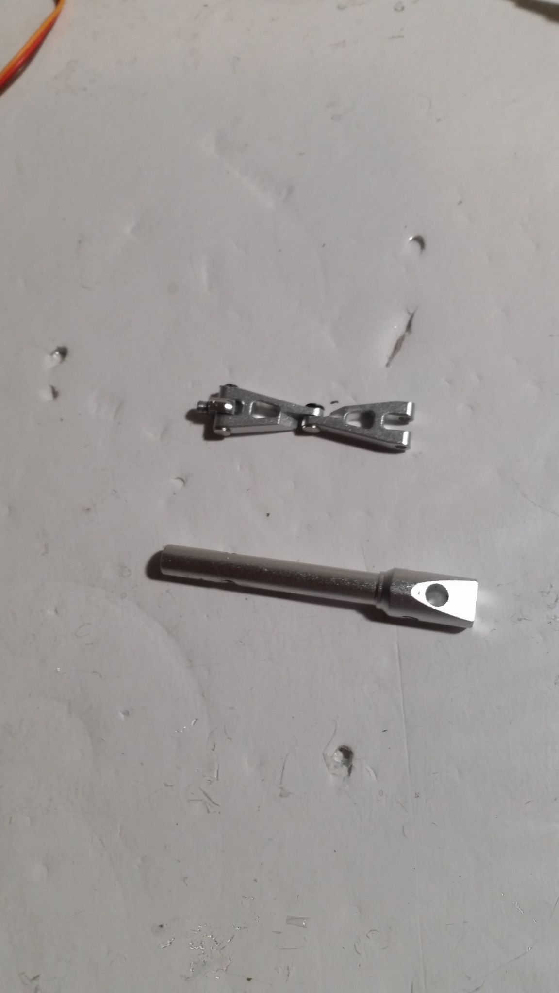

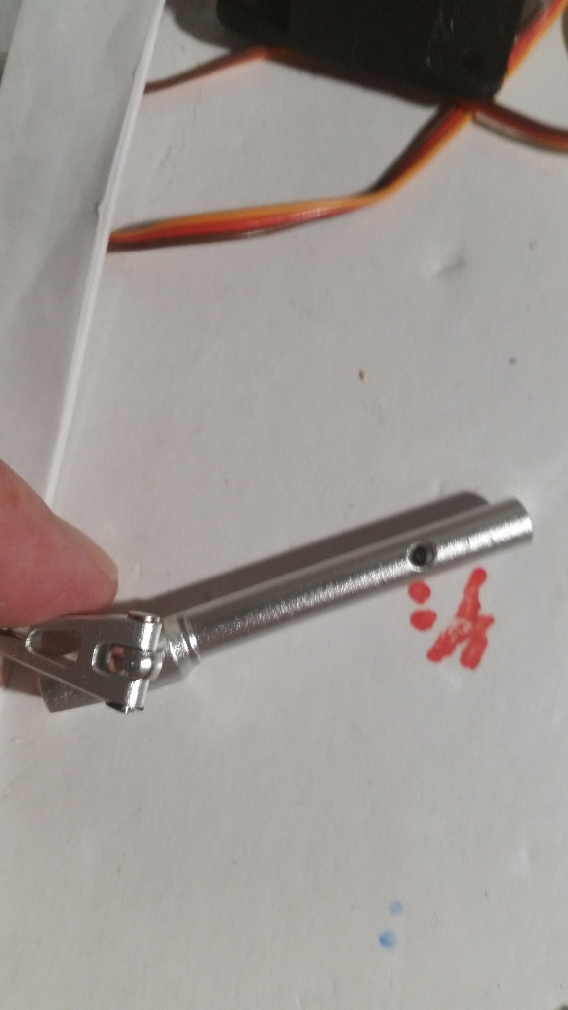

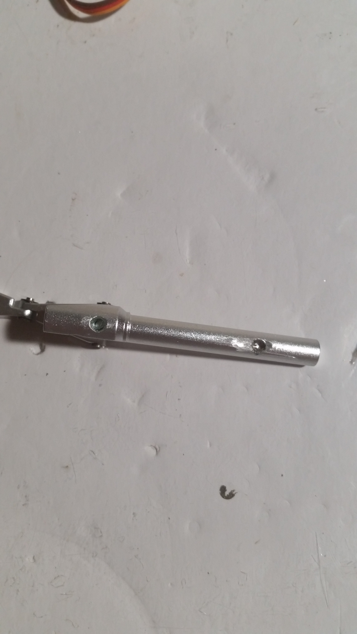

  • Update....Man do I feel like a dummy!! I was looking at the problem strut and noticed there's a threaded hole on the opposite side of the original hole that I have been trying to remove the stuck set screw from. Just unscrew the scissor gear (see pics) and move it to the other side, insert a new set screw and...viola!! You have to play with the postioning of the scissor “gear” to get it in the right position again.

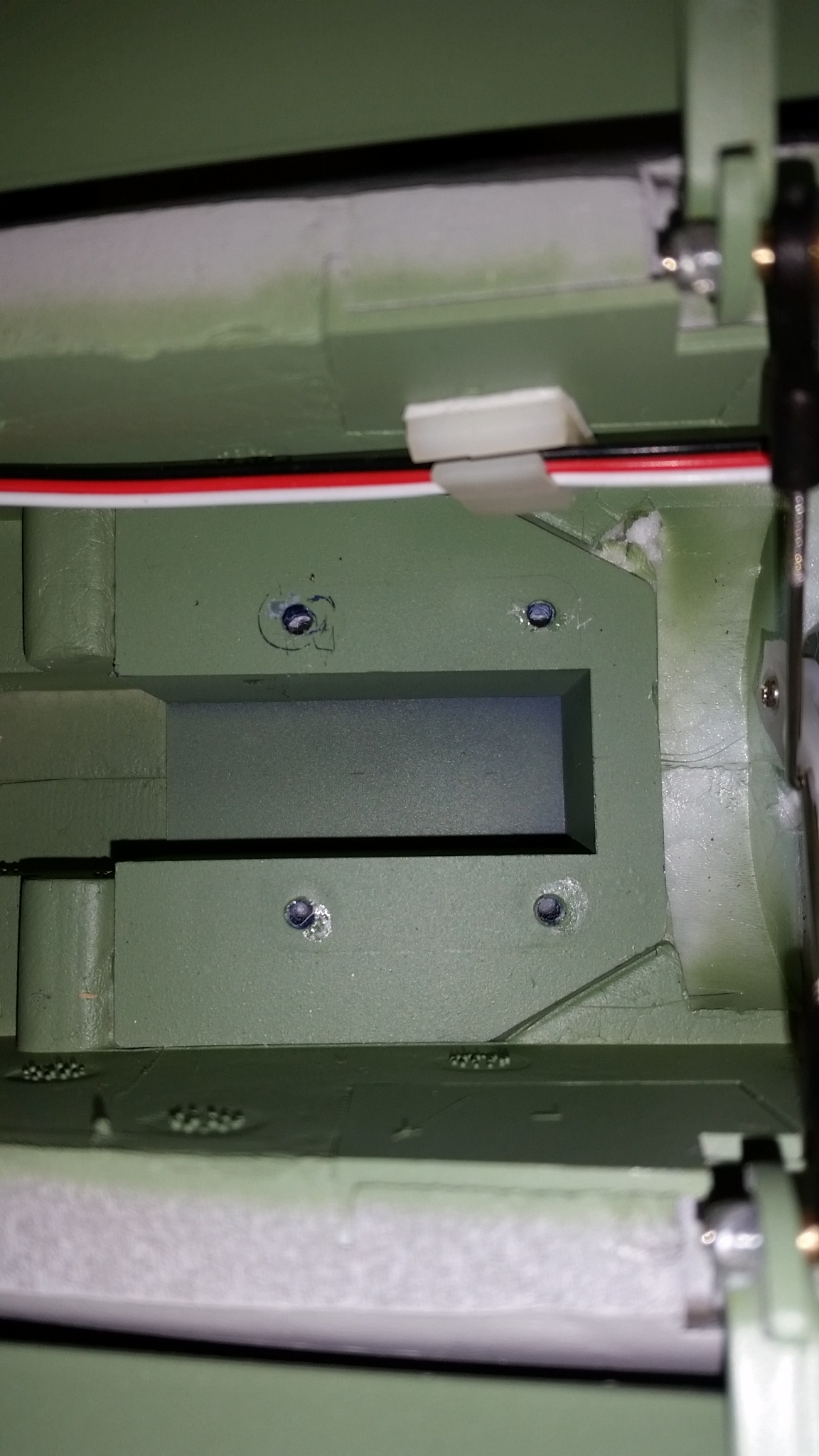

            • I just finished installing the last L/G springs into the Castle gear set and when I started screwing the mount back into the wheel well, one of the holes in the mount is stripped!!! When I took the gear out, I thought that one screw felt funny coming out...too easy!! Now I know why. I've got foam-tac and I've got foam- cure. Will one of these work to re-thread the hole in the mount by reinserting the screw? :@
              Bob Duncan
              The only real helicopter is the CH-47 Chinook. The rest are just sling loads!
              • Both of those are too soft. I would suggest using with a thick CA glue or an epoxy to fill to hole. Then, drill a small pilot hole and retire ad the hole.
                • Originally posted by F106DeltaDart View Post
                  Thanks.F106. I'll try the epoxy with microballoon filler mix. Anyway, I took a measure with my digital caliper and it tells me that the bad hole is 2.84mm and the other holes are all 1.29mm, top left hole. This out of the box. This plane is starting to show an accumulation of issues in quality control Click image for larger version

                  Update.. Filled the hole with epoxy mixed with microballoon filler and all is well.

                  • Brad at MotionRC tells me "That can be a very common issue, very sorry; as we obtain these from our Partners in China. Yes, CA glue, or a good Hot Glue, will re-thread the hole just fine."
                    So for those that haven't switched out the stock L/G, I suggest you all check your L/G mount screws (and all other security hardware). Again, I had one that wasn't even threaded. Even the hole was too large. Epoxy mixed with microballoons, if you wish, worked great.
