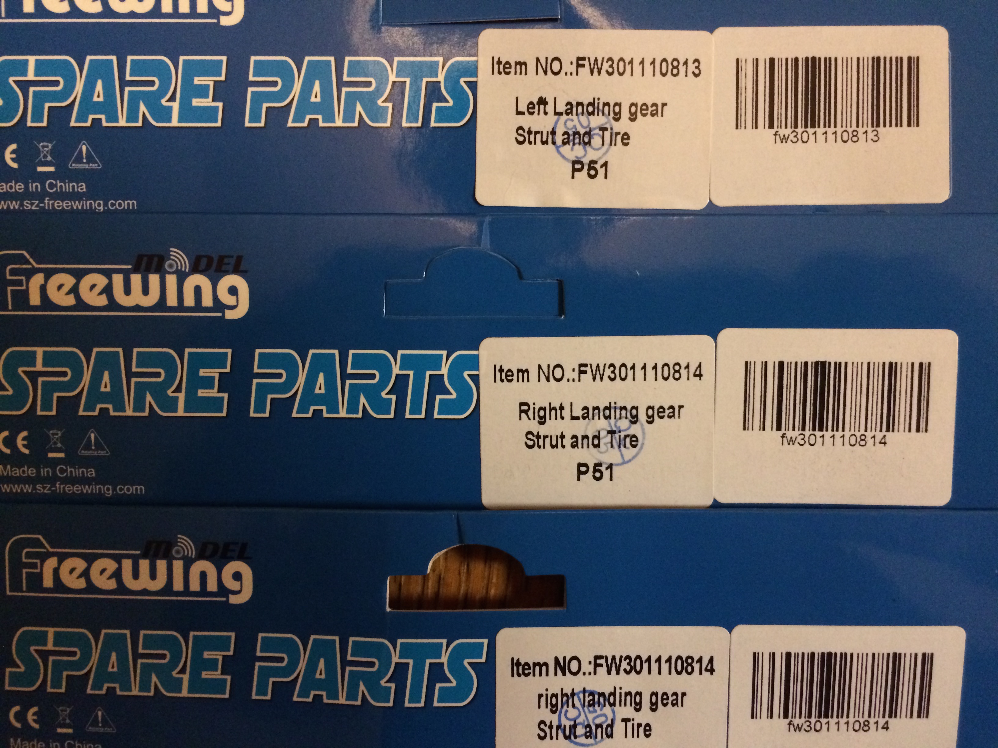

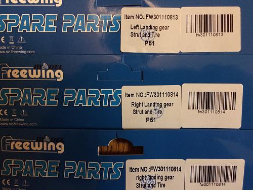

                      • I ordered two rights and a left thinking right was sitting in the plane right...but apparently it's looking at the plane so now I'm short one strut on my P-51.
                          So TI am I right???? Two rights and a left. Looking at the plane from the front, the nose gear is the same as the right main.........correct??
                          • No, if you order from the parts page get two lefts and a right.
                                    TI respectfully...............I just looked at the parts page for the Freewing P51 Old Crow and in order to duplicate what you have, I would have to buy two rights and a left. That would make all the knuckles or whatever you call them, face forward.

                                      • This is what I ordered and it was wrong...I had to use the left off my P-51 and order another left yoke end. Click image for larger version
