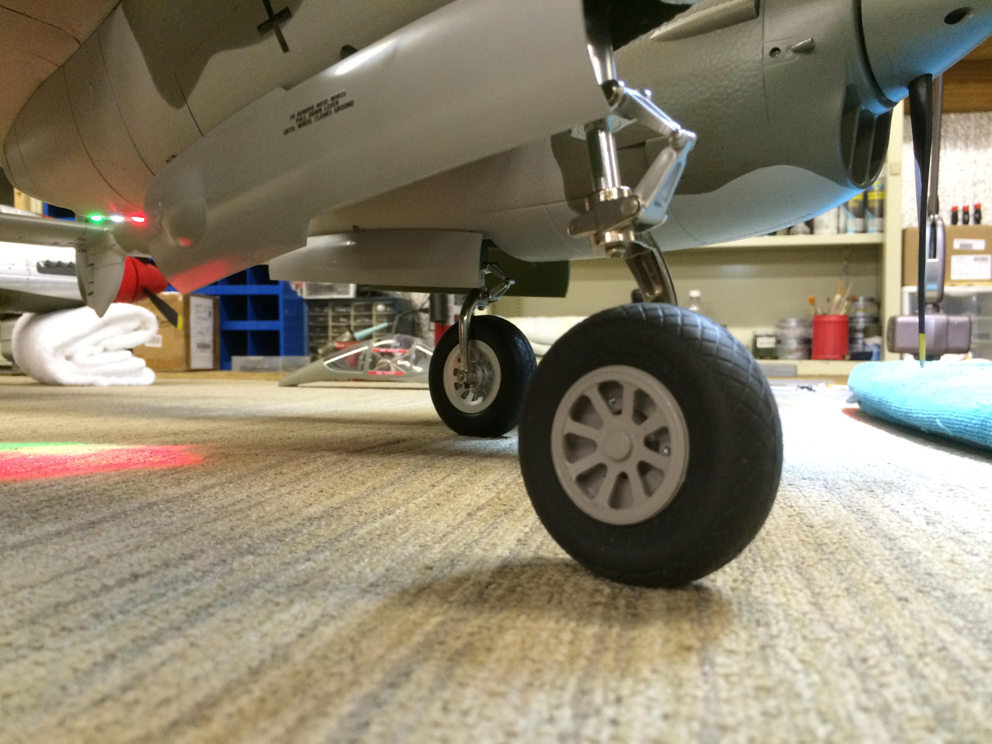

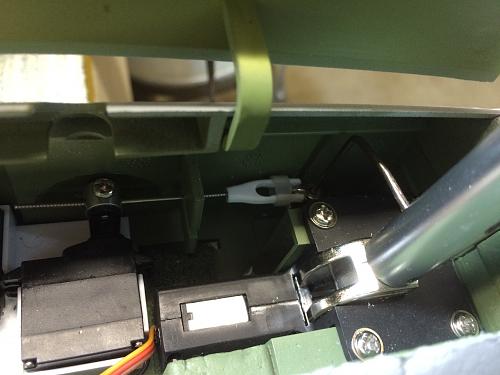

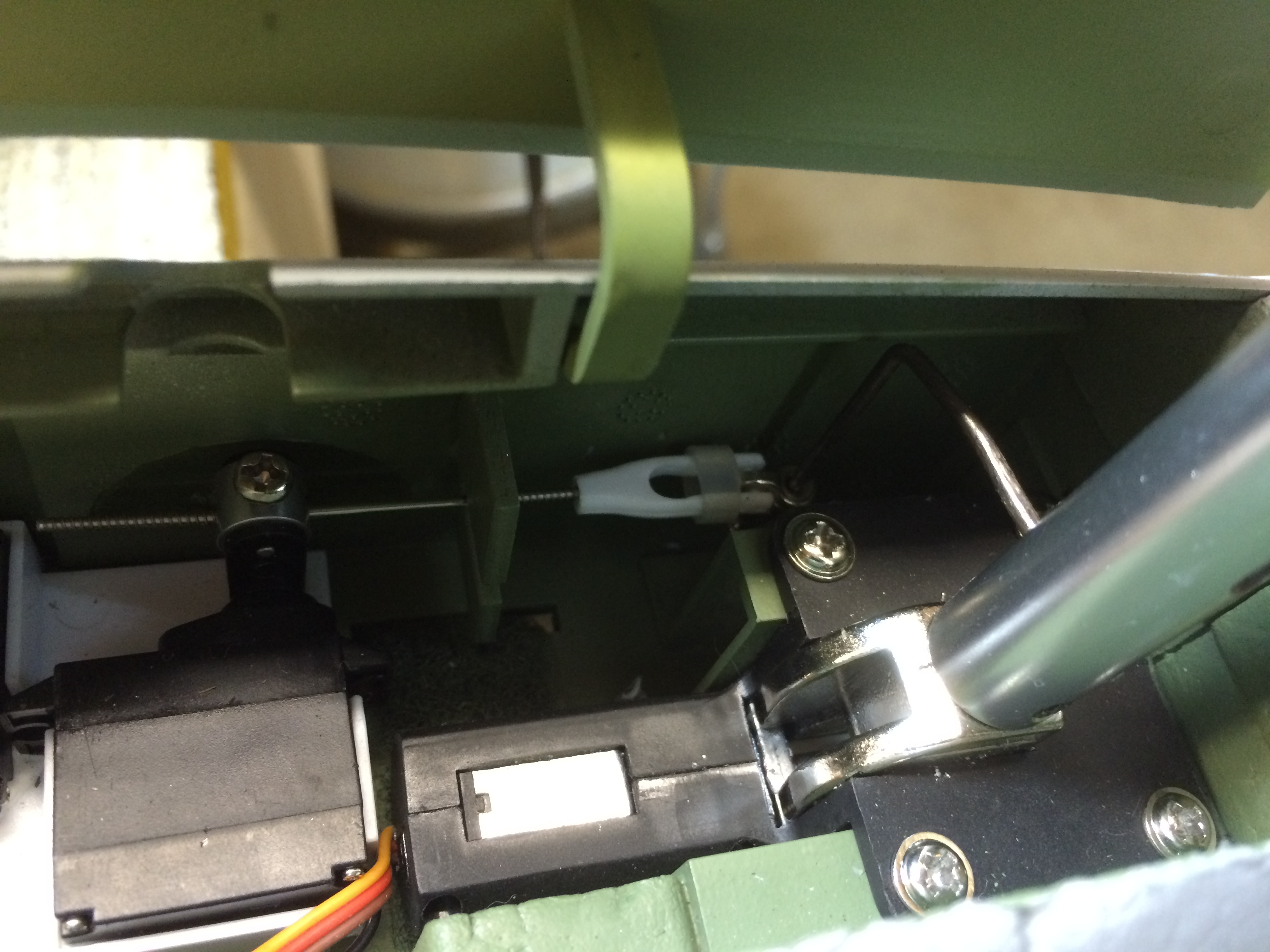

        • Finished adding the FreeWing P51 struts, it was a job.
          The nose gear is a little stiff so I will cut a couple coils off the spring inside the strut, the main will need the spring stretched as they are about a quarter of the way compressed from the weight of the plane.

          • Tired Iron wins the award for Most Realistic Struts. Well done.

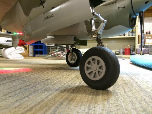

                    [ATTACH=CONFIG]n36506[/ATTACH]
                    [ATTACH=CONFIG]n36507[/ATTACH]

                    Is it easy to get to the springs for the adjustments? Will stretching do or maybe a small piece of tubing to take up the excess compression. I'm doing the same mod so would appreciate a walk-through on the mod.

                      Don't stretch the spring, they'll just sag again after a couple of landings. Instead, add a spacer. I had the same issue with my PR bushwheels 1/4 scale cub shock struts. Adding a small spacer solved the problem.

                                • Tired Iron,
                                  What wheel are you using for your nose gear ? Looks good!
